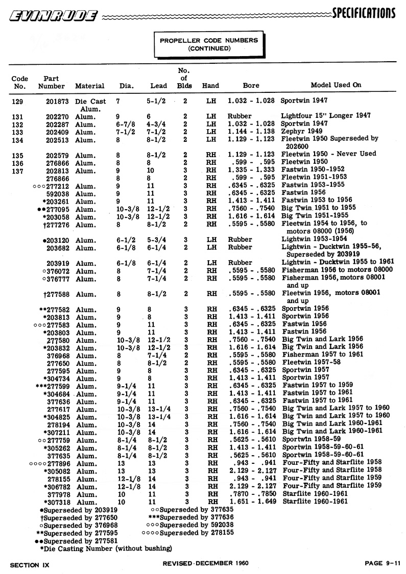

        #13157
          Not in our club’s propeller database –
