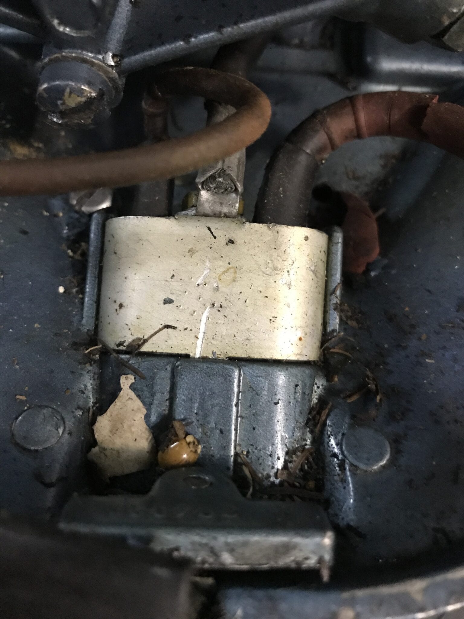

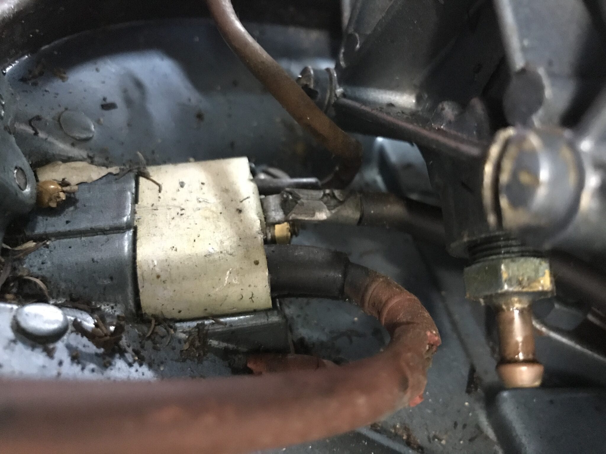

      My father gave us a 1957 Evinrude 18hp Electric Starting model #15922 for our new 1955 Aristocraft Torpedo. It needs some work. We are having difficulty in identifying the white item with the electrical wiring–perhaps the power cord for the starter–but the photo does not align with the manual photos. Although those around it seem to have part numbers, this one does not.
      Any help you could provide in identifying the part number would be great.

        I believe you are looking at the motorside cable plug, item 49, part number 376871. It is held down by item 43, clamp, part number 304787.
