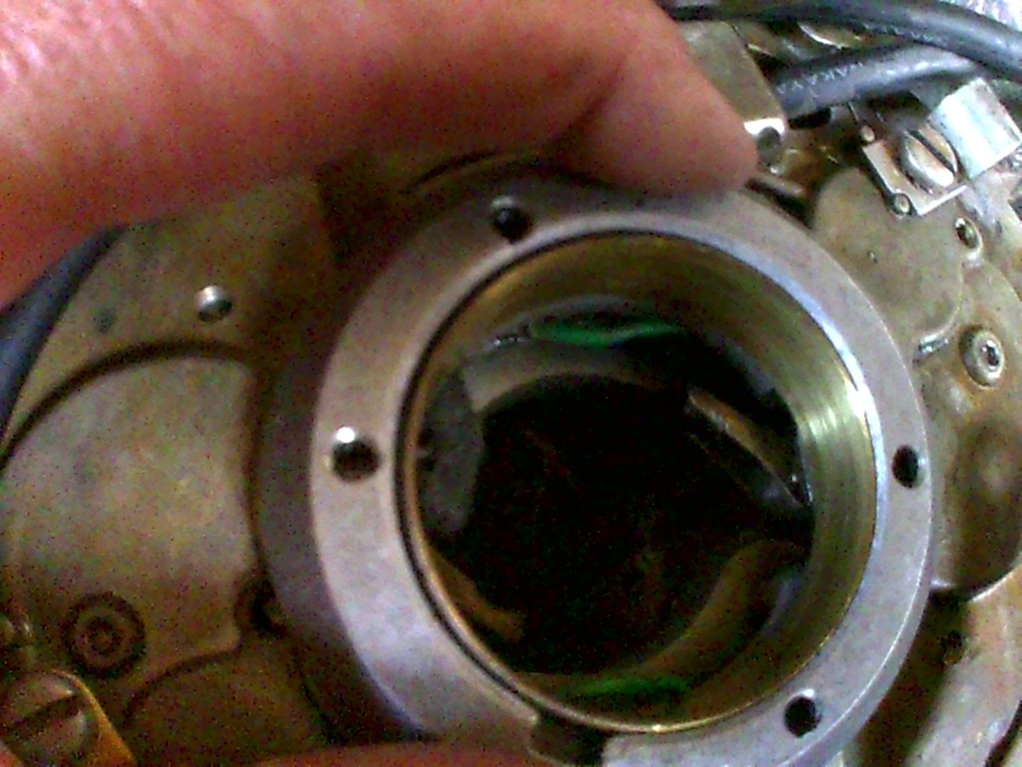

                      ok i got back on the motor…so i took it all apart cleaned up all the oil there was a bit packed up under the mag plate hold down the big one…put back together and now it run even worse than it did now the bottom has no spark at idle…but i took it apart again getting really good at it only takes me 5 min to tear aprt lol…and in pic you can see the bushing does have a small gap could this be my whole problem..i’m thinking of puting some really small thin pieces of copper in between it to make it a lil tighter do you think it will work or ruin it more…other than the litlle gap ii’m loss of words why it wont work and just about ready to throw it out…
                      #176573
                      cookjer24
                        pic of the mag plate hold down around the bushing..i pushed the hold down to the left to make it flush on the right to show the lil bit of gap in the bushing.
