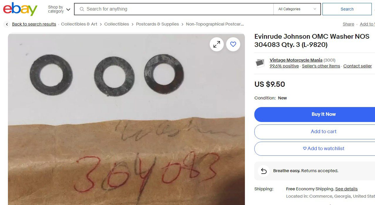

      Re-sealing a 1960 18h.p. gear case. It appears that swivel pin seal #304083 is N.L.A. Does anyone know of a replacement? Thanx in advance.
      #289201
      Steve D
        Someone on eBay has 3 for $9.50 free shipping.
        https://shorturl.at/ziYbR

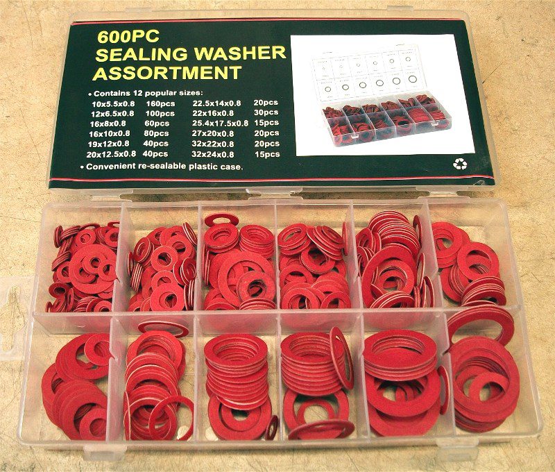

        I’ve also found suitable replacement in a kit like this:
        https://shorturl.at/5tD3Q
        Also Amazon and Harbor Freight, but this one on eBay I think is the cheapest.
        I always use a little 3M 847 or similar sealant on that washer.
        304083
        kit

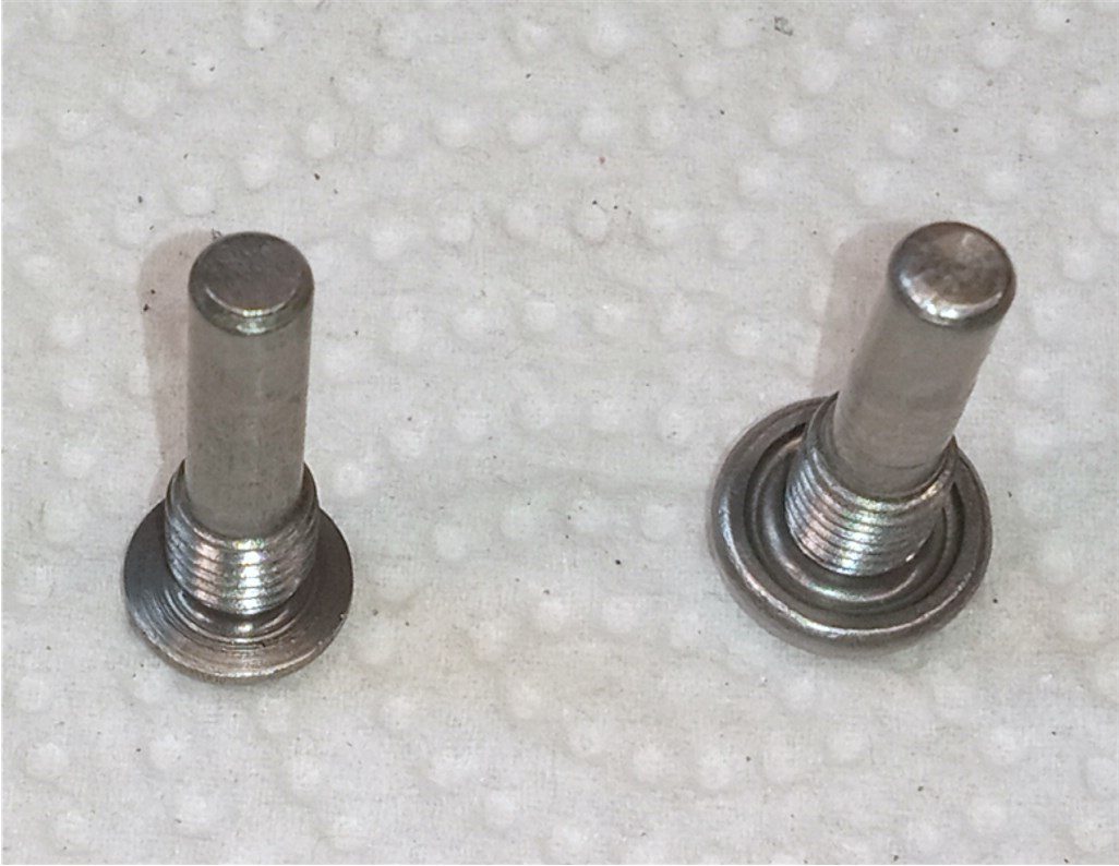

            Steve D
              “use  307853 or Sierra 18-1034 18-7120”
              Those numbers are for o-rings. Around ’64 they changed the pivot pin to have a recess under the head to accept an o-ring. The pin before that just used the flat fiber washer.
              pivot-pins
