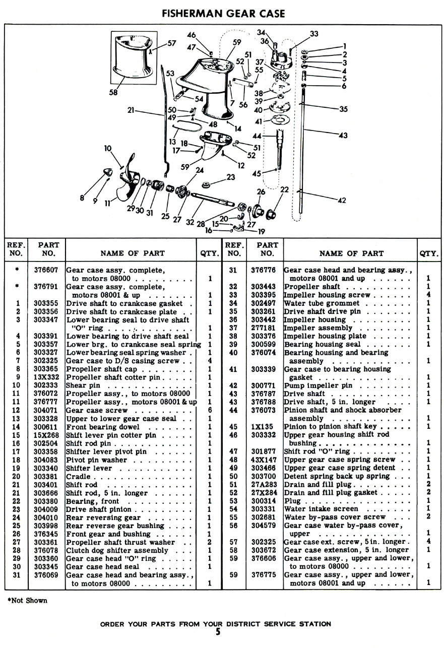

            #172728
              The Gale parts manual I have skipped that – poor editing ! – Crosbyman showed my seal sketch for the Evinrude Fleetwin, here is the page I took it from;
              This is for the 5 horse Fisherman.

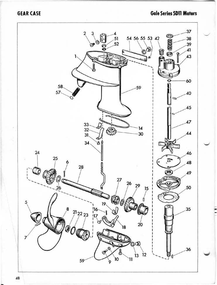

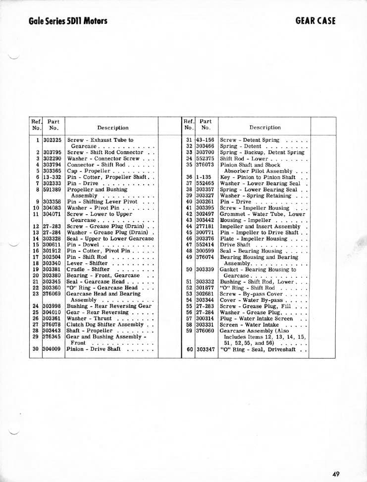

              #172734
                Here are the 5D11 gearcase parts pages. Keep in mind there is a big difference between the 5D11 and the 5.5/7.5 powerheads and seals.
                Pg-48-Gearcase
                Pg-49-Gearcase-Nomenclature

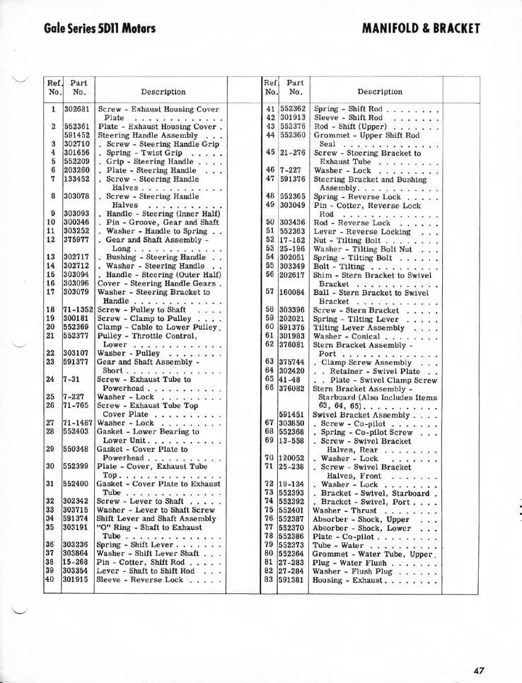

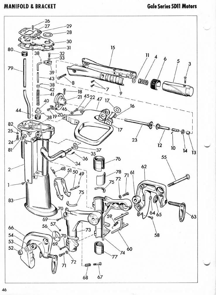

                #172737
                  Here are the 5D11 Manifold and bracket pages.
                  Pg-46-Manifold-and-Bracket
                  Pg-47-Manifold-and-Bracket-Nomenclature
