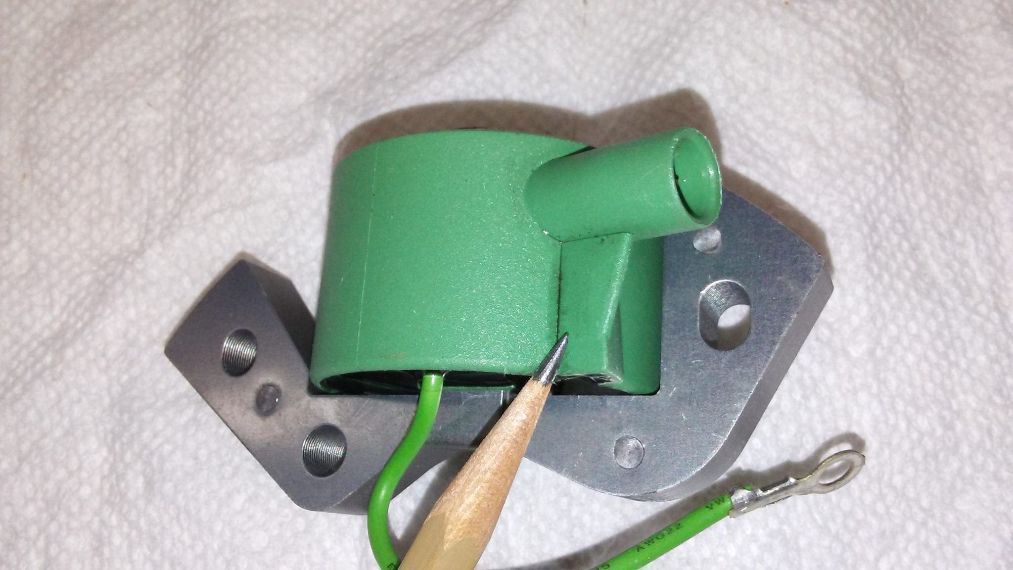

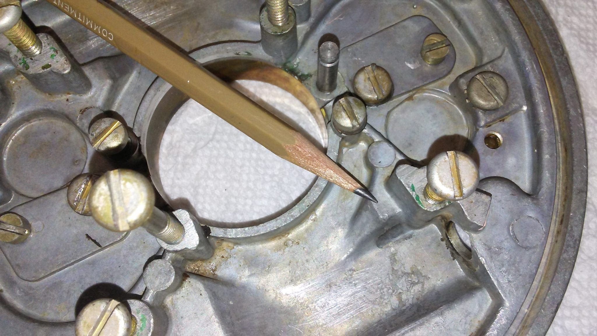

          Yes, that’s what I see too. But…there is always a but…..I have the coils and the ones I have do not fit. There is an extra “brace” on the coil body that supports the spark plug wire port. This brace – on my coils – interferes with a land cast into the armature plate thus not allowing the coils to sit flat on the mounting plates. The attached photos show the interference areas (pencil pointing to them). Maybe the coils manufacturer changed how the coils are made????

            Take a dremel and shape the coil to fit the mag plate.

                The original Lawn Boy and OMC coils were interchangeable, but it appears you are dealing with modern aftermarket coils.

                      drifter
                        The gentleman I bought them from has graciously offered to take them back. I could grind off the land (which is filled with potting “epoxy”?) but I feel that modifying these parts is just not the way I want to rebuild a magneto.
