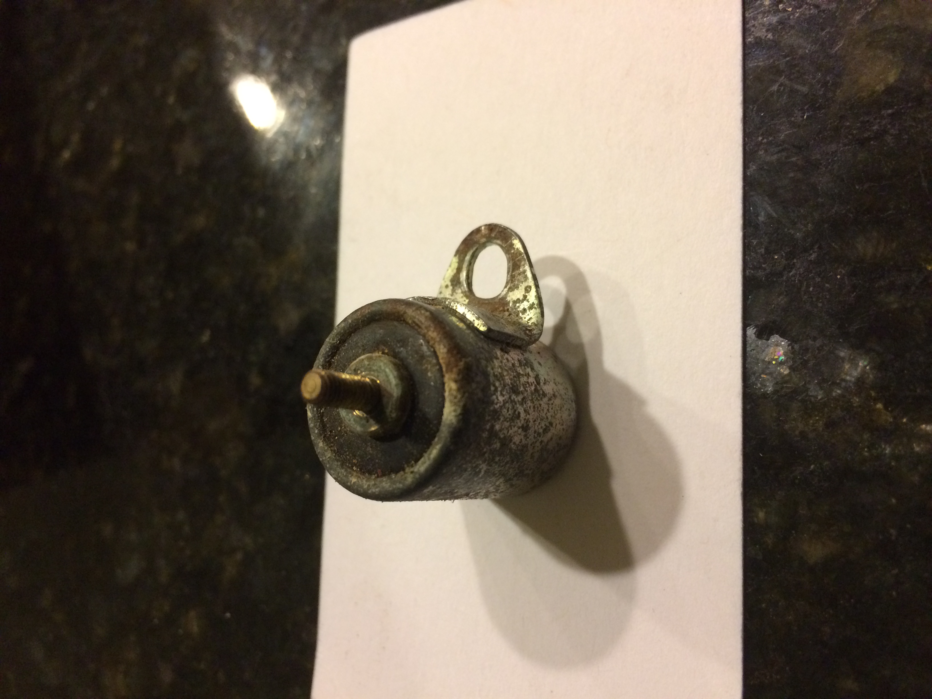

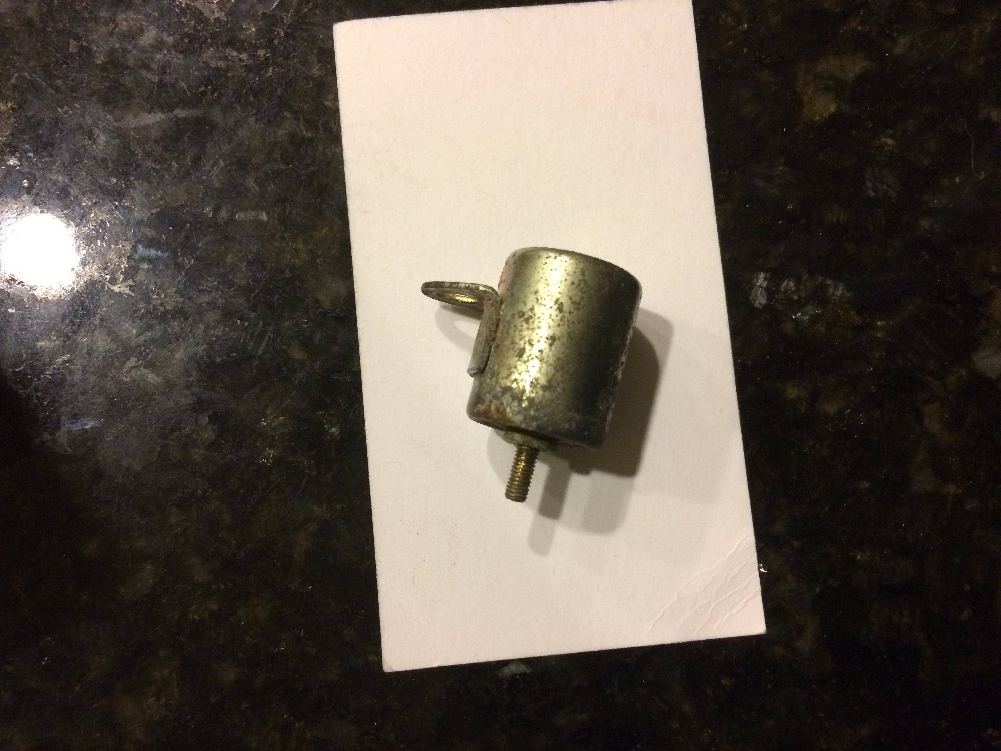

        john8504
          No spark in this little "bug", anyone recognize this particular condensor? No names or info on it.

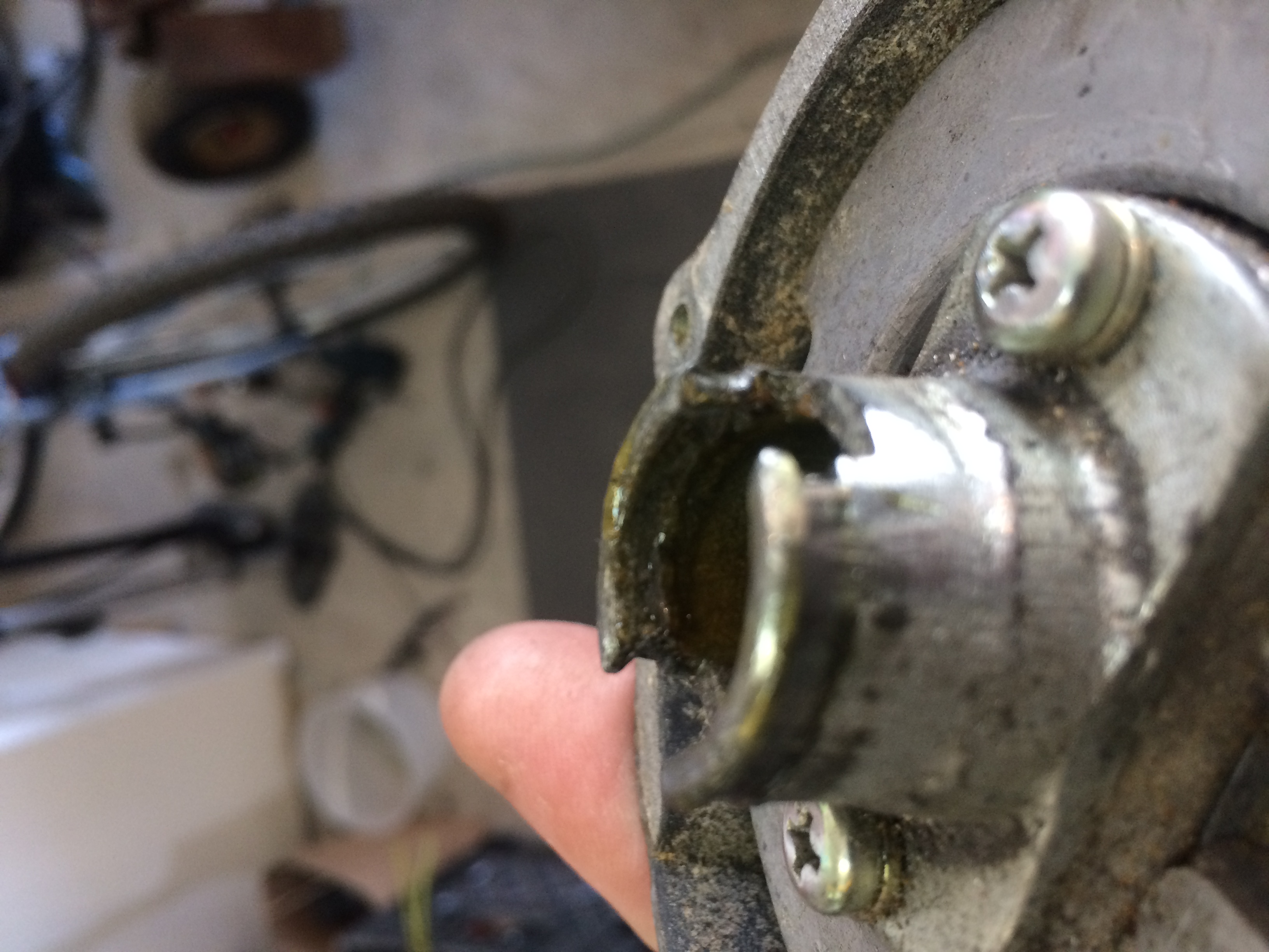

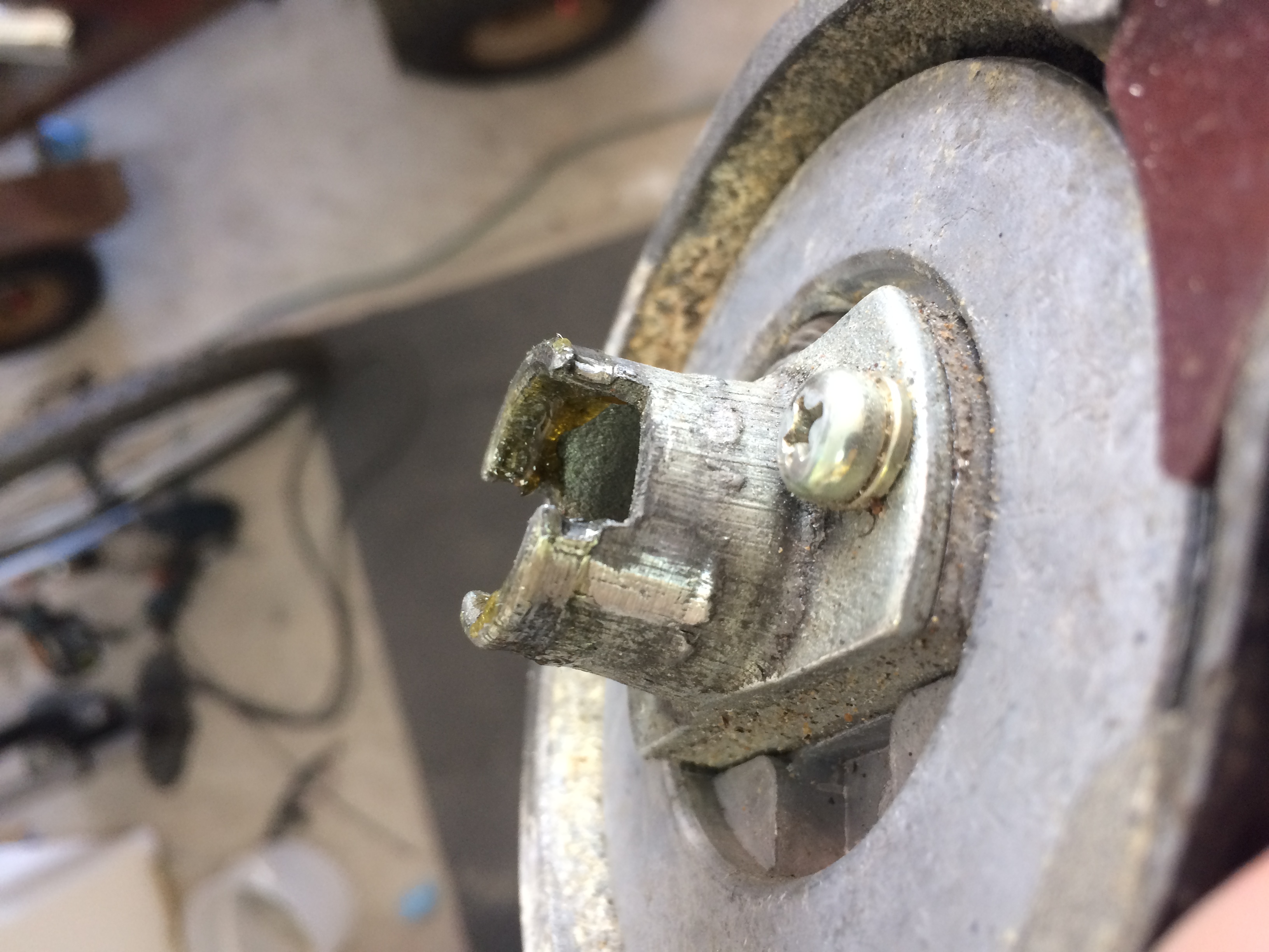

          john8504
            So I got it to run for a few seconds today and then it died. I tried to restart and the recoil mechanism not allowing it to turn. I take it off and motor spins free. I don’t know if the teeth are supposed to look like this or I need to filed them flat.
