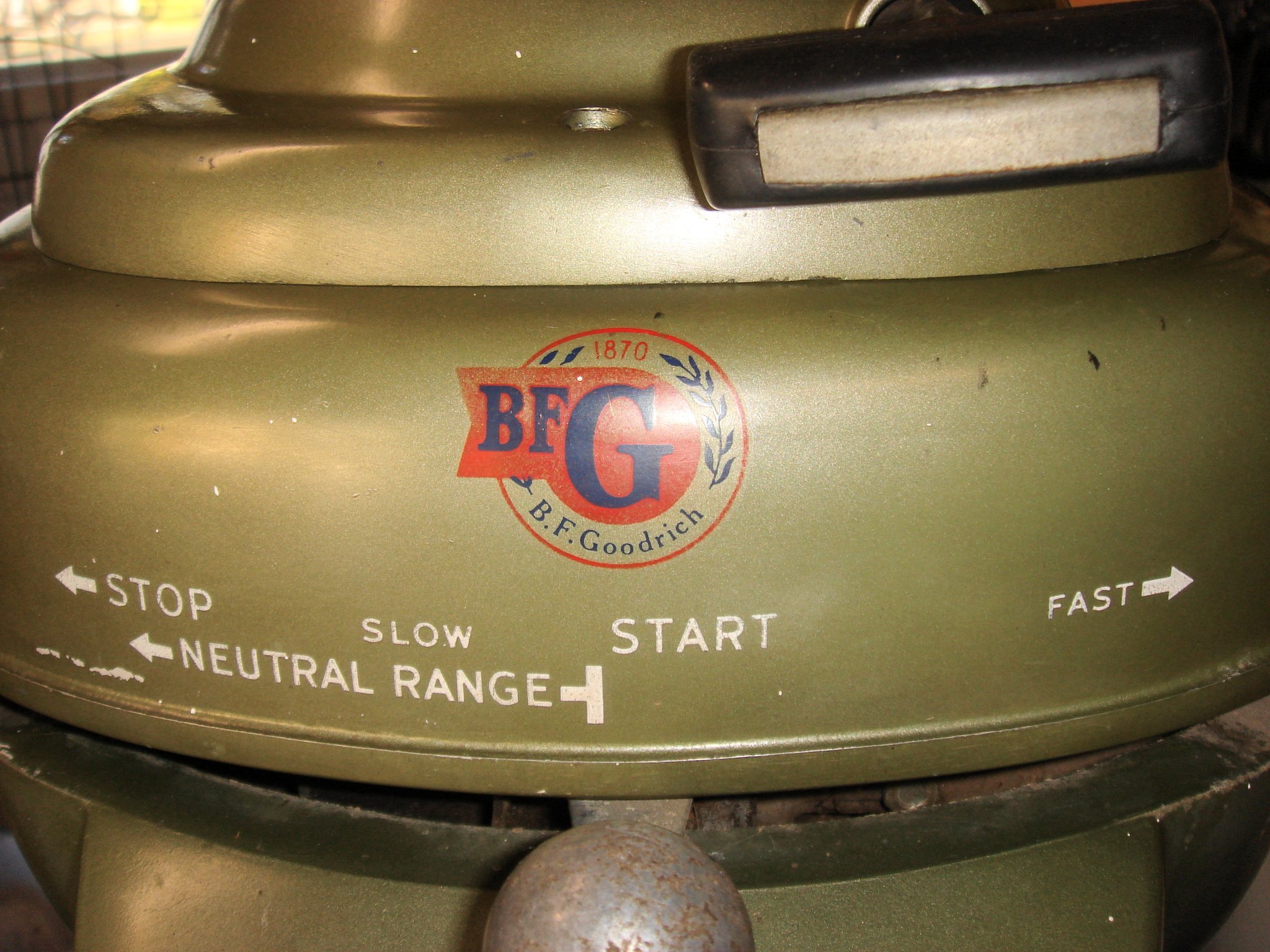

      Is this a model # ? If so what year and hp is it. Thanks for any help S/N is 376687.
      #79692
      jiall2

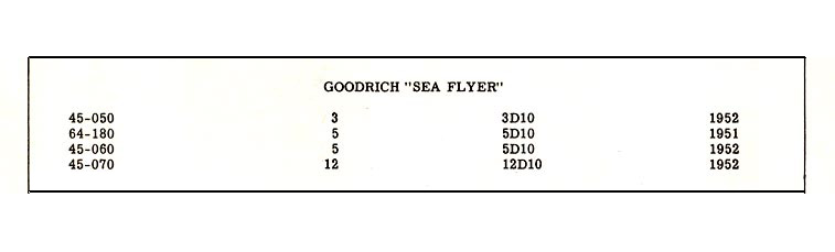

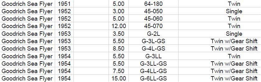

        64-180

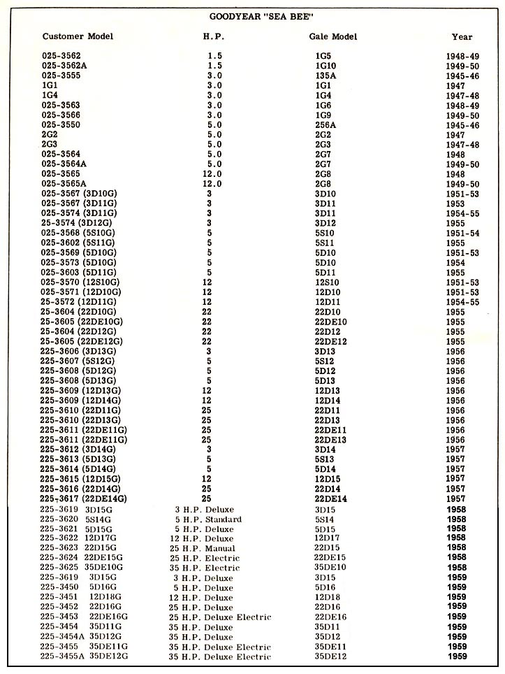

          Nope, assuming it is a Gale Sea Bee.
          #79694
            Oops, wrong tire company

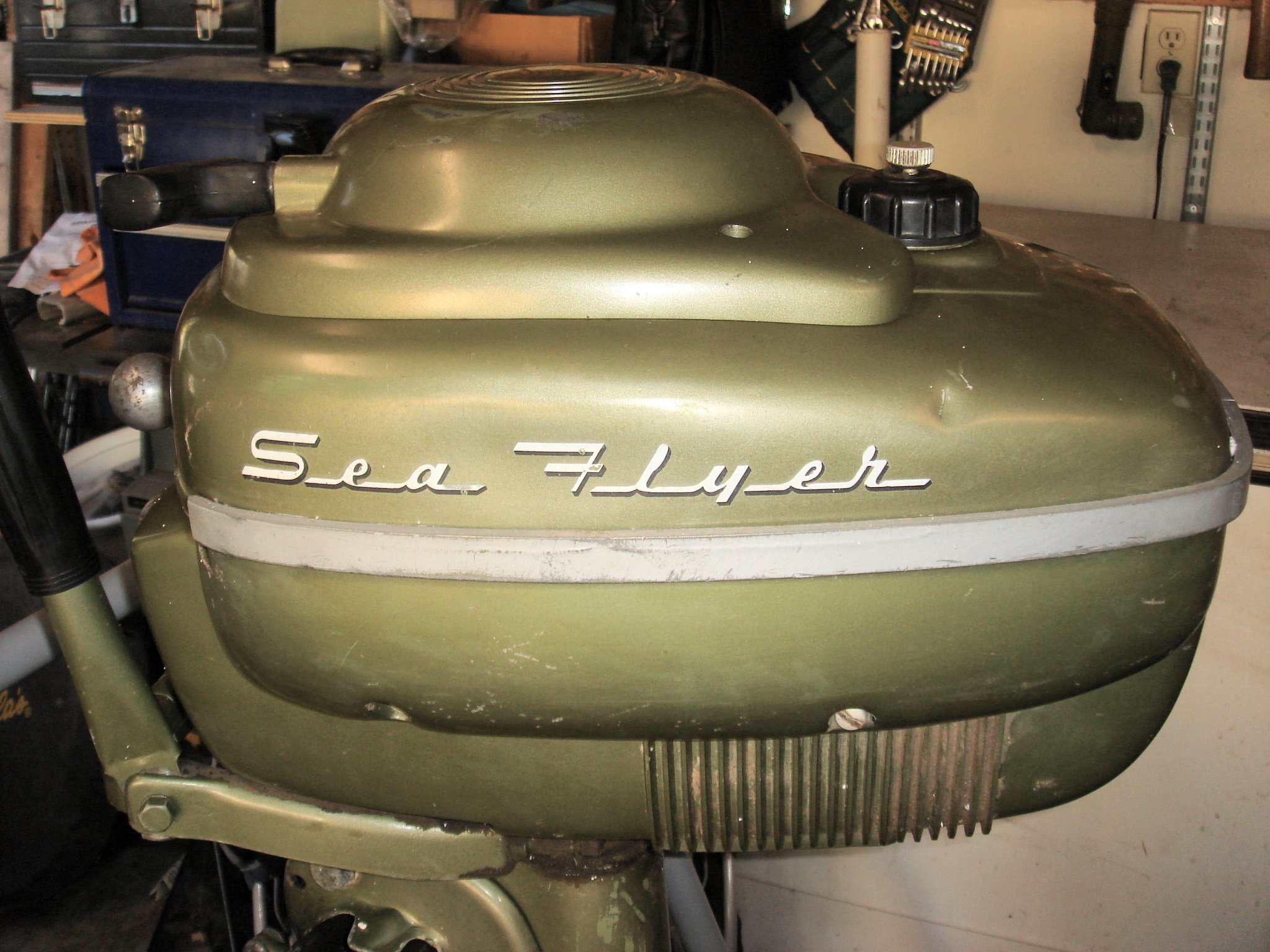

              You don’t see many Goodrich Sea Flyers, only made two years.
              #79696
                Don’t know whose pictures these are, I sucked them off the ‘net years ago.

                      Another BFG list.
                      #79703
                        I believe the "G" models were made by Champion.
