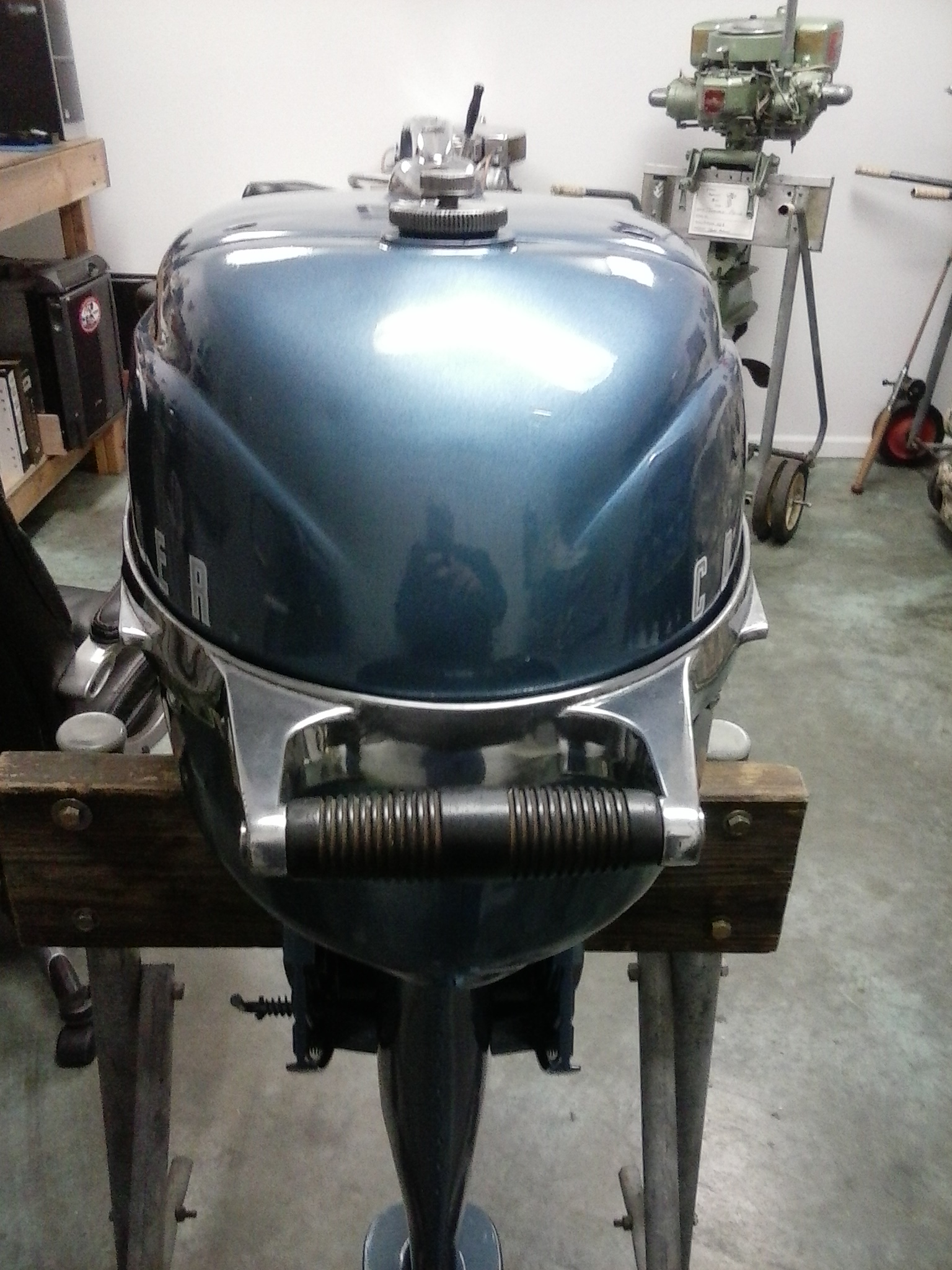

              #50340
              jerry-ahrens
                I used 2 part Marine Tex to fill the dents in this Commander tank. It had three good ones in the back. Rough up the metal and use an old credit card to smooth. Sand and prime/paint. I buy the Marine Tex in the larger industrial size can. Works for all kinds of stuff.
