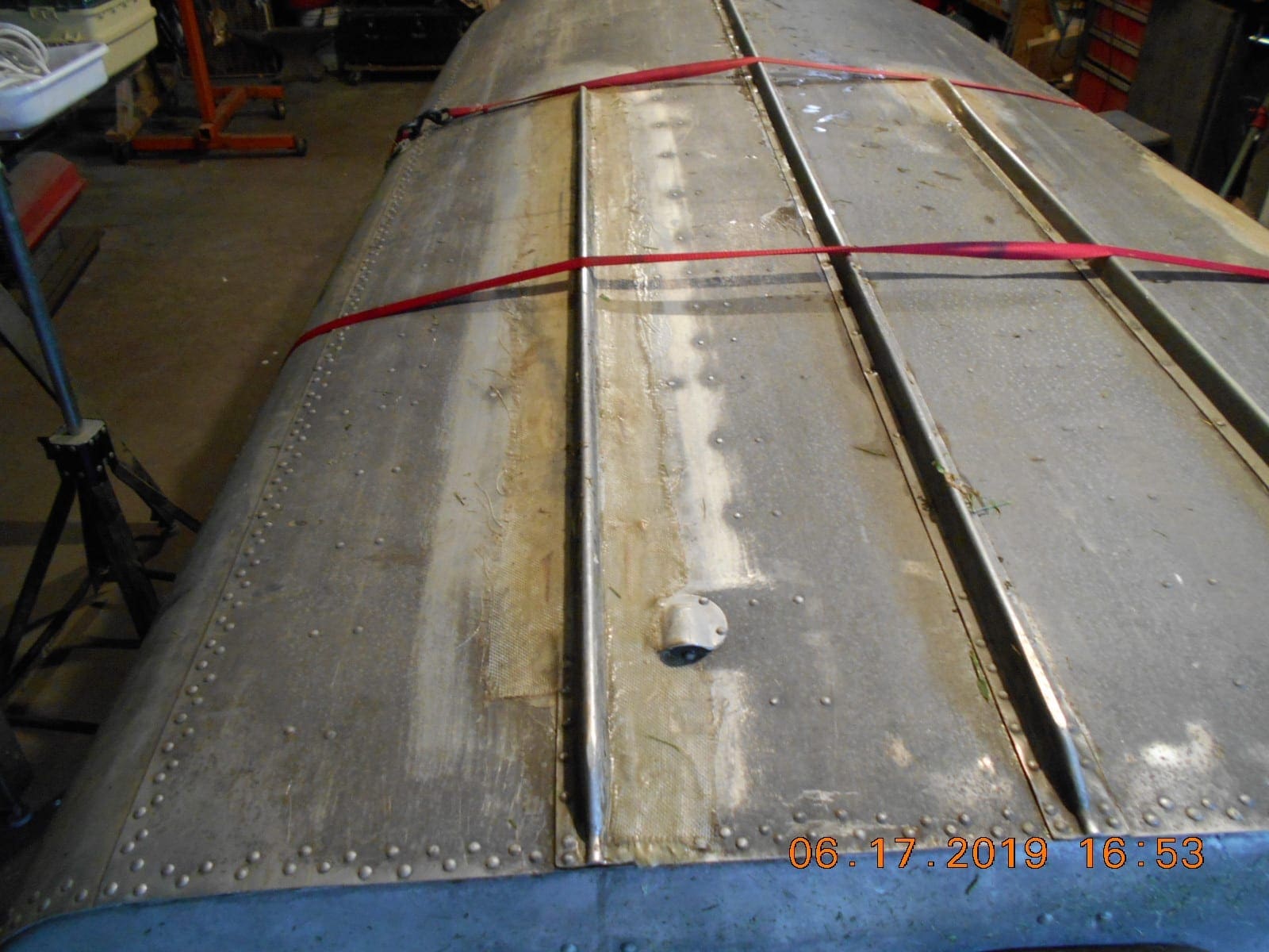

      I got my Cadillac boat upside down and in the garage today (with a little help).
      I have Gluvit sealer coming soon. What’s the best way to remove the old
      fiberglass patches without harming the rivets? Torch and putty knife?
      I’ve put fiberglass on stuff over the years, but never tried removing it from a boat.
      Thanks for ideas, great ideas even better, lol.
      P.S.-Also, I have the two “distressed, crack areas as seen inside the boat.
      Toying with the idea of riveting patches over the two spots (with sealer
      between. Where does on get aluminum sheet the correct thickness?
      DSCN7871
      DSCN7872
      DSCN7857-1

          It kinda looks like epoxy so I think your on the right track with the heat . Maybe try a heat gun to loosen it up . I don’t think the heat will work if it’s poly resin .
          I may be wrong though …

            Regarding the fiberglass, it looks like good old fashion stuff you buy in a can and mix hardener with,
            and brush over the cloth…… not sure what that is though.
