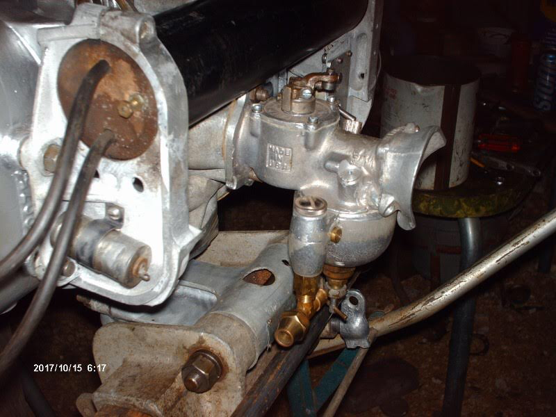

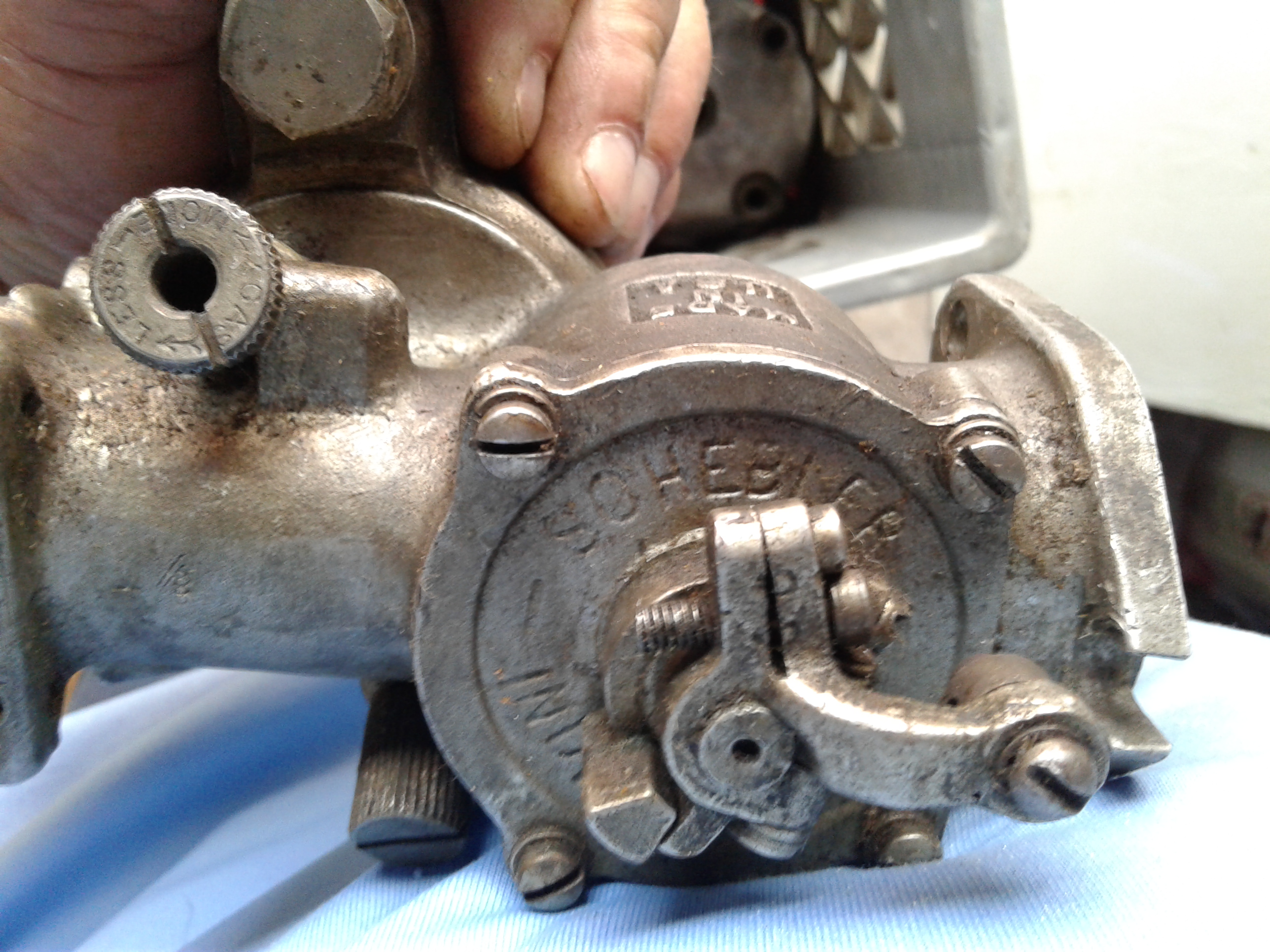

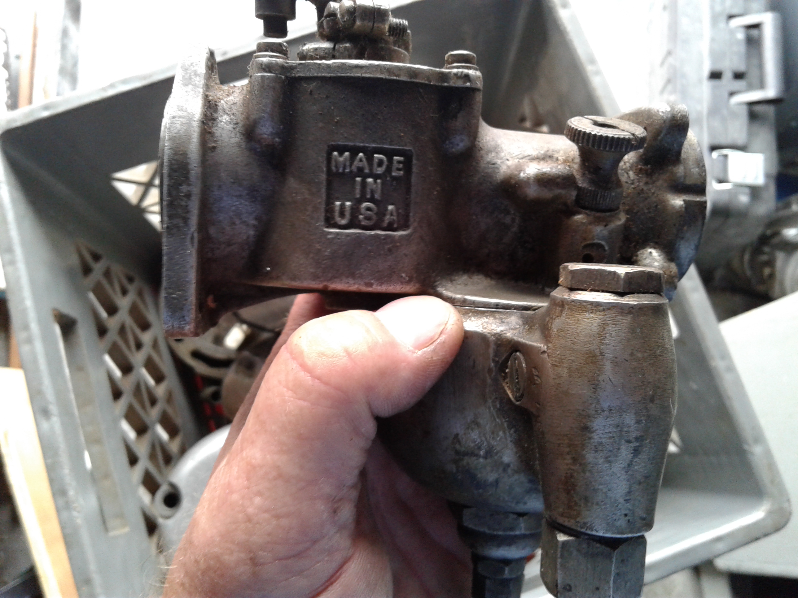

      Does anybody recognize this carburetor and know what is this for? 😉
      #66337
      outboard315
        Hmmm, May be an aircraft or inboard carb, maybe 2 cycle.
        #66338
        chris-p
          Schebler made a lot of carbs for a lot of different manufacturers, from aircraft, to motorcycles, to the marine industry to…….
          Perhaps a forum like smokstak is where I would start? Not sure its outboard anyways, but could be wrong.
          #66341
          ftruntz
            Early 4-60 used a Schebler carb………
            #66360
            RICK EICHRODT
              I also think that Schebler carbs found their way on Cross Sea Gull outboards.
              #66375
              Randy in Tampa
                OK I got the information from James Ross in Tennessee, the carburetor was used on three different things including the 460, he sent me a picture of his, he also informed me he’s casted some re-pops in the past, but with the needles that are on it and the way it’s attached it was for 1929 Indian hill climber motorcycle 😉
                #66377
                JAY T. WALLS
                  It’s the bolt pattern that gives it away as a Indian carb. Also if the carb has 3 jets, a low, a mid and a high speed it is the 1929 Indian Hillclimber.
                  #66380
                  Randy in Tampa
                    there that’s right pic sorry 😉
