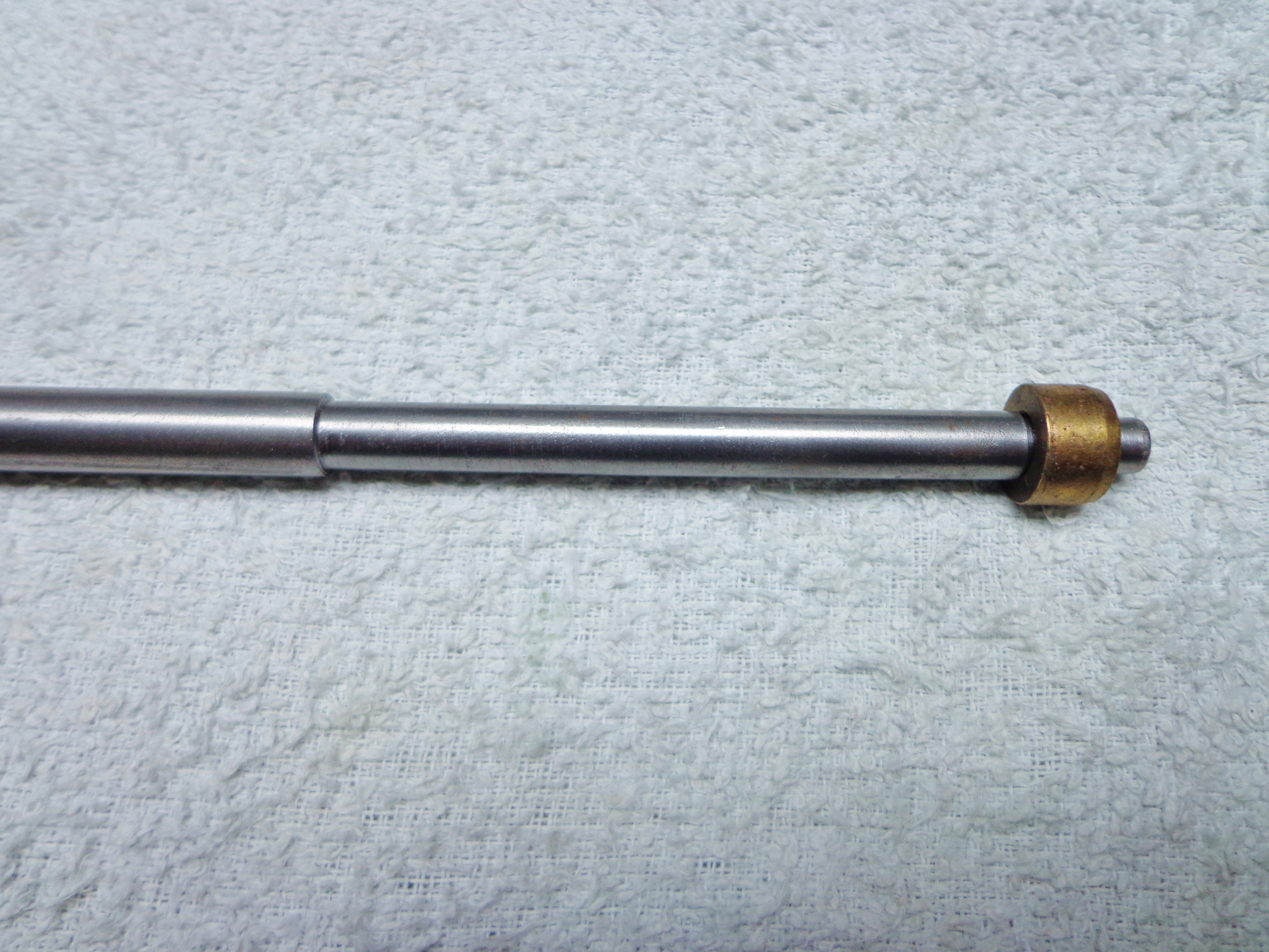

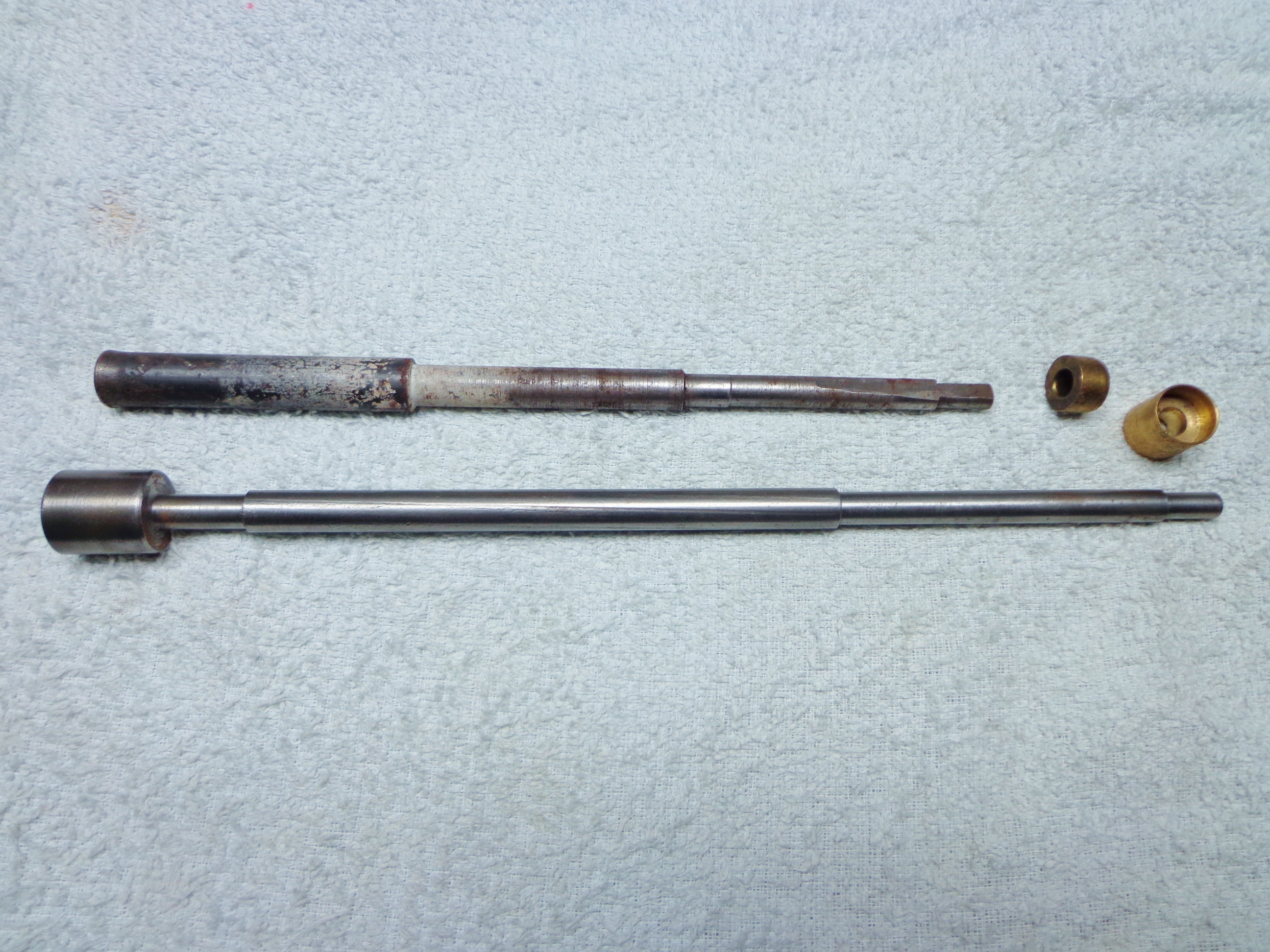

              Here’s a couple homemade ones to give you an idea what you need to knock the bushing out. They are stepped so they will fit inside the exhaust housing. The top one had to be ground down to fit inside one housing which had a bad casting. That’s how tight it can be in there.

                        The other tool that you should make, similar to mumbles, is a tool to insert the brass plug into place. My tool was made out of an old driveshaft from an outboard and you just have to tap the brass plug into place. Very similar to the tools that you use to put seals in place.
