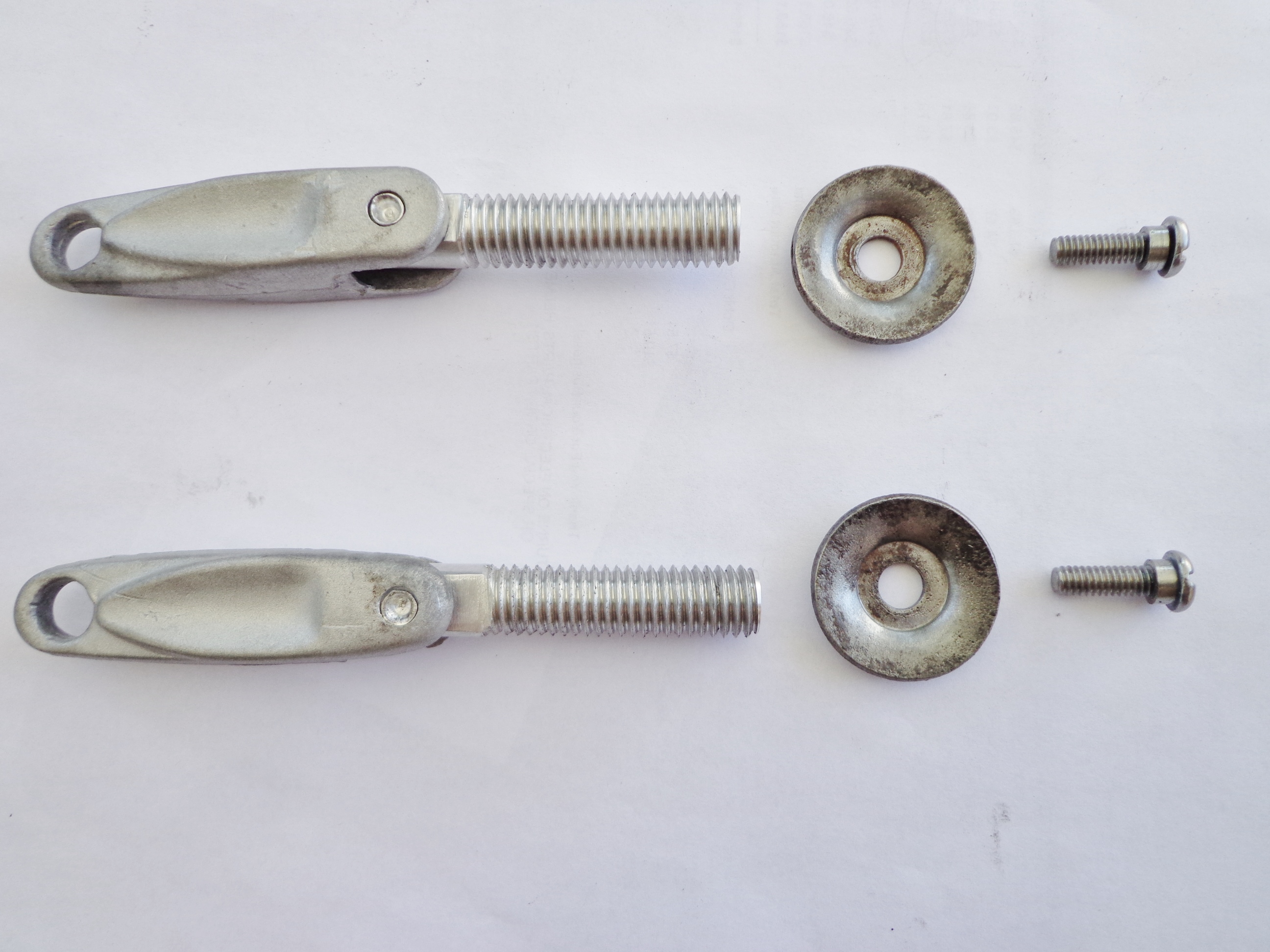

      any neat trick to rivet the cup on the clampscrew ? … one of mise has worked itself loose
      the angle is very narrow to hammer it back in place

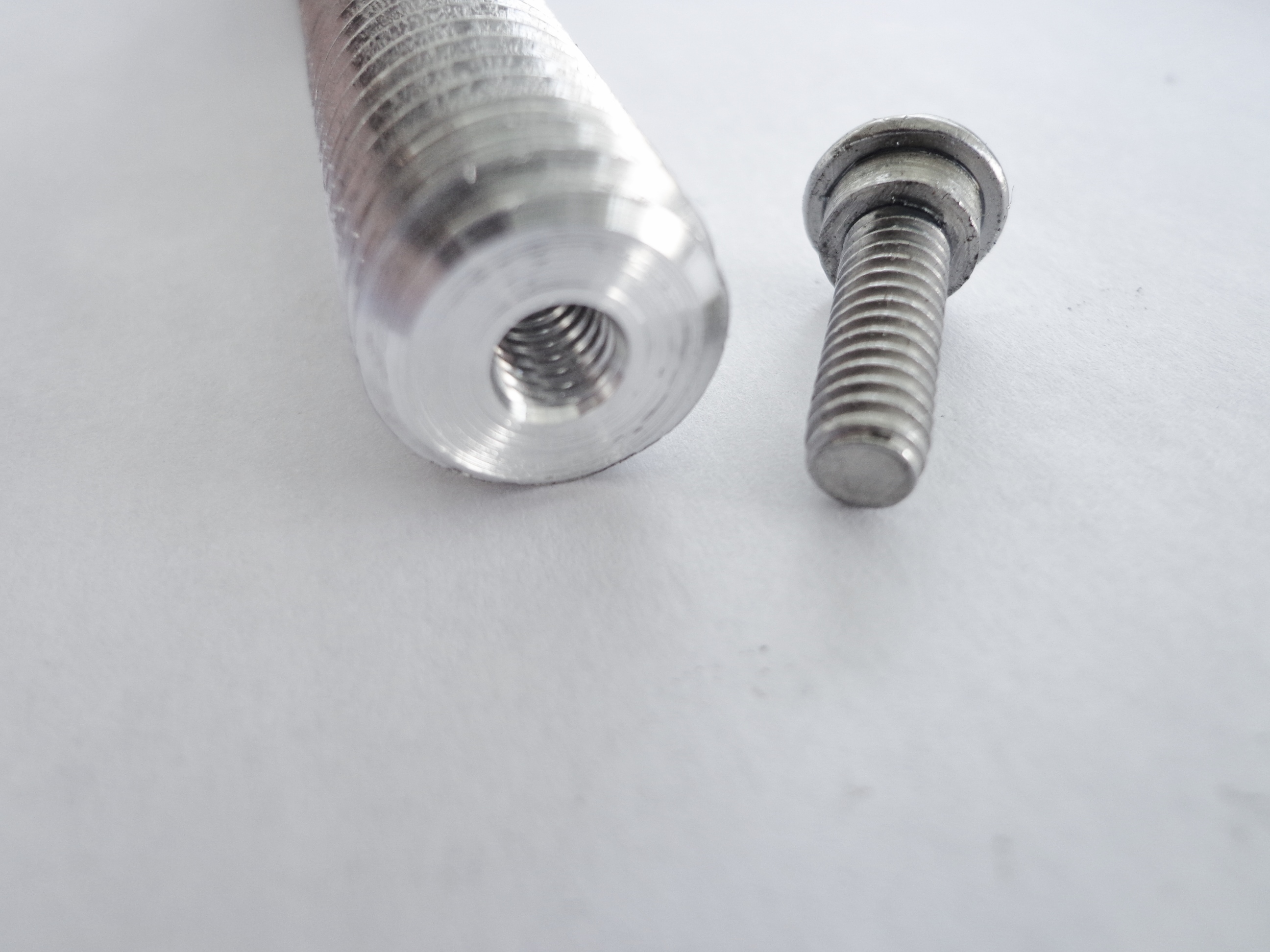

        You can drill/thread into the screw, then install a bolt to hold the cup on.
        #40928
          brilliant… πŸ’‘ thanks that is what I will do and I just happen to have a brand new set of taps πŸ˜€

            I have done this on several. Works great too. I have ground the head of the bolt a bit so that it doesn’t dig into the transom when tightened.
            #40962
              If you drill them out and tap them 12 -24 like the later ones, you can use a flat head machine screw with a collar on it if you don’t have the proper OMC screws.

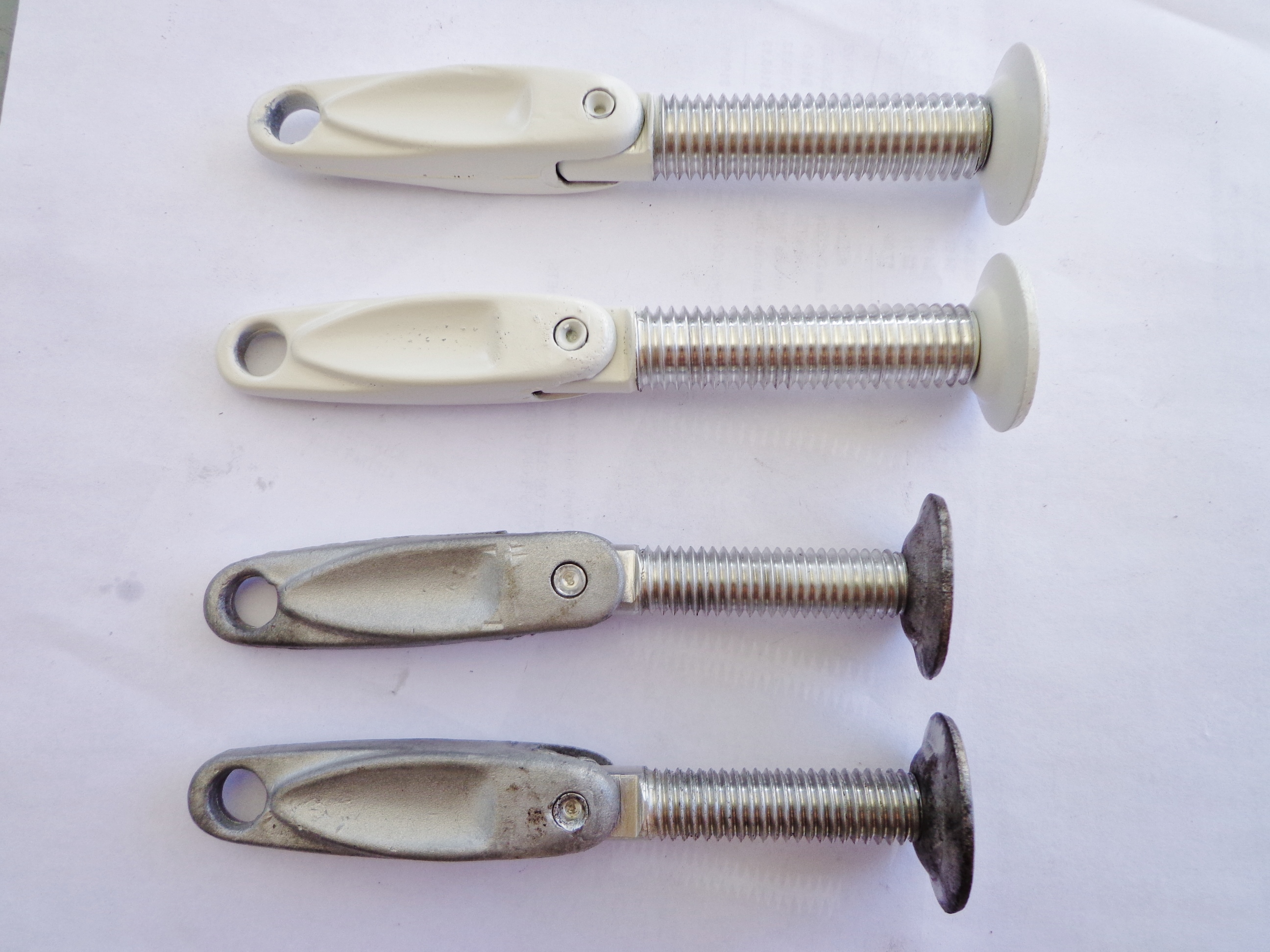

                      Mercury Service Tools (several sizes) were made for replacing or tightening loose clamp washers. They work as advertised. Some things are easier over on the Dark Side.
                      Louis
                      #40972
                        I forgot to mention the rivets holding the handle on. They are made of 3/16" aluminum rod, centre drilled and mushroomed over a bit so they wont fall out. Otherwise I just use roll pins. Another thing, keep a 7/16" wrench handy at all times while searching for motors. It will come in handy for removing the factory cups and screws from newer motors destined for the scrap pile! πŸ˜€
