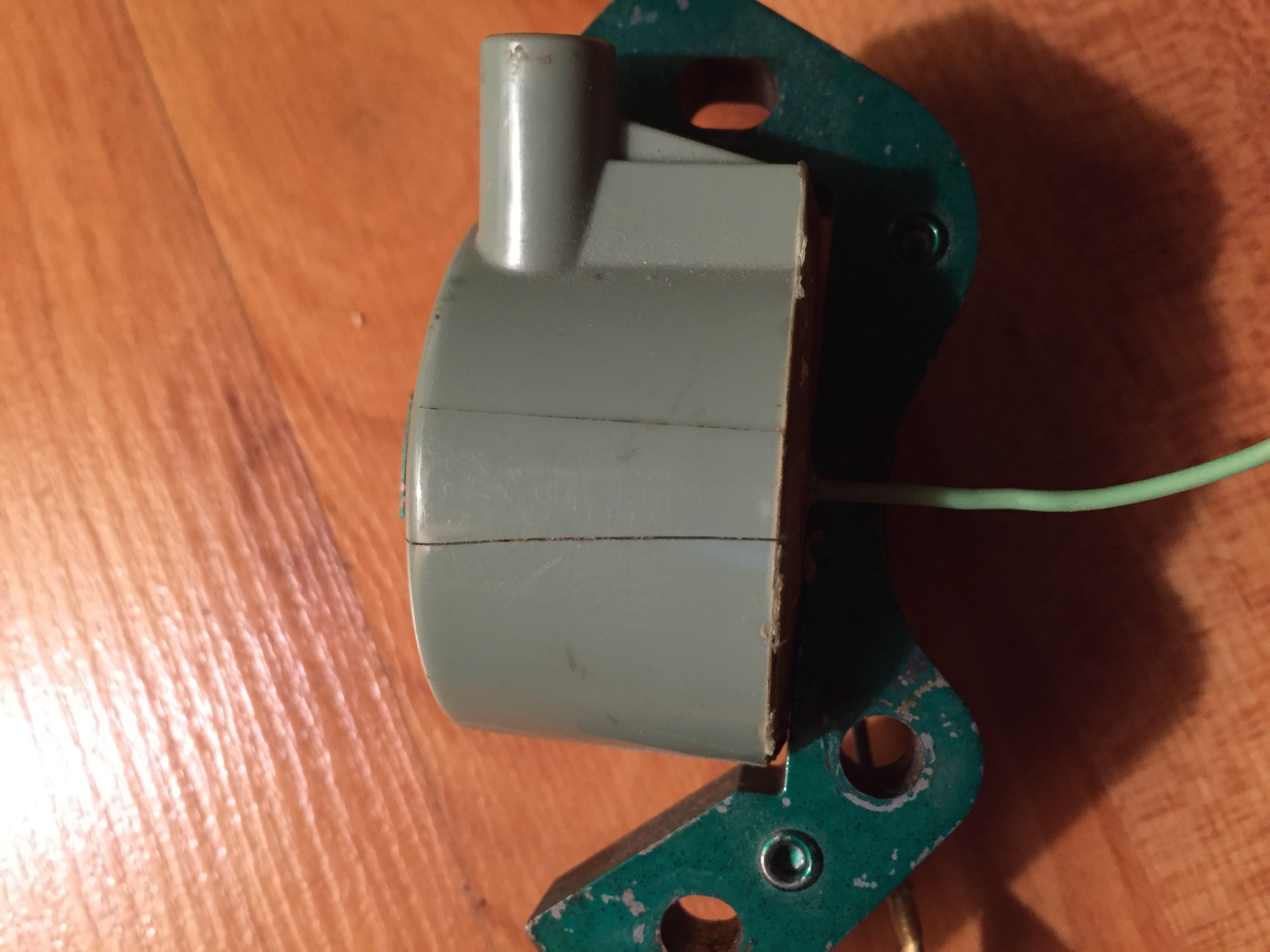

      I have a good coil here with a hairline crack . Should I try to seal it or should I toss it .

        I have found once they are cracked, moisture has already gotten in and done its thing.
        I used to try to reseal them. Until motors broke down on the water and had to go through ignition all over again. I toss them now.

        1957evinrude
          I will toss it . I have too much junk already lol
