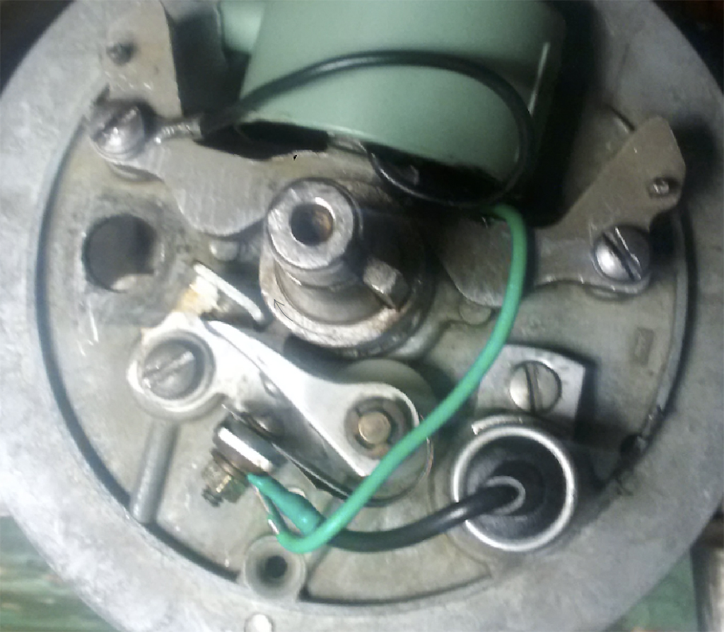

      Tubs,
      In your picture there is a washer on the bolt through the points block there. should I try to remove it?
      #49921
        If that is a fiber insulating washer your
        not getting any current to the points.
        A rusty metal washer can have the same result.
        When you remove the washer check that
        there is an insulator in the metal that the
        screw pass through. The screw needs to
        insulated from contacting the metal of the
        mag plate while letting current pass through
        the screw to the points.
        #49923
        chris-p
          The fiber washer is on the other side, before the base. That is an older metallic washer. Ill take the whole assembly apart clean and re do. I sent my flywheel to another member to re magnetize for me, so I was lazy today and didn’t work on it until I got that back.
          Thanks.
          #49927
            I’d try the flywheel first before doing anything else.
            When you do several thing at one time you never
            know for sure what the problem was.
            #49929
              Is the cam on upside down ????
              #49956
                It looks to me like the arrow is pointing in the proper direction. . . 🙂
                #49957
                chris-p
                  Great eyes Garry!
                  Yes the cam is in the correct orientation.
