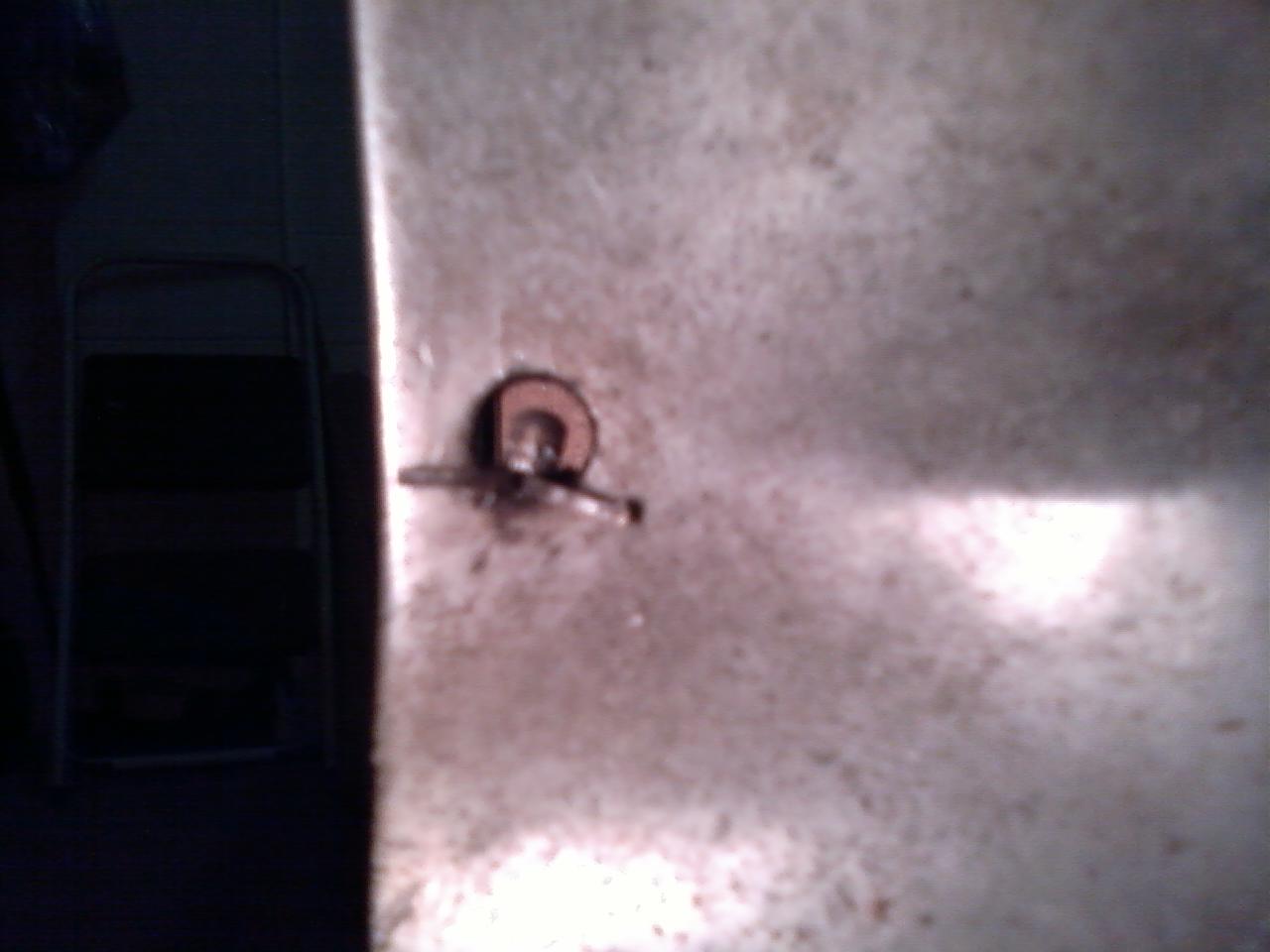

      What is this pin for on my lower unit? Could it be an indicater for the grease level?
      #50976
      Tubs
        Nope.

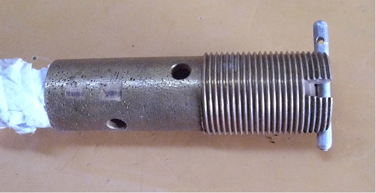

        It locks the adjustable front prop shaft
        bushing after setting the end play.
        You can see the other end sticking down
        looking at the front of the gear case.
