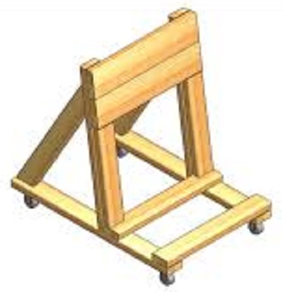

      I built a motor stand with no tilt and I thought it held the motors fine. Worse case you move the tilt pin to get a good angle.
      #51194
      mas
        My thought is that an angle allows you to trim the motor in to bring the bow down if needed. A vertical transom would not allow this??
        Mas
        #51195
        mas
          …maybe not the most efficient however.
          #51206
          johnny-infl
            I learned some very valuable information on making my first motor stand.
            the first one was just by guessing at all the particulars from internet projects.
            (and from seeing the very fine engine stands in "Pappy’s" hoarding barn).
            I did not take into account the center of balance and when I had a 40hp Johnson
            on it, it tipped over while I was moving it !!! luckily I was not hurt and nothing broke on the motor.
            Notes:
            don’t use nails !!! use through-bolts on everything
            take into consideration of making a pad for putting a water tub on the mount
            don’t use wheels from an old office chair.
            don’t use metal saw-horse braces.
            of course this is in direct relation to the size and weight of the motors you plan to put on it.
