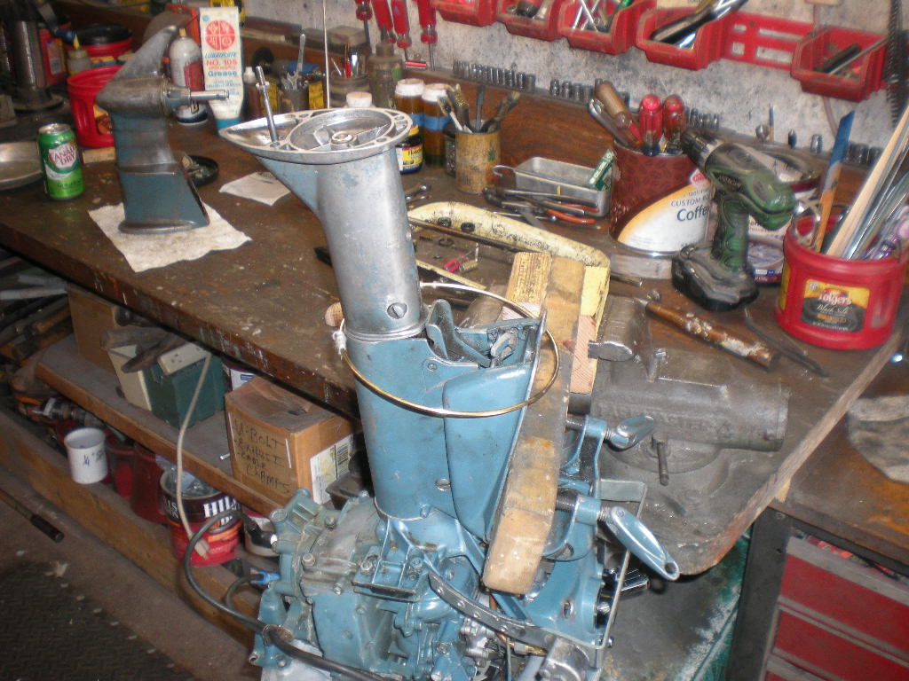

      Sometimes I like to re-assemble the lower units with
      the power head upside down. It’s a pain getting
      them mounted on my bench vise board, trying
      to hold the motor in place while tightening the
      transom pads.

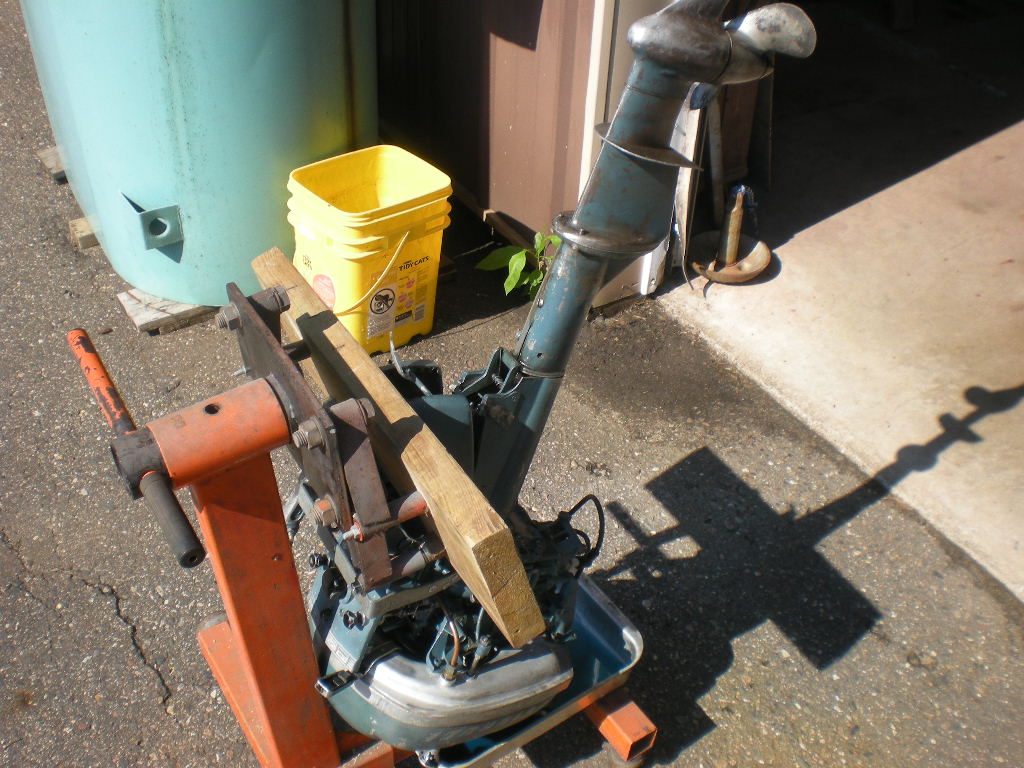

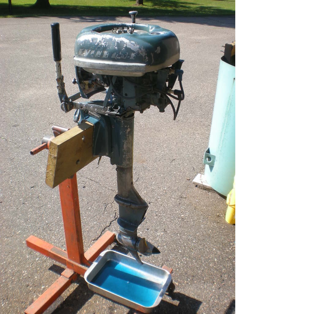

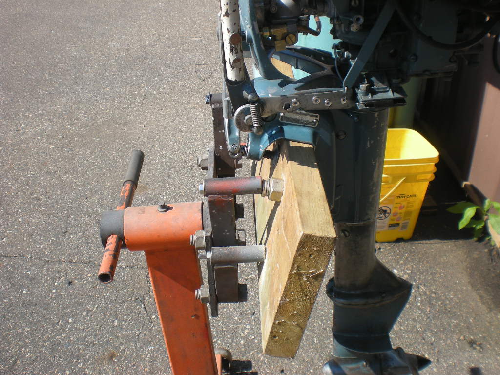

          Well I dug the engine stand out of the shed and went
          to work. Used a 2 x 10 and what bolts I could find,
          using big nuts for spaces to simulate a 12 degree
          transom mount so the lower unit would be straight
          vertical, whether upright or inverted.
          I put it to a test right away and found it worked
          great to drain the gas out of the old Rude.
          No more struggling holding an outboard upside
          down trying to hit the funnel, and feeling gas
          run down your pants leg 😮
          I didn’t try reversing the engine before I
          rotated it upside down, but beware that
          without the reverse lock engaged
          the motor could tip back, scratching
          the front of the motor.
