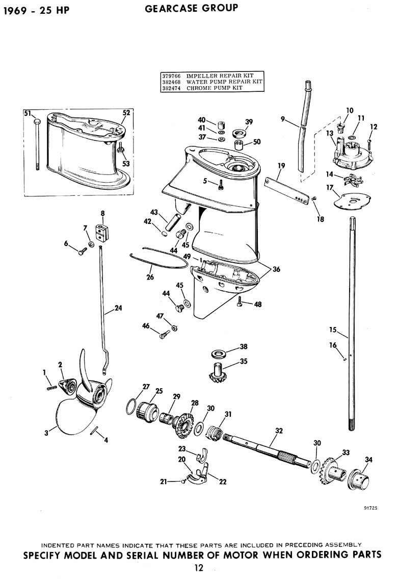

      #74552
        Too many to list. Generally speaking 12-15-18-20-25hp with 5-bolt gearcases. Internal parts vary, but complete unit should bolt up and work.
        #74555
          The 1955, ’56 & ’57 use the same drive shaft – those should work . . . 😉

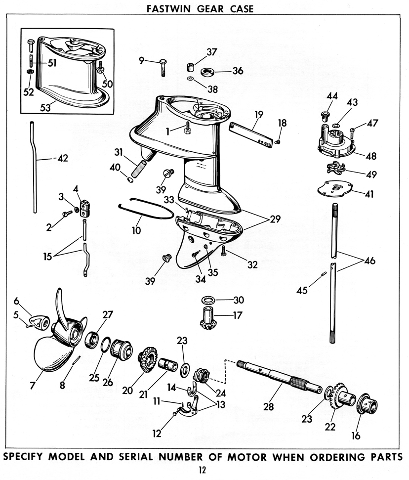

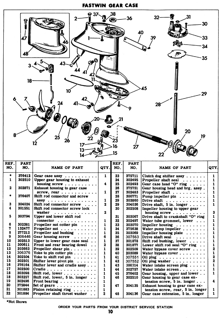

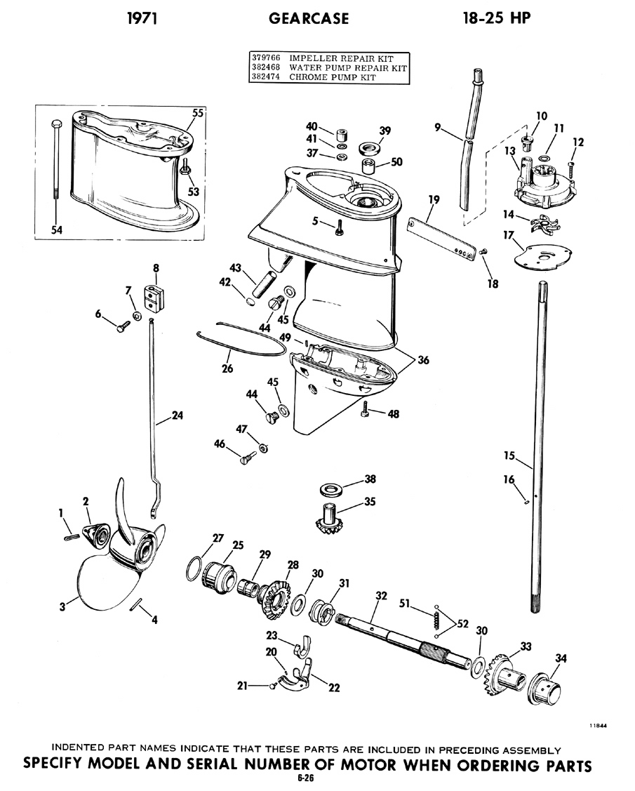

                    Interesting picture. Must be a pre-production picture because it shows a 4-bolt gearcase, whereas a "real" 15014 has a 5-bolt gearcase.
                    #74594
                      This is the Gear Case (Lower Unit) . . .
                      1955 – model 15014

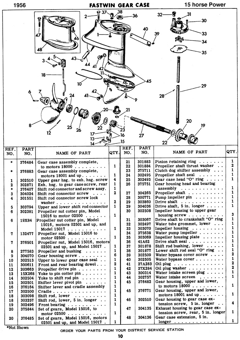

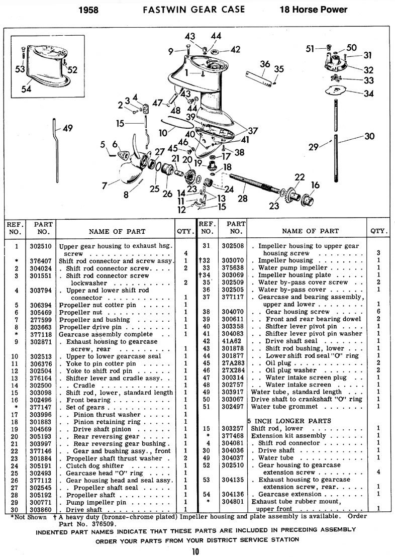

                      #74597
                        1956 & 1958 . . . 😎
