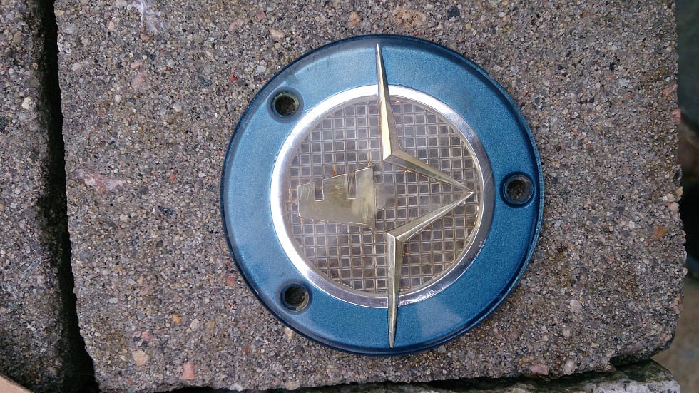

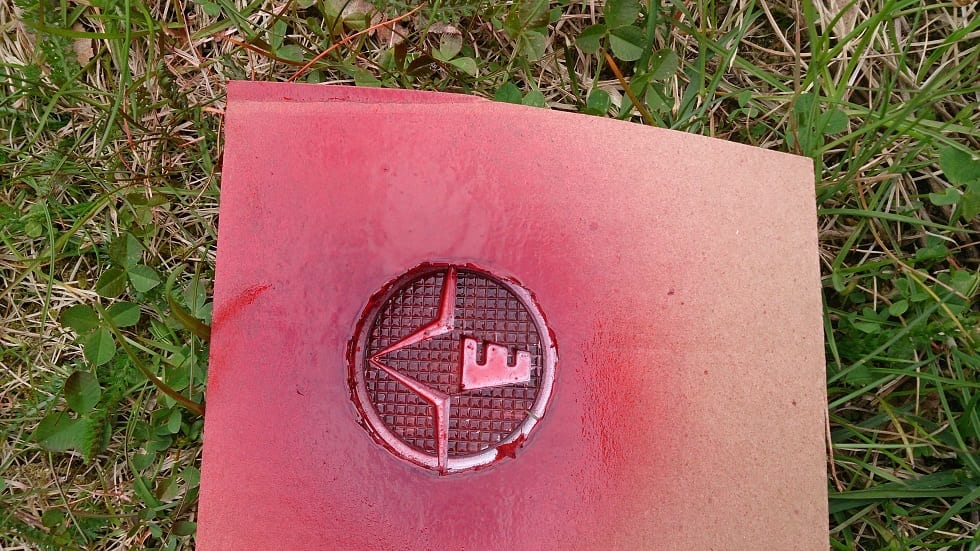

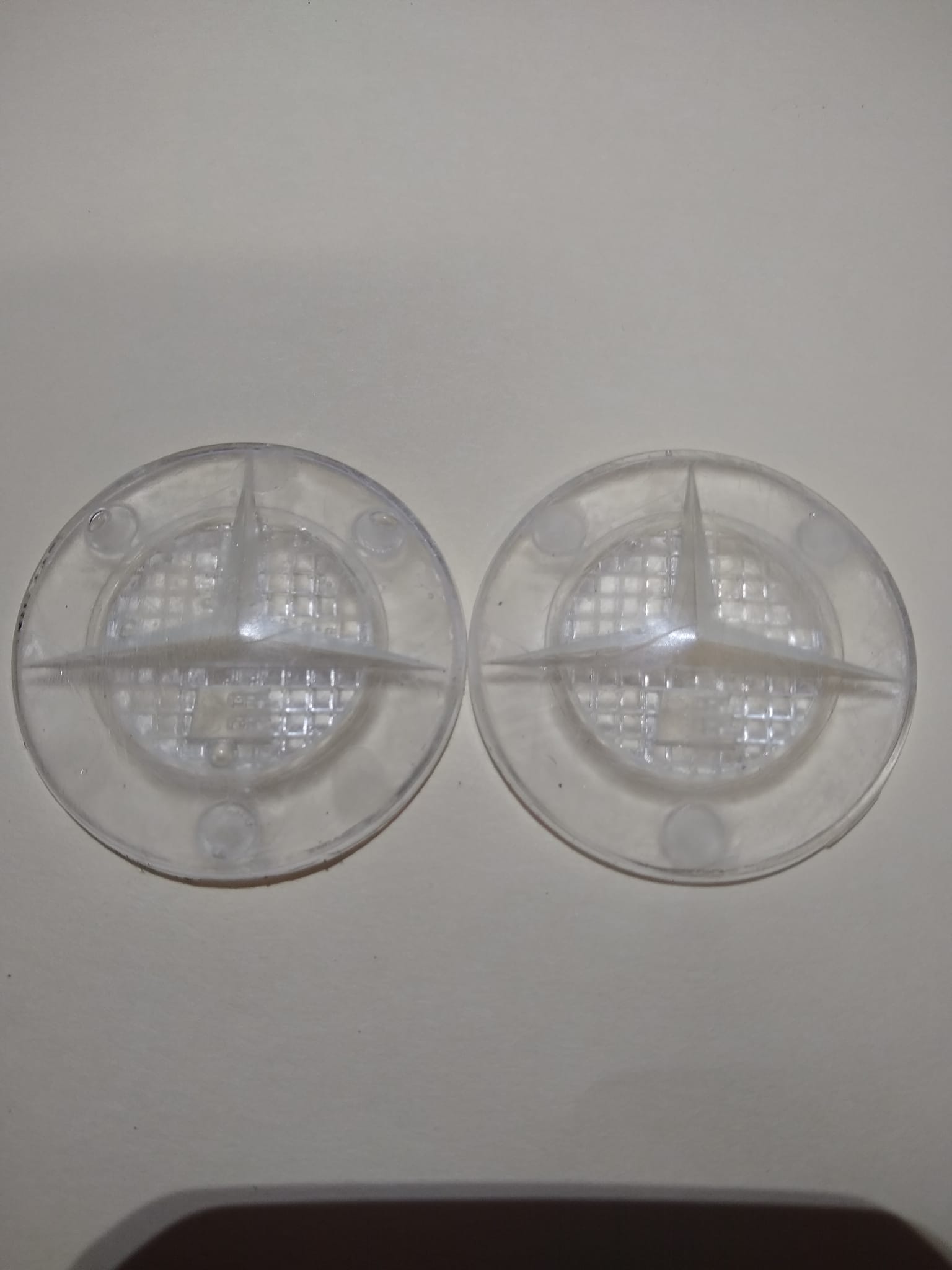

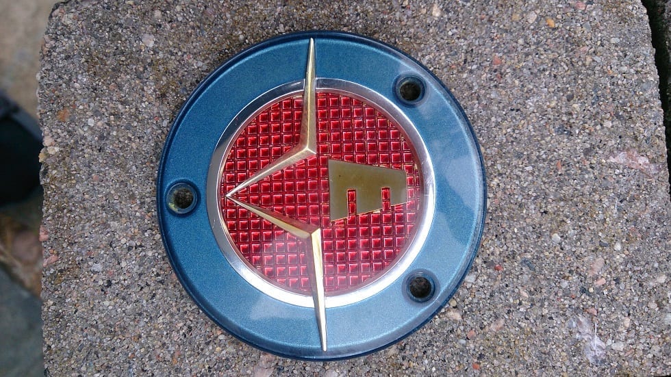

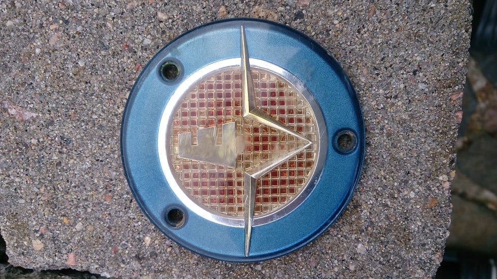

        JAN ADALBERON
          I’ve restored mine. Used my fingernails and a toothpick to remove old paint . Used Dupli-color red transparent paint – see pictures for reference. The other side can be wet sanded with 1500 grid sand paper and re-polished.
          DSC_0734
          DSC_0730
          DSC_0732
          DSC_0733
          • This reply was modified 6 years, 6 months ago by Mumbles.
          #193922
          JAN ADALBERON
            initially :
            DSC_0729

            PugetSoundBoater
              Jan- you did a great job! Thanks for the info and photos.

              #193986
                What an beautiful job indeed!

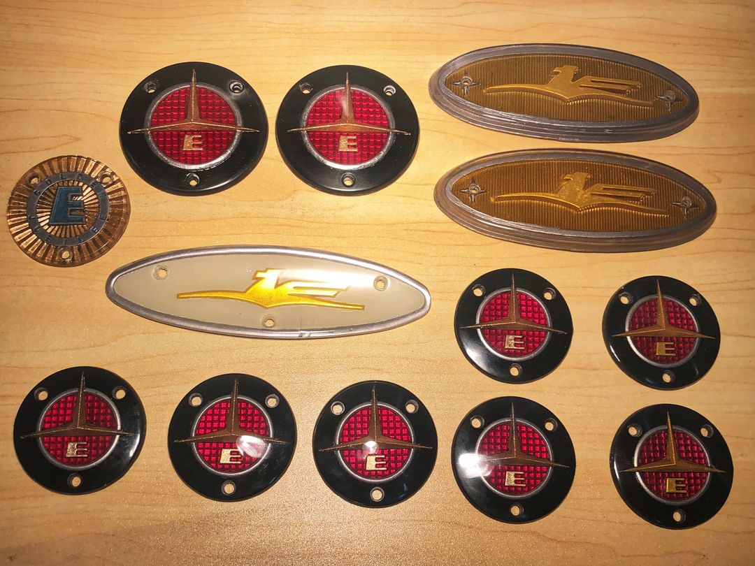

                      #258630
                        A fellow on Facebook is making duplicate Golden Jubilee and Evinrude emblems and they look pretty good to me!
                        Emblems
                        Cast-Emblems
