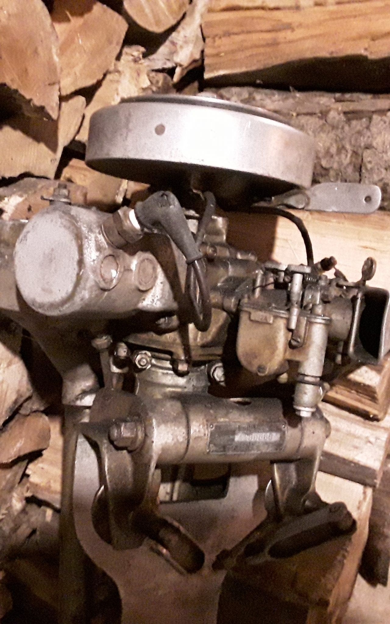

      I recently picked up a Evinrude twin cylinder. It has a serial number 4180666. I do not find a model number. I tried to post pictures but file size is too big. Can anyone tell me what it is?
      #185571
        You have a 1932 11 horse power Fleetwin – that 11 horse power is a little ambitious – The model number is 418

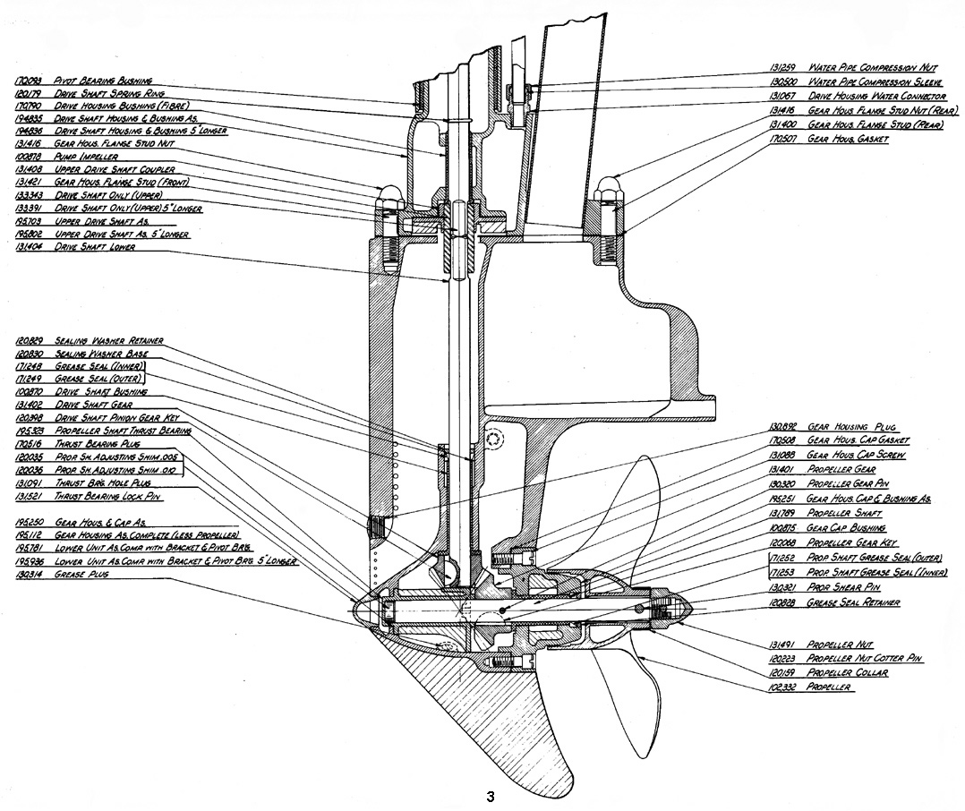

            This is a little newer Fleetwin. Most parts are the same and the layout is easier to understand. . .

                If all goes as planned I will start cleaning it up this weekend. I read an article that indicates the carburetor for my motor should have a primer. My carburetor doesn’t appear to have the primer. It has a choke lever. Anyone have any thoughts on this?
                I have pictures but am unable to get them to post.
