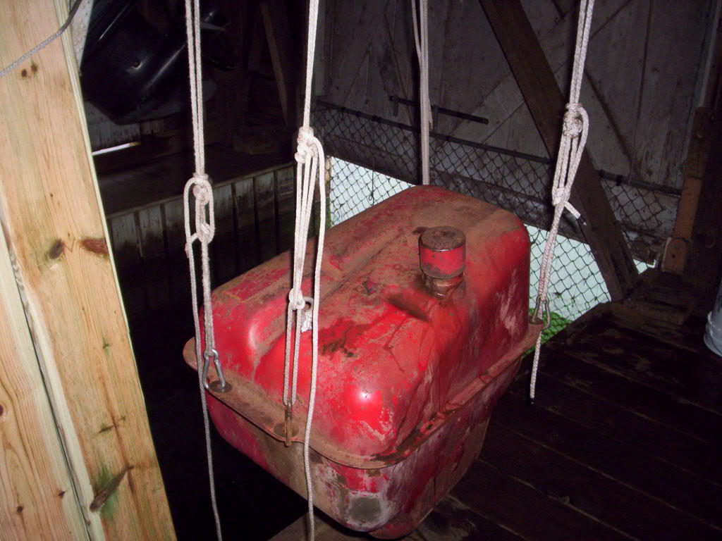

          bill-loveland
            You inspired me to tackle my tractor gas tank – alas, I didn’t have a second tractor to do it this way: https://www.youtube.com/watch?v=eVZvjdQT3ks
            so I hung it from the beams in my boathouse. One wash with ammonia, and now I’m working through four gallons of diluted cider and several pounds of old screws:

            nali
              Does this tank move ?
