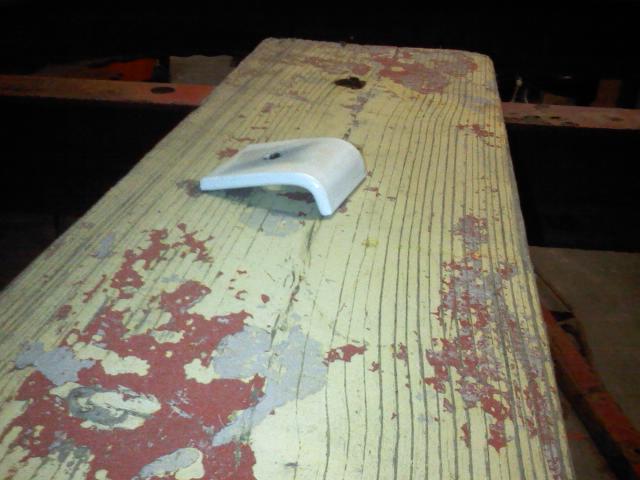

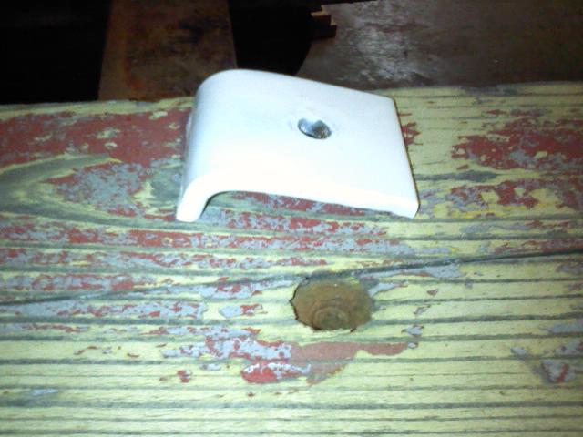

      As promised pictures.
      My memory was not working as well as it should have been this morning.

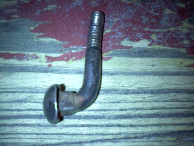

      The rear attachment at the bracket you queried is a simple "J" bolt.

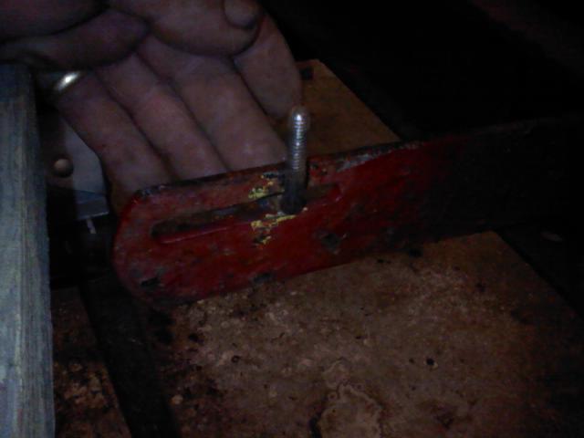

      The next two are belly clips that clamp the walking plank to the forward two cross members using a carriage bolt.
      Hope this helps.
      #41705
        Boxcar, thanks for the pics! I have the little "L" bracket, but
        could not figure out how or where it attached. Now that I know
        there’s a "J" bolt involved, I’ll take another look.
