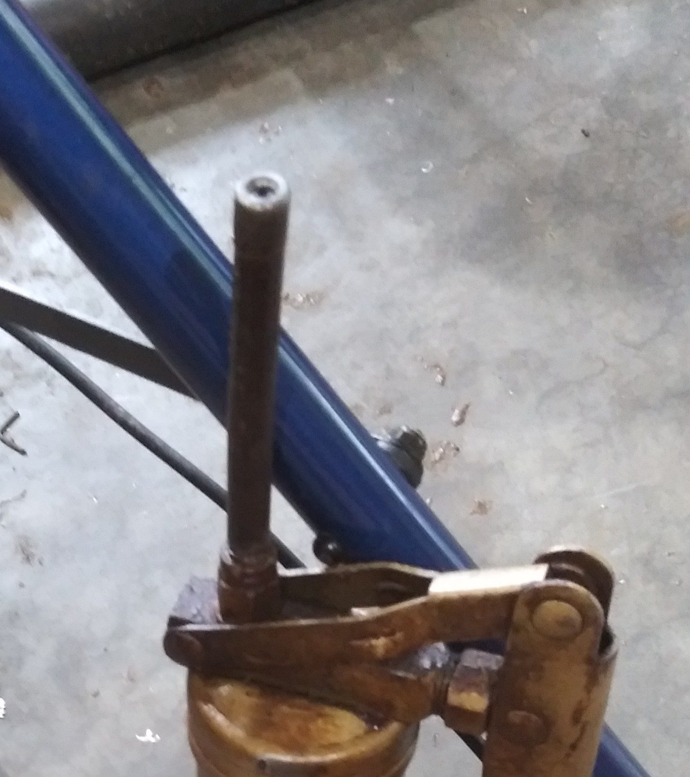

          #289437
            I do have a rubber seat tip that I have put on a conventional grease gun. But couldn’t get a decent picture of it with my phone camera.
