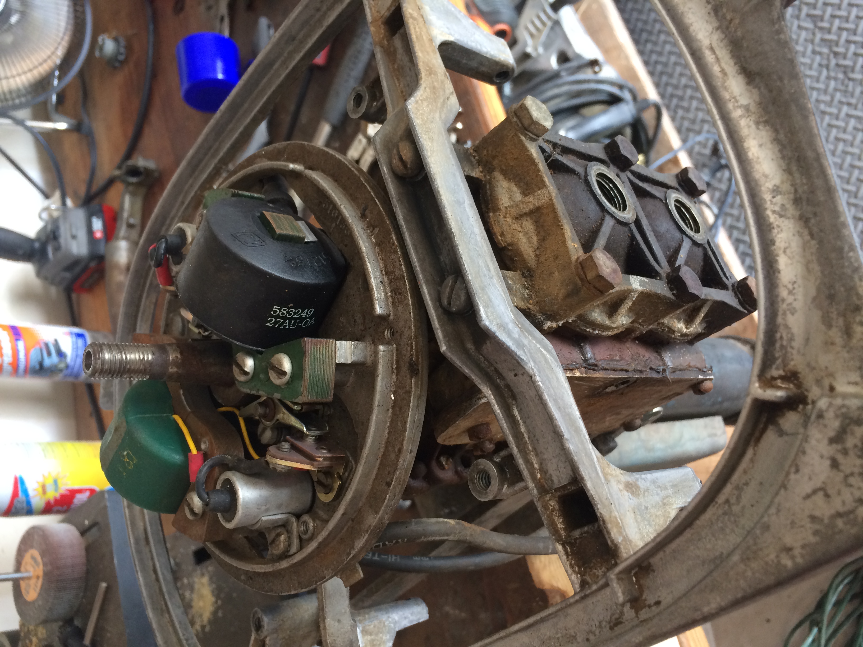

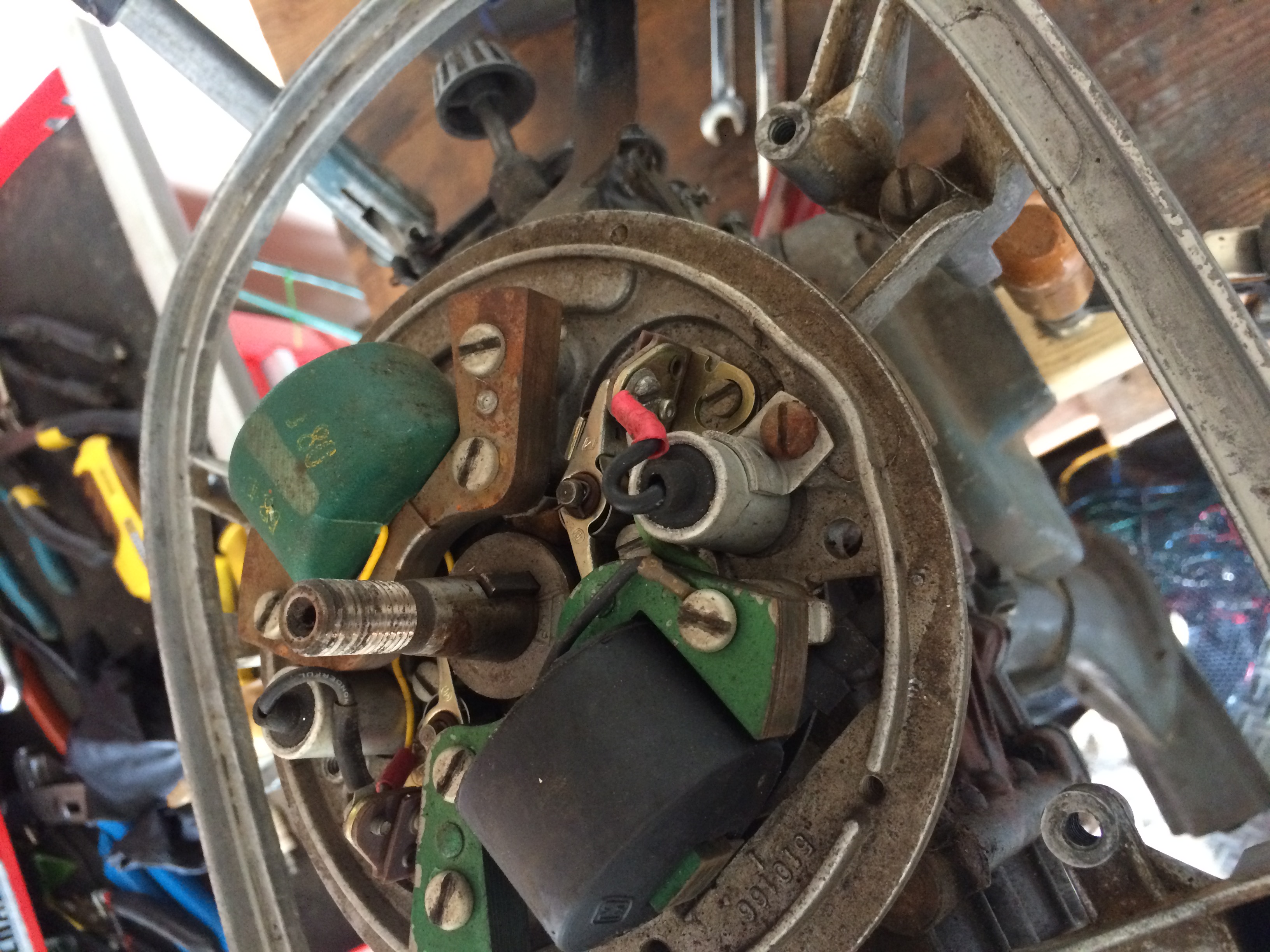

      Not quite sure year and model. Any help would be great.

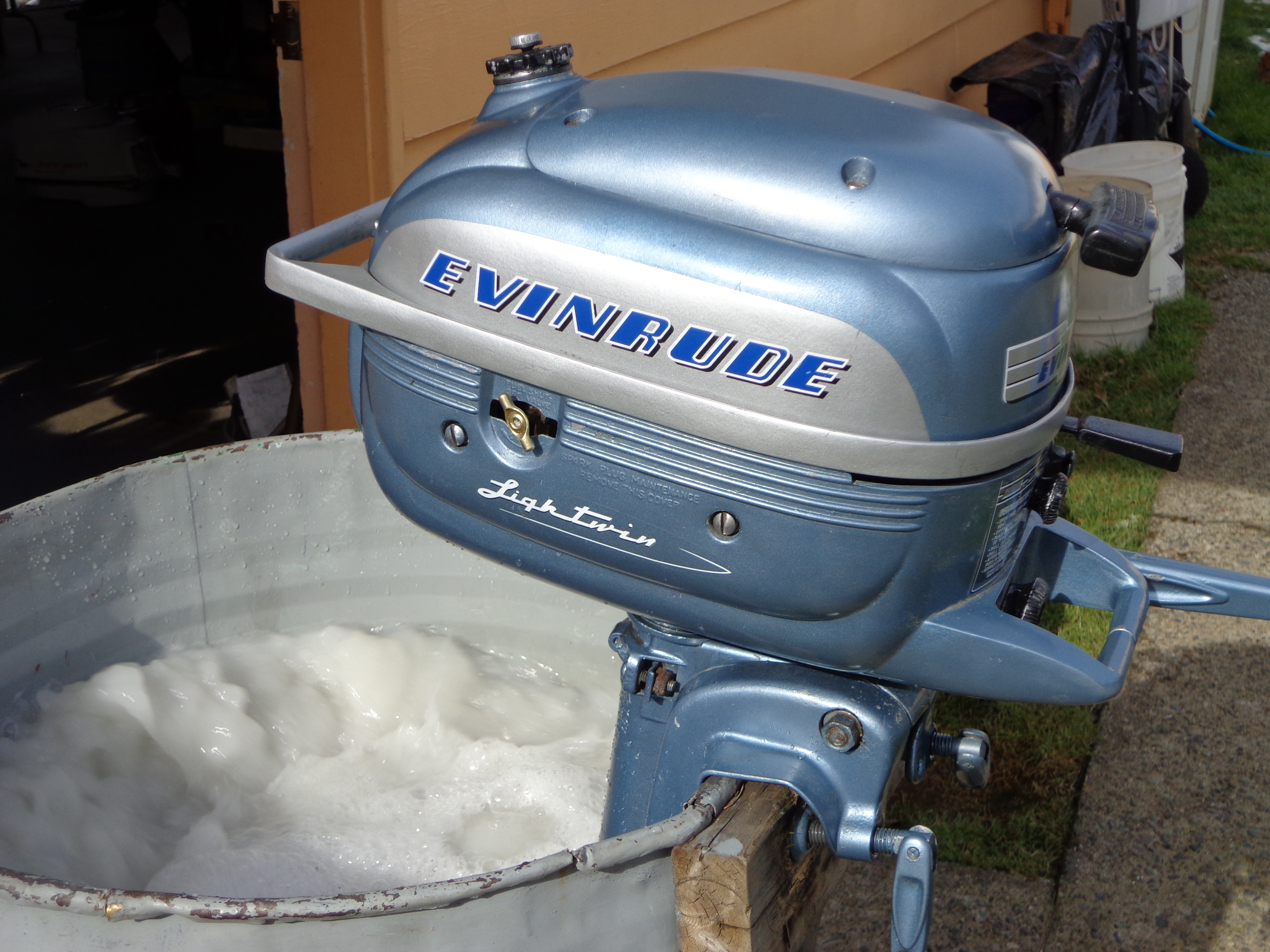

        1952 Evinrude Lightwin
        #78130
        ed-sam
          Evinrude 60,s 3 hp lightwin.
          #78140
            I’d say early fifties. You have to get the model number off the ID plate to confirm the year.
