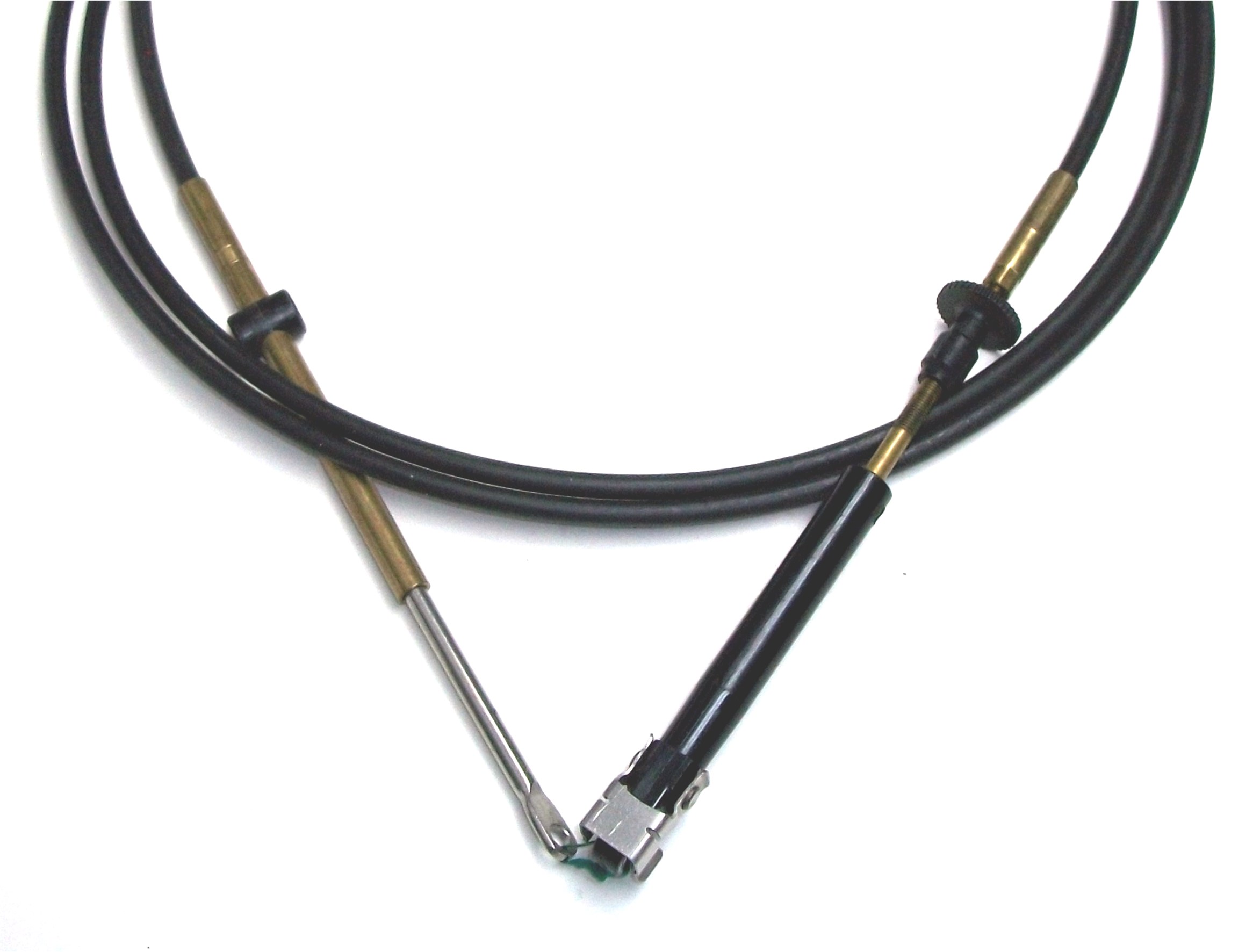

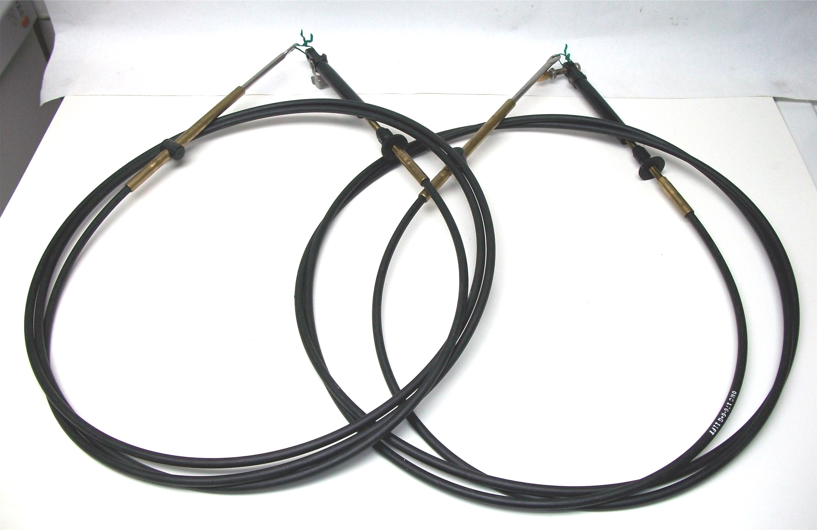

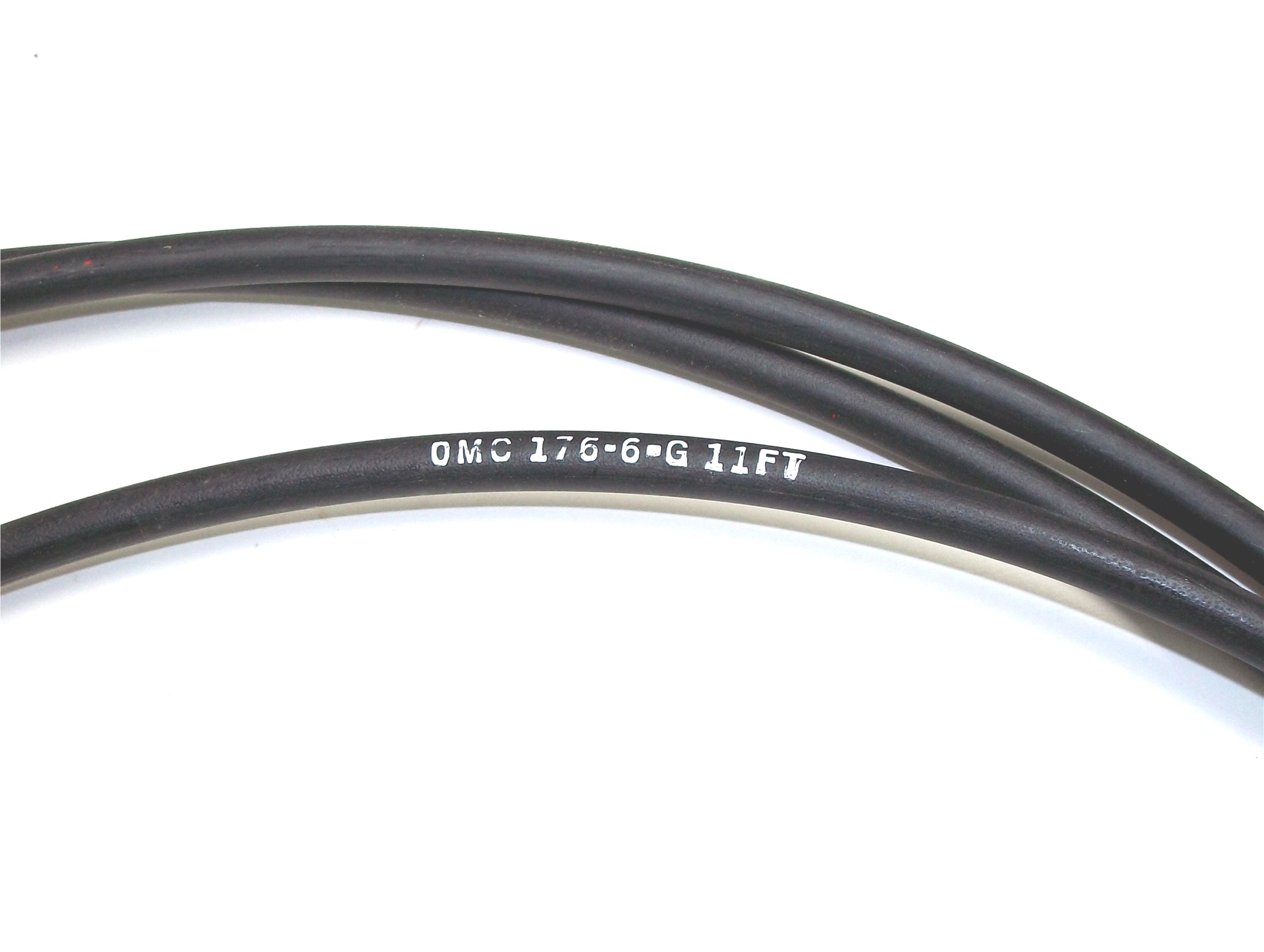

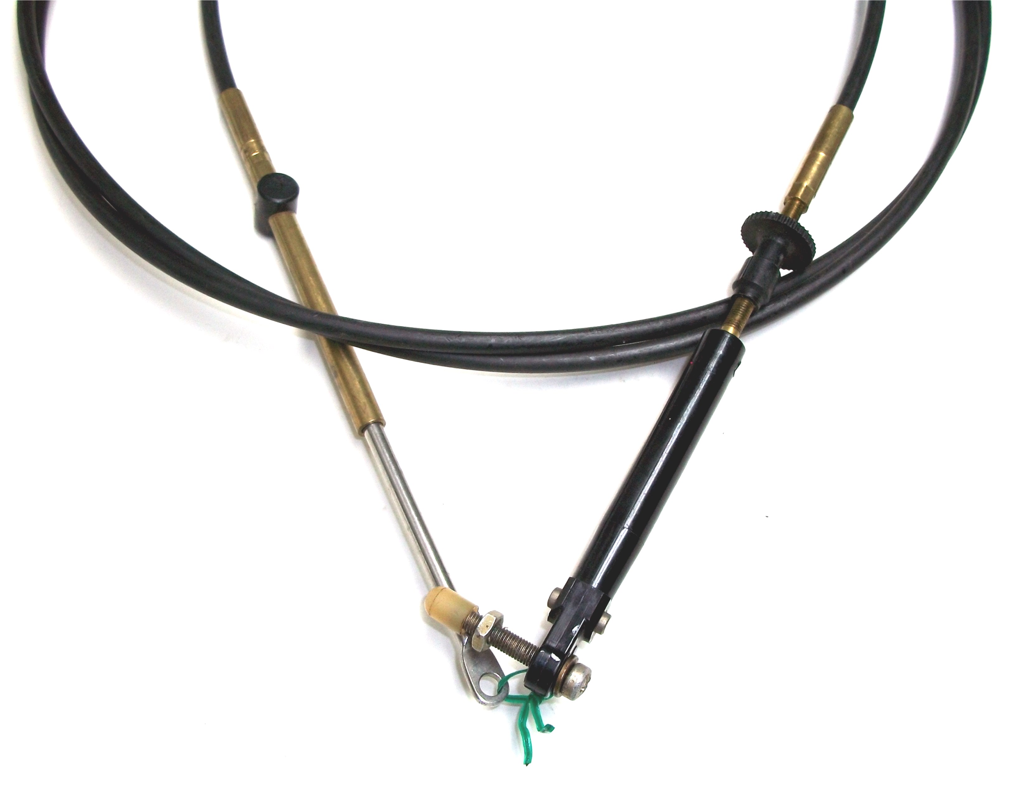

      I got these as partial payment for some work I’m doing but I’m not too familiar with cables and not sure what years these were for. I often see 1979 as the year referred to when discussing cables. These look like they’d be after 1979? Any info, websites for pricing, etc. would be appreciated, thanks.
      #62189
      chinewalker
        Look like standard OMC post-1979 cables. I think they refer to them as type 479 cables. The big difference between these and earlier cables, is the cable ends are not removable. They’re called "snap in" cables.
