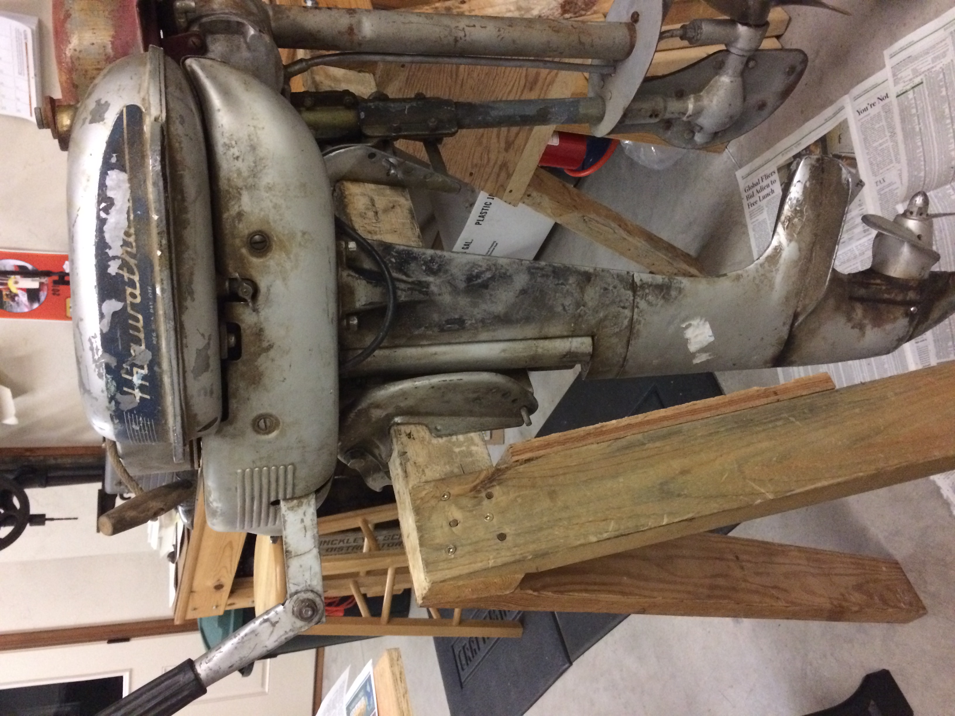

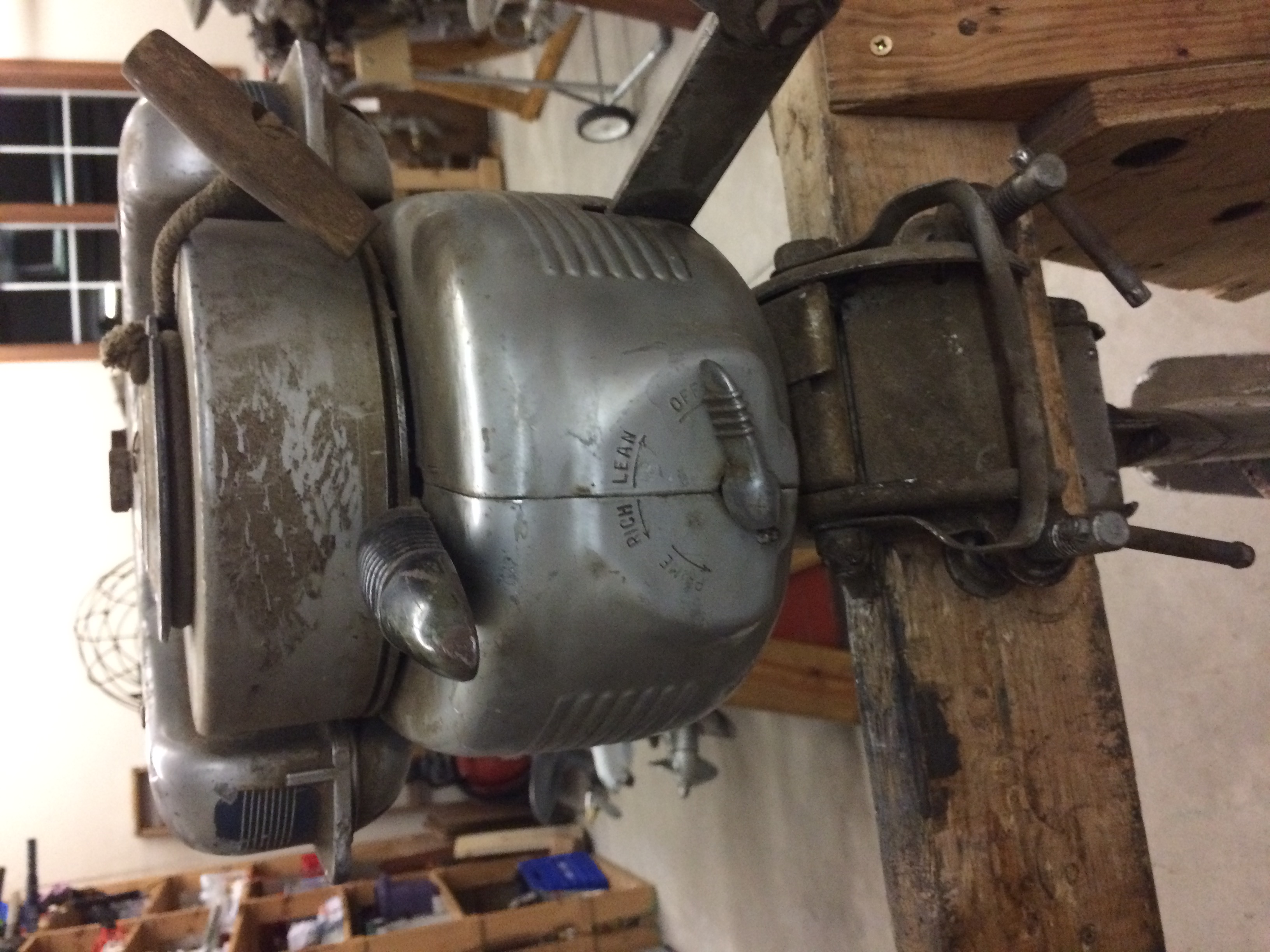

The I.D. Tag of this Hiawatha is missing. I don’t know the year, hp or who made it. It seems every manufacturer has made Hiawatha at one time. Thanks for your help. Alan
Your Hiawatha is a1946 three horse built by the Gale Products division of OMC. . . \
Made by Gale Products Division of OMC
Great minds work together. And post replies at the same time.
Thank you both.

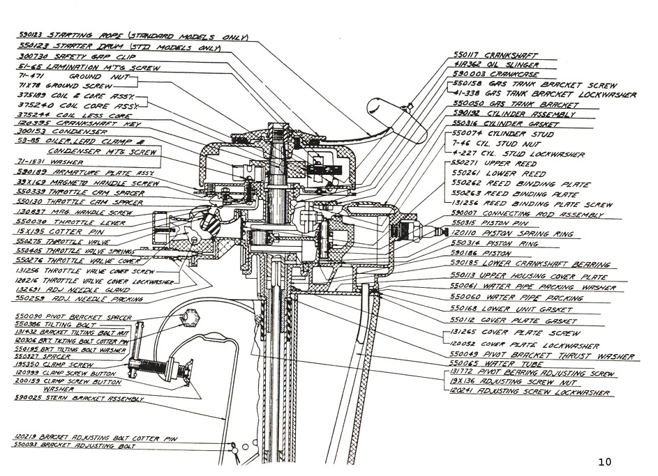

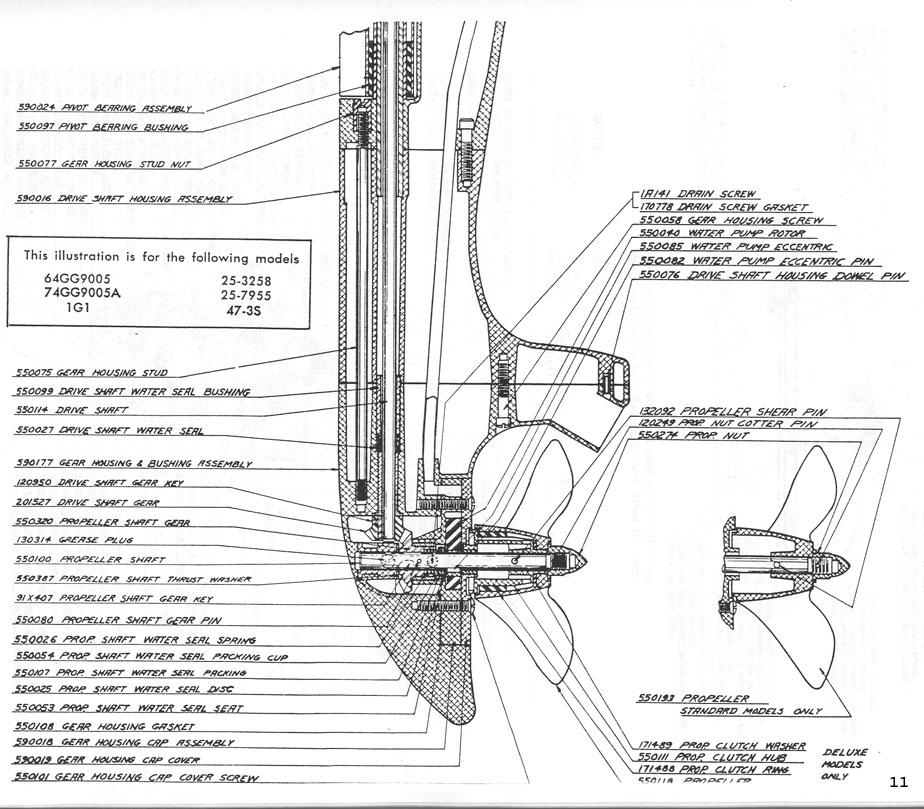

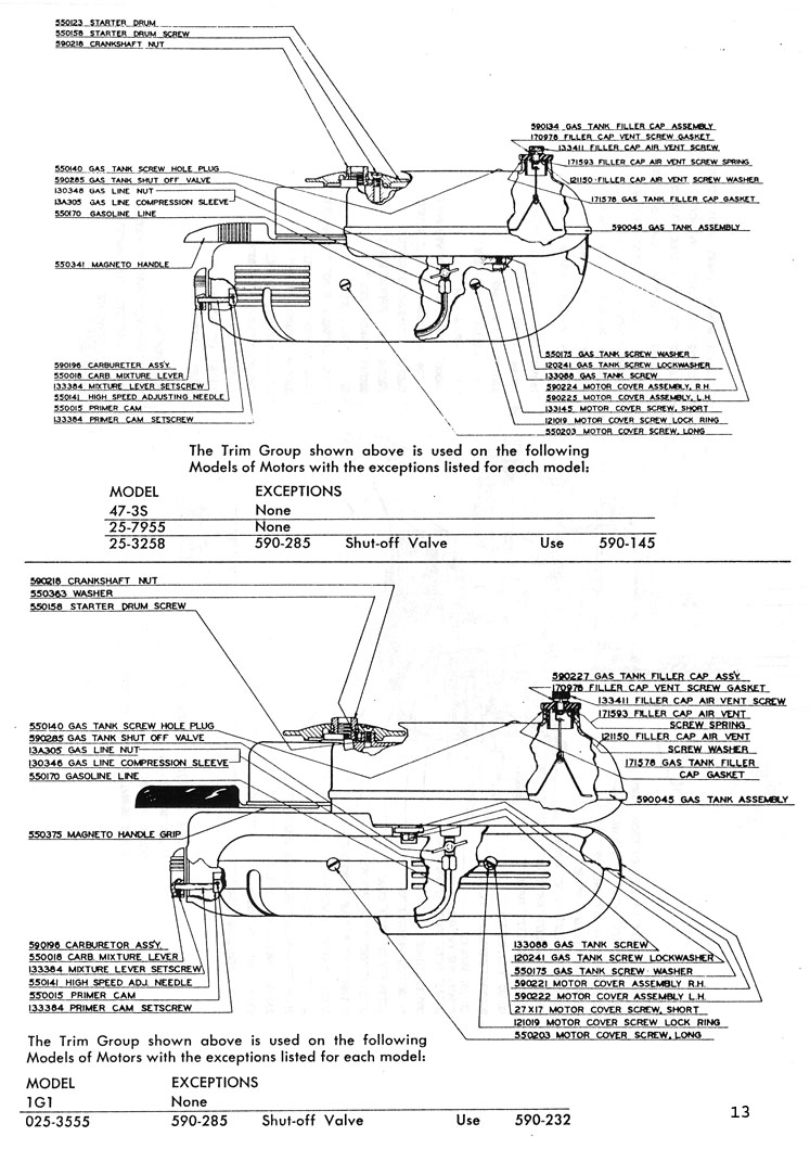

This is from my Dropbox site –
