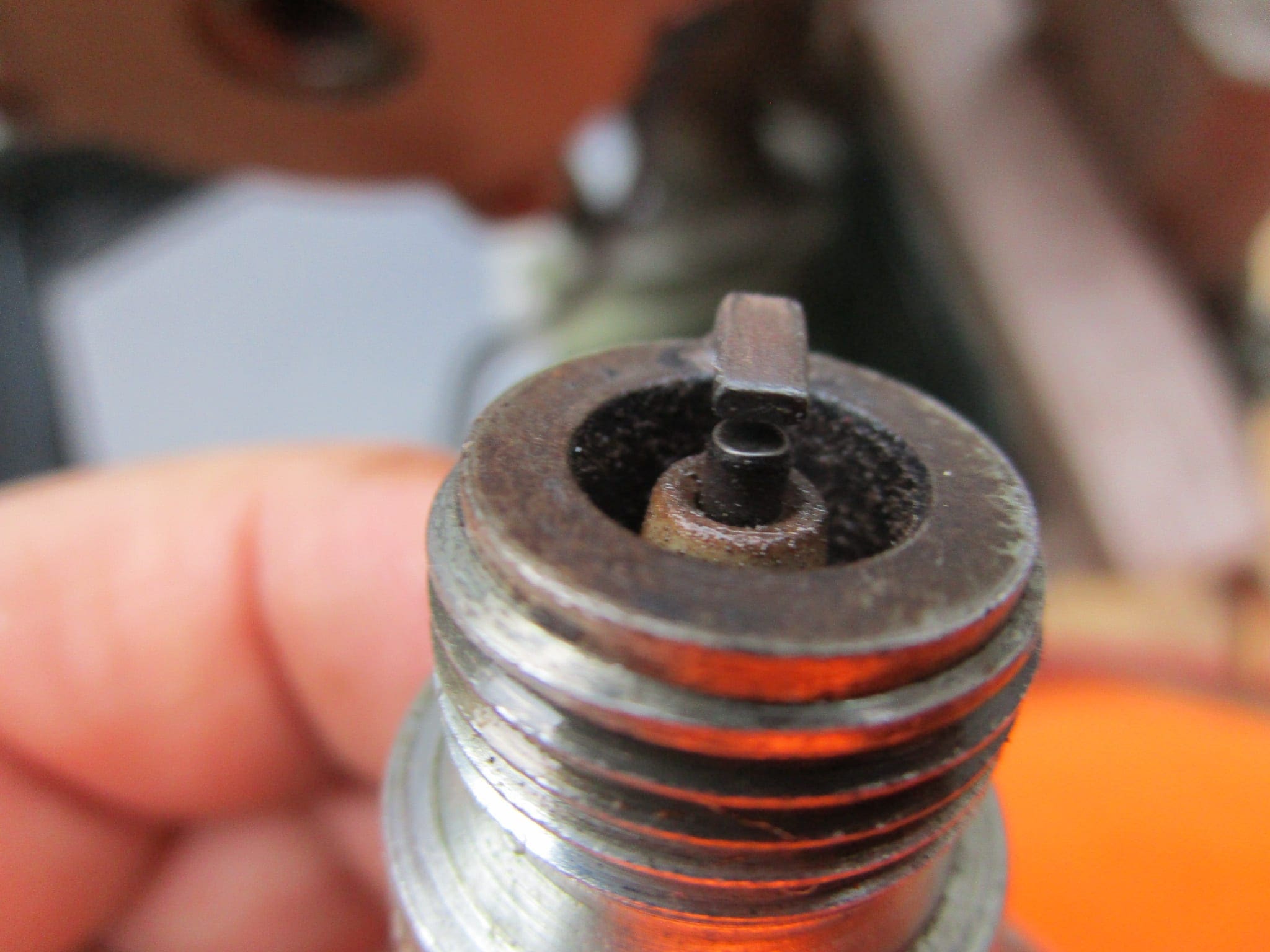

        Plugs don’t look too bad . Cleaned them and reinstalled….Not sure how to check water pump system . I guess I will take one of the lines loose and squirt the hose in it and try and flush out anything that may clog it up . Idk ….I don’t have a flywheel puller atm . I’ll get one though .

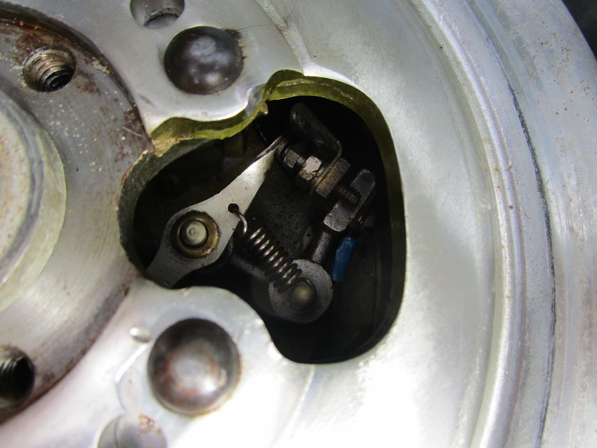

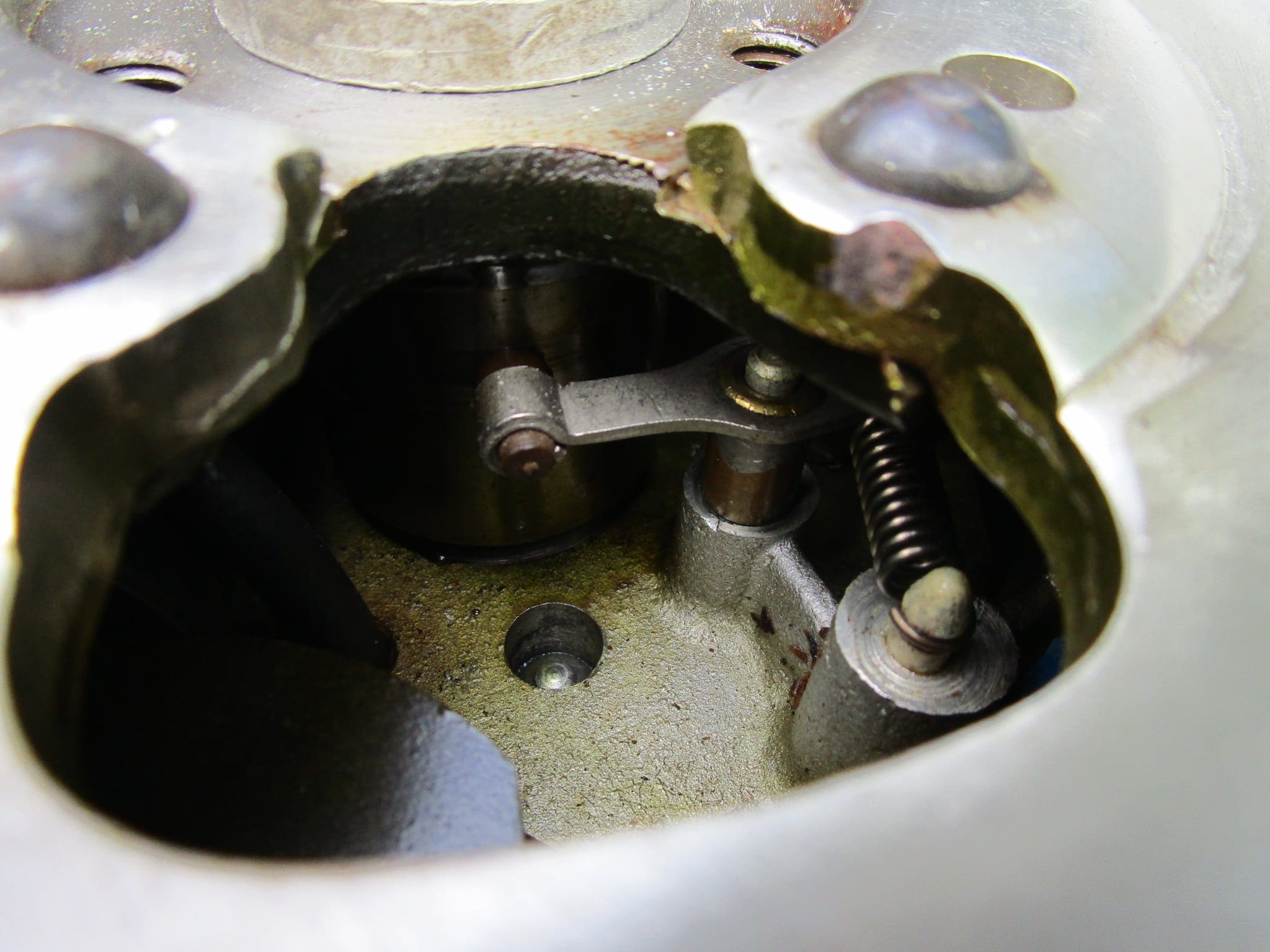

              Ok so when checking the gap on the points . Should that be done while it’s at its widest point . I can rotate the flywheel and get the gauge at it very easily . I’m gunna pick up a new set of plugs .
              What should the gap on those be set at . But I need to figure out why no spark . At the widest point on the point gap thee is just a fuzz of slop on the gauge at .020 . Should I try and tighten the gap ?
              Any help here would be greatly appreciated …

                After a crap load of reading and searching here I only found reference to the point setting at .012 , .015 , and .020 . So I set it at .015 . I picked up a set of the NKG -AB6 plugs . All I found was the gap should be .030 . They came preset at .025 so I just left it .. what should be the proper gap ?

                      Set points to 0.020″, Spark plugs should be fine at 0.025-0.030″ for now. As Wayne mentioned, timing is probably to far advanced. Bring the spark lever back some and try again.

                        Oh, and points need to be CLEAN!!!!!!!
