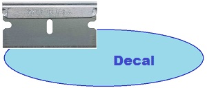

      I always advocate starting from the least aggressive method and move up the line
      to find what will be successful for the project.
      I have used a single edged razorblade and slowly and meticulously start scraping
      (not cutting – scraping) from the outside edge moving towards the center.
      the blade should be fairly new and held about 90 degrees to the surface.
