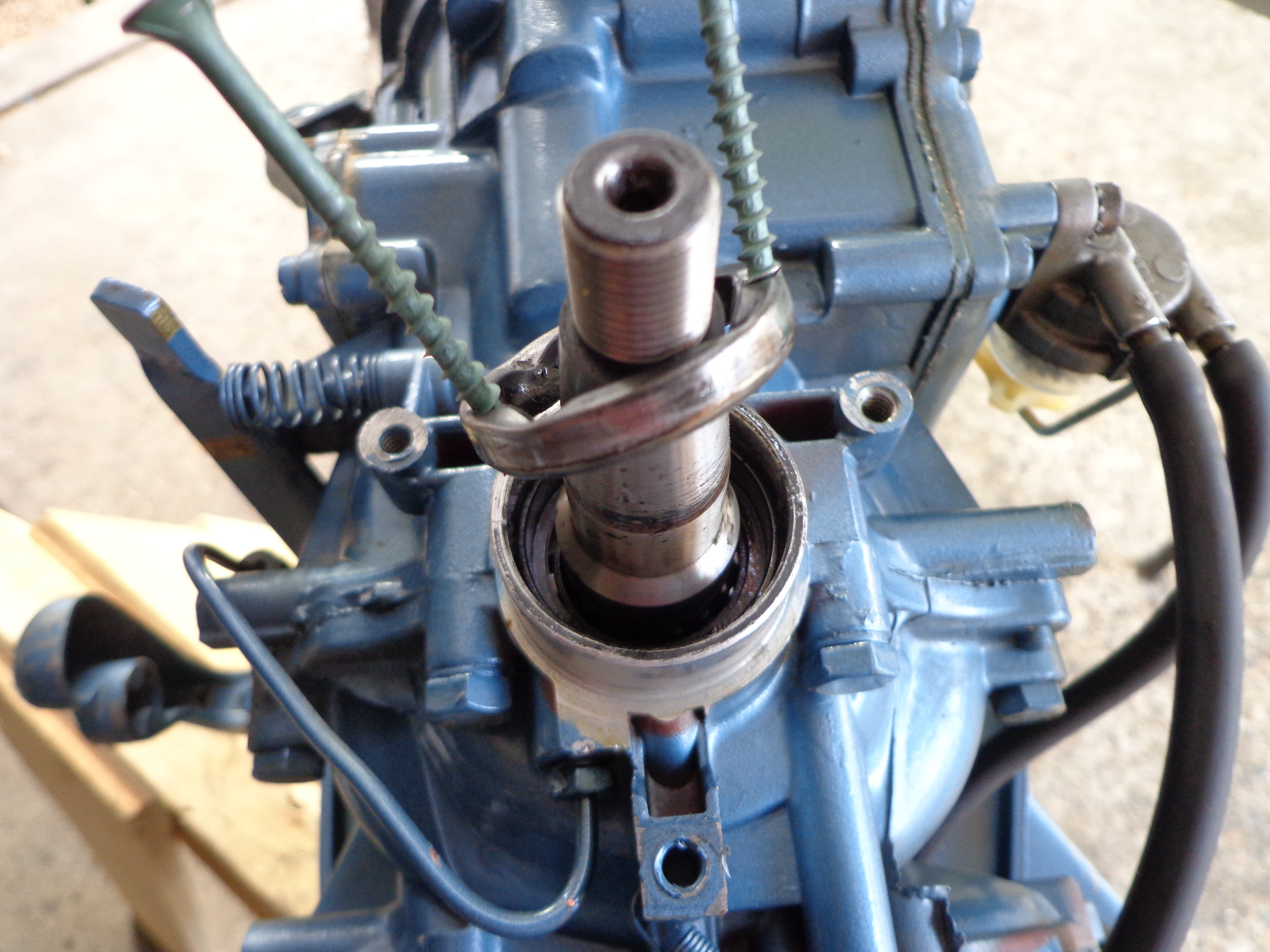

            If you don’t have the tool or don’t want to split the cases, you can always improvise with a couple of screws.
