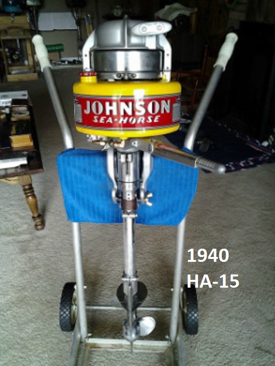

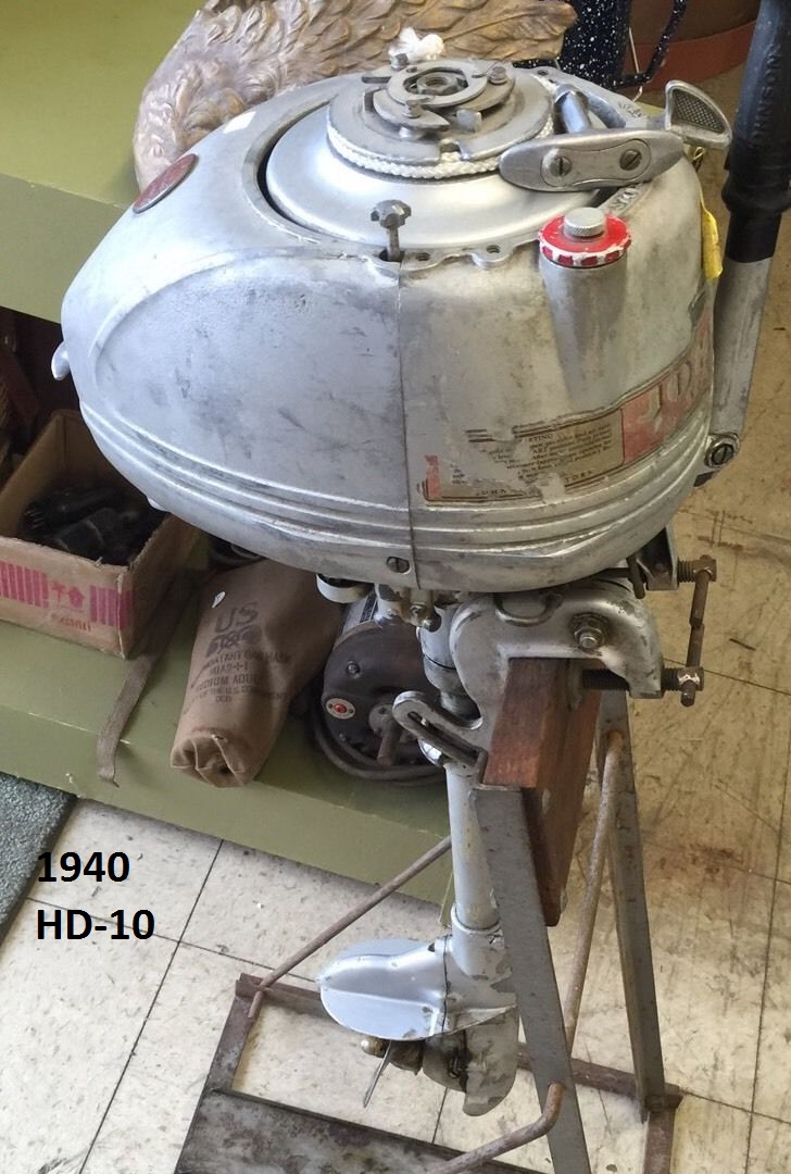

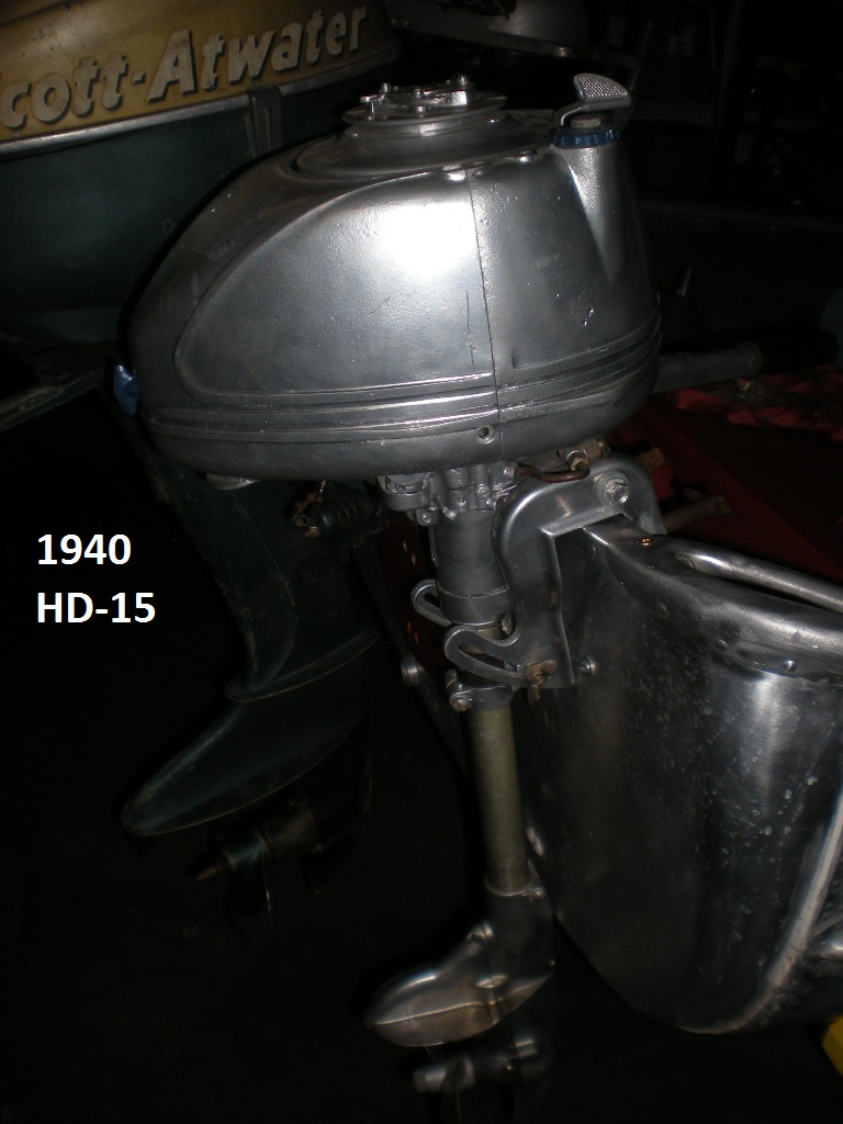

      As I was looking for Internet photos of Johnson HD-15’s to
      see what the missing cover emblem and primer knob looks
      like for my outboard, I found some good photos of an HD-10
      on Ebay. The outboard looks just like my HD-15, so
      I presumed the HD-10 was just a prior year model.
      When I looked up the model list though on Marine Engine,
      things get confusing! It appears that they made both the HD-10
      and HD-15 in 1940, as well as an HA-15, which looks
      totally different.
      Any idea why Johnson had such a variety of 2.5 hp motors
      for 1940?
      HA-39 2.5 1939
      HA-10 2.5 1940
      HA-15 2.5 1940
      HD-10 2.5 1940
      HD-15 2.5 1940
      Upon purchase, my HD-15 was missing the rewind.
      My uncle found a empty rewind housing for it in his
      junk pile. Any idea if the guts would fit from
      another, more available model?
      Of the photos, only the HD-15 is mine.
      Thanks!

        I see your missing the usually missing (3) piano springs for your unit. I got a complete rewind unit and cover that bolts on from our favorite used "old engine collector" Doug Penn. Someone earlier said he got married and retired, but I see he is back up on his home page.

            Oltimer, I presume by piano springs, your talking about
            the three rewind pawl springs. If so, I got some practice
            making those on the three HD-25’s I went through!
            I found a loose HD-25 rewind today. It’s guts are
            definitely too big for the HD-15 housing.
            If I get the old girl running, I’ll find parts.
            If it doesn’t, I’ll wrap a rope around the rewind,
            thread the end out the housing, and attach pull
            handle…… good for one pull 🙂

              I think it is called a Simplex Starter Buccaneer. Known for not standing up, and guy’s had better results over the long term by removing it.
