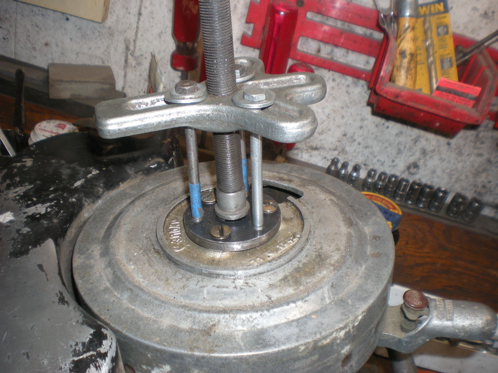

        Made an adapter plate as Garry mentioned.
        I used a 1/4 inch round plate I already had
        cut out for something. I have the puller
        snugged down pretty tight, gave it a few
        raps with the hammer, repeated, etc.,
        but it hasn’t "popped" yet. I’m using the
        14-24 brass bolts that were in the flywheel
        to hold down the adapter plate, so I hesitate
        to tighten things much further. Will let
        it sit with tension on it over night and
        try some more tomorrow!

          Someone once told me to use the rope sheave as the puller by leaving it in place and back the center bolt (that has a lip on it) off.
          The lip will catch the sheave and pop the flywheel off. It worked great on my K-50 and K-80 (both of which had been on for many, many, many years)

            My flywheel nut was the type that could be used to
            pull the flywheel off, but I didn’t want to take the
            chance of busting the rope sheave. There’s only
            "one" original in the world for this motor 😉
            The flywheel did pop off this morning after
            re-tightening the puller and giving it a couple of whacks!
