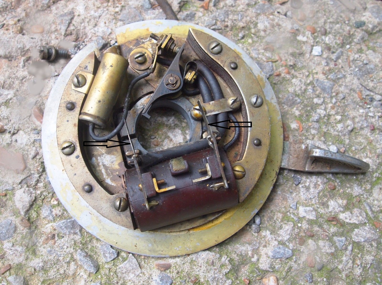

      The two "spring steel" grounding tabs on the coil of the DT-38 I’m
      working on are half gone. They’re like the ones in the photo
      of this LT-10 coil.
      What would be a good replacement material to make some?
      I’m not sure of the gauge yet.
      I was thinking of something like "feeler gauge" material.
      Any other ideas?
      Thanks!

          #65339
            I finally got around to measuring the tabs a while ago.
            They’re about 2" long, 7/32" wide, and .010 thick.
            I have not got around to tearing apart kitchen appliances
            yet to look for suitable material!
