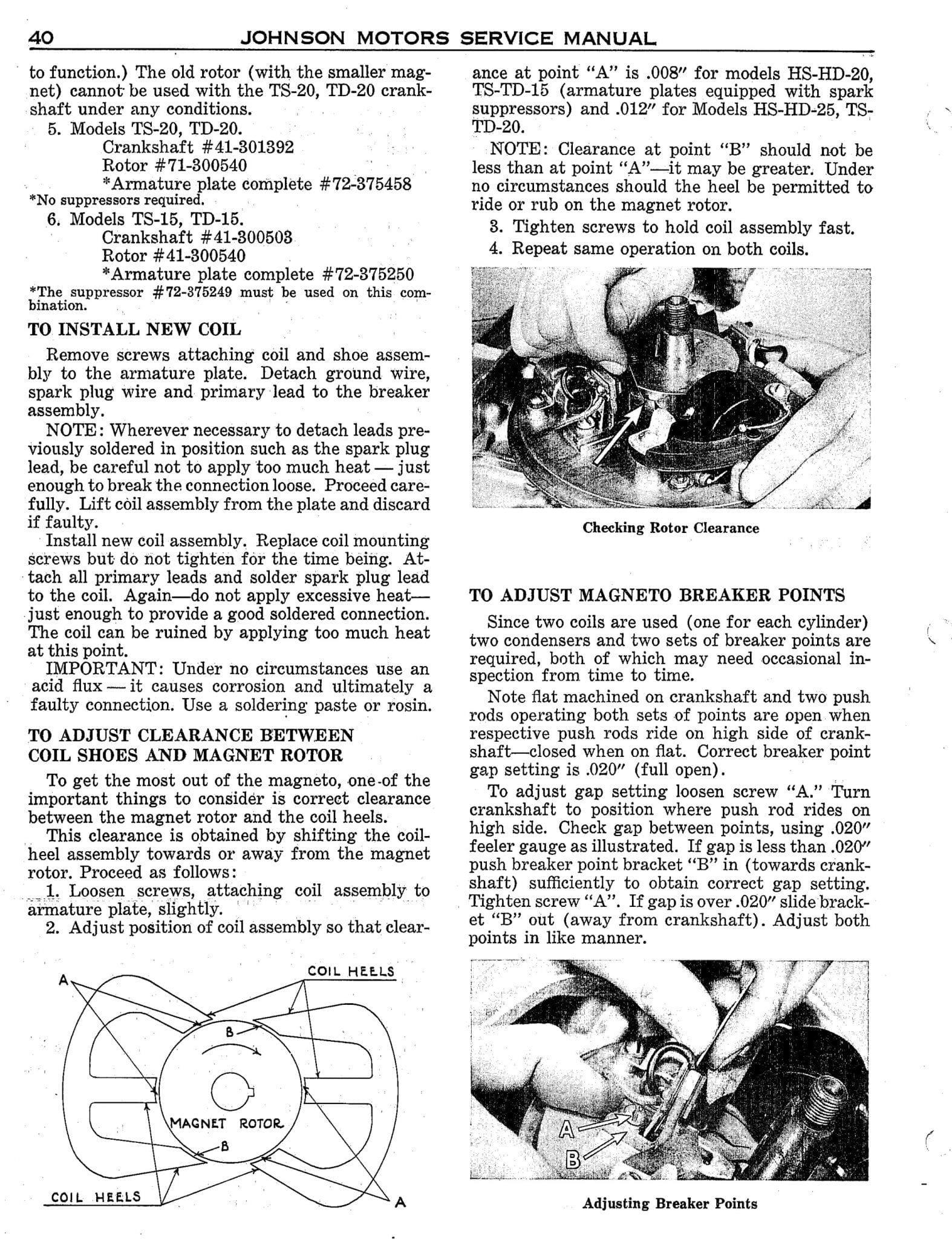

      The 1946 to 1950 Johnson 2.5 HP has the magnet for the magneto in the center around of the crankshaft and not on the flywheel. Is there a trick or special procedure for setting the ignition points?
      #188412
        HD-25
        Basically, just points to .020″ gap
        #188472
          see url for red book bible on oldies select book stack select JOHNSON then select RED BOOK
          print what you need to PDF files
          #188494
            If you have removed the points to clean them, make sure the rounded end of the plunger rod goes towards the points and the flat end is towards the crankshaft.
