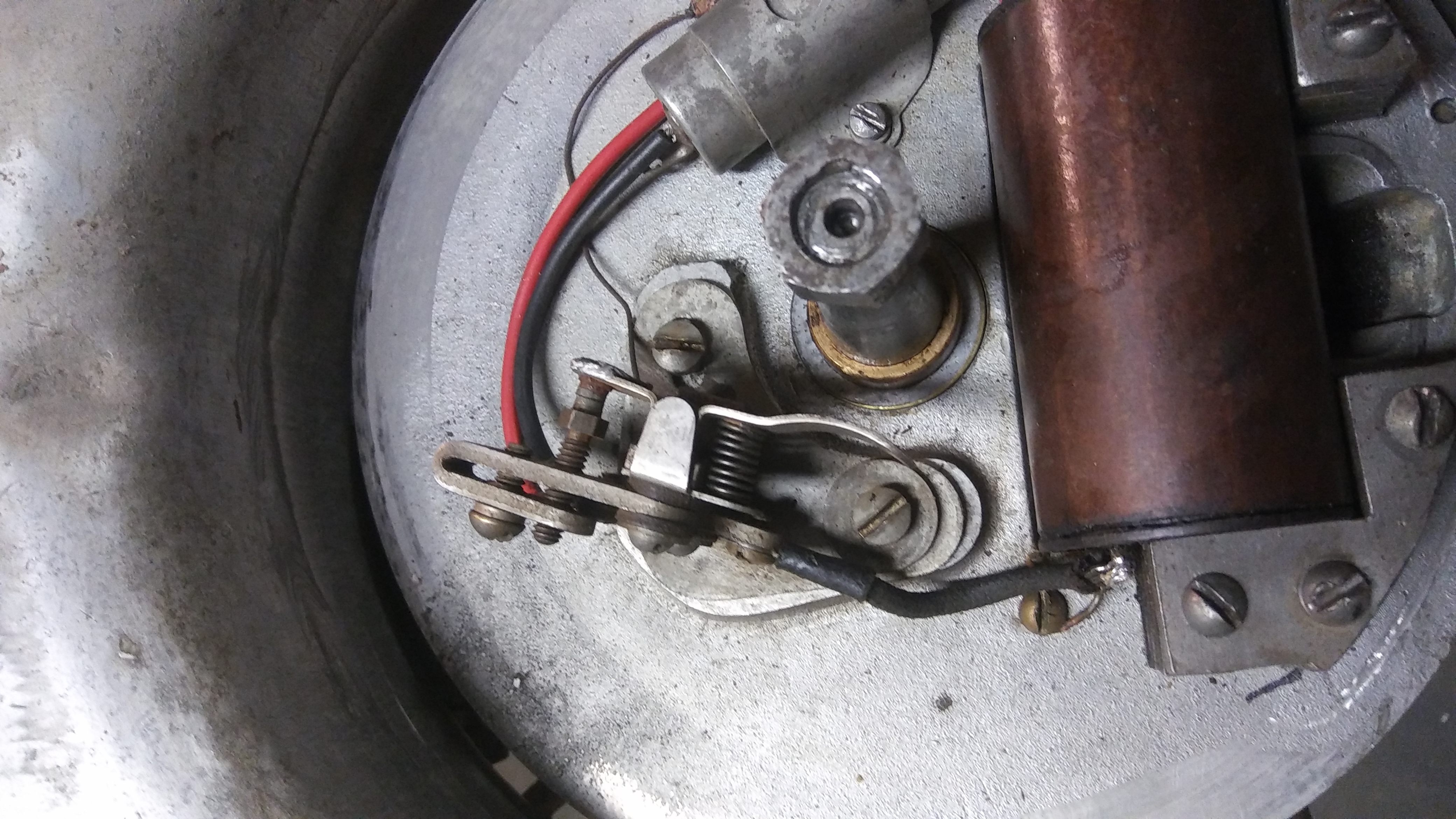

        eltoquad
          As shown in photo the fiber block mounted in flywheel contacts the metal arm on points.
          #58583
          bluehaze
            Thanks. Those photos do help. That looks exactly like the Model 110 set up.
            I didn’t notice the fiber block on the flywheel. I’ll have to take another look at mine.
            This is the first time I’ve seen points like these.
            #58603
            jcrigan
              The points are adjustable at the points. You should not need to loosen any screws to set them. If you do it will make it more difficult to reset them and could effect your timing.
