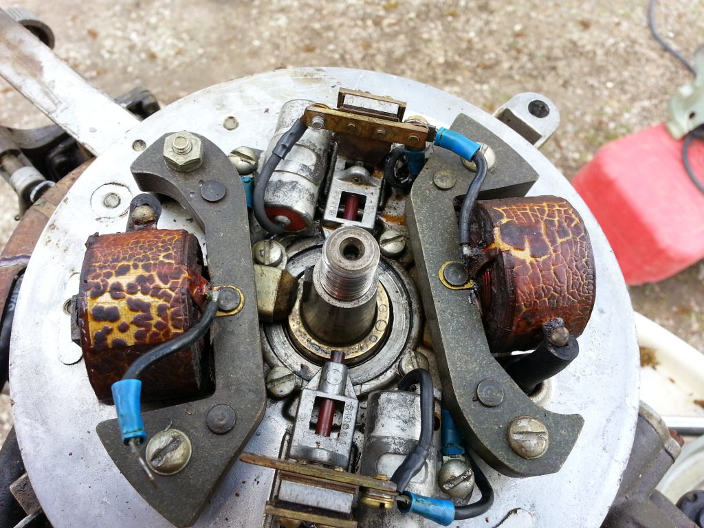

      Can you take a universal magneto and put it on an older qd that doesn’t have the universal? I have the opportunity to get an older qd but I’m sure the coils are shot as it looks like black melted tar has run everywhere. Thanks.

          QD11-magneto-with-original-coils
          Here’s photos of a QD-11 with originals and update newer coils.

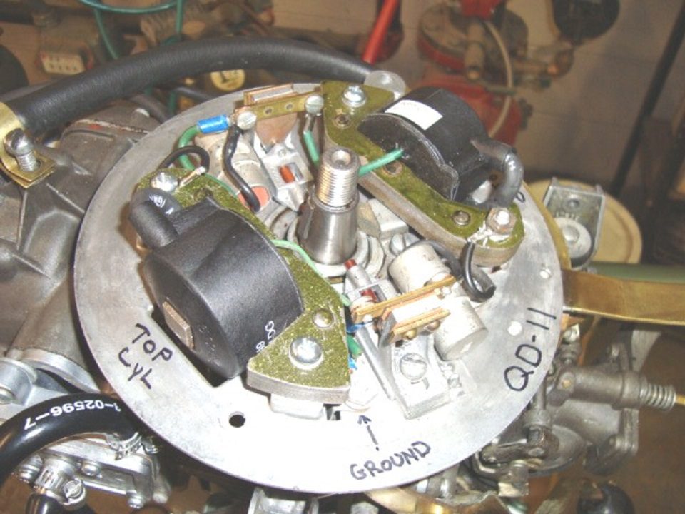

          QD11-magneto-updated-with-newer-coils
          #294259
          JOSEPH BRINCAT
            Bucc, it is known that you come up with creative solutions to unique problems, but I think that this is the first that I know of where the entire coil with armature got substituted. Normal fix would have been try to fit new OMC coils to the old armatures.
            How did it work out? get spark?
            Joe B
            #294261
              Joe, those photos are ones that I “filed away”, not my project.
              I did convert one of those early QD’s, but as you say, I put
              OMC universal coils on the old lams, from what I remember.
              For unknown reasons, I have no photos of mine, but
              do remember it was “tricky”……… I think I had issues with
              the plug wire routing perhaps.
