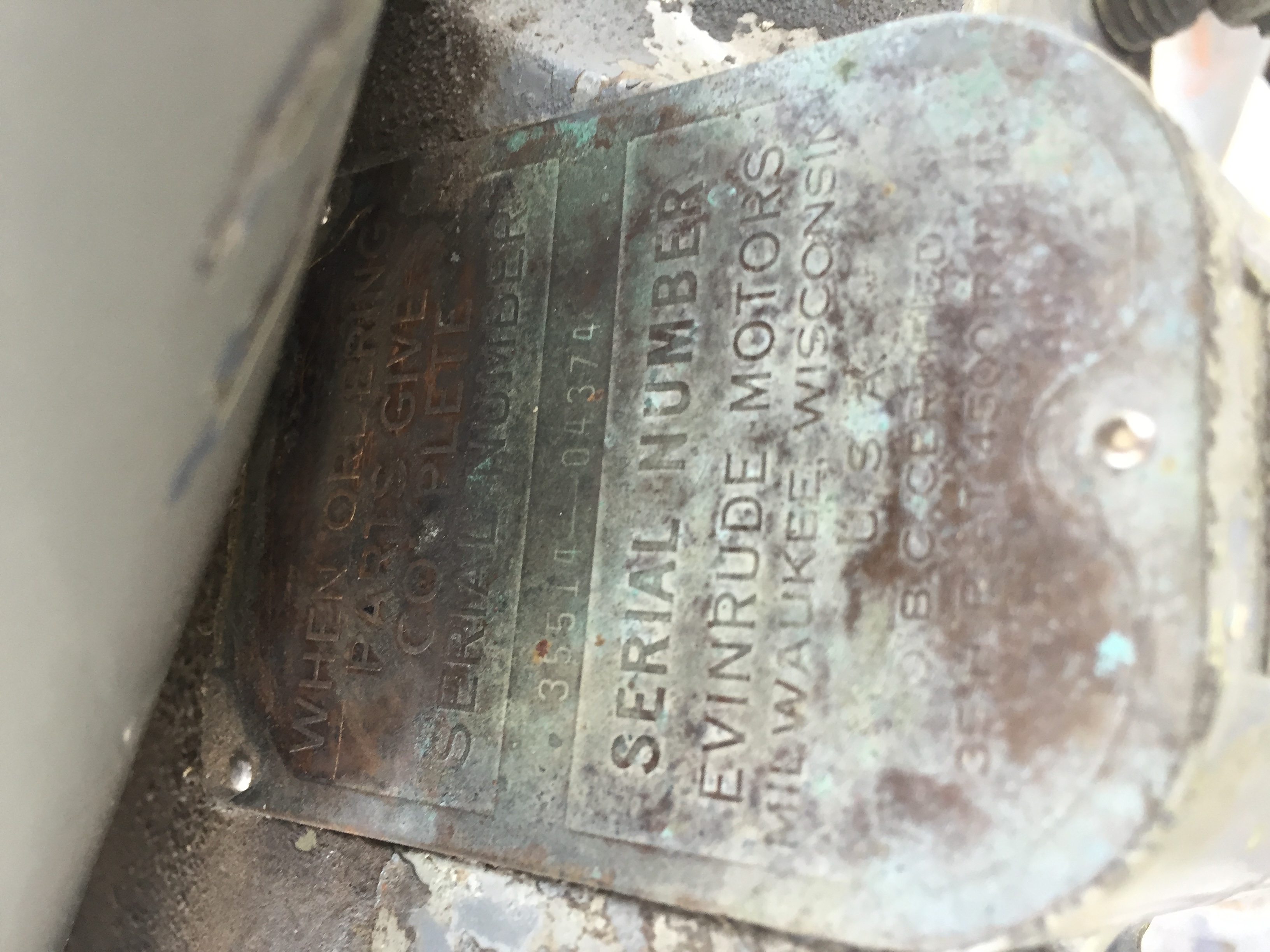

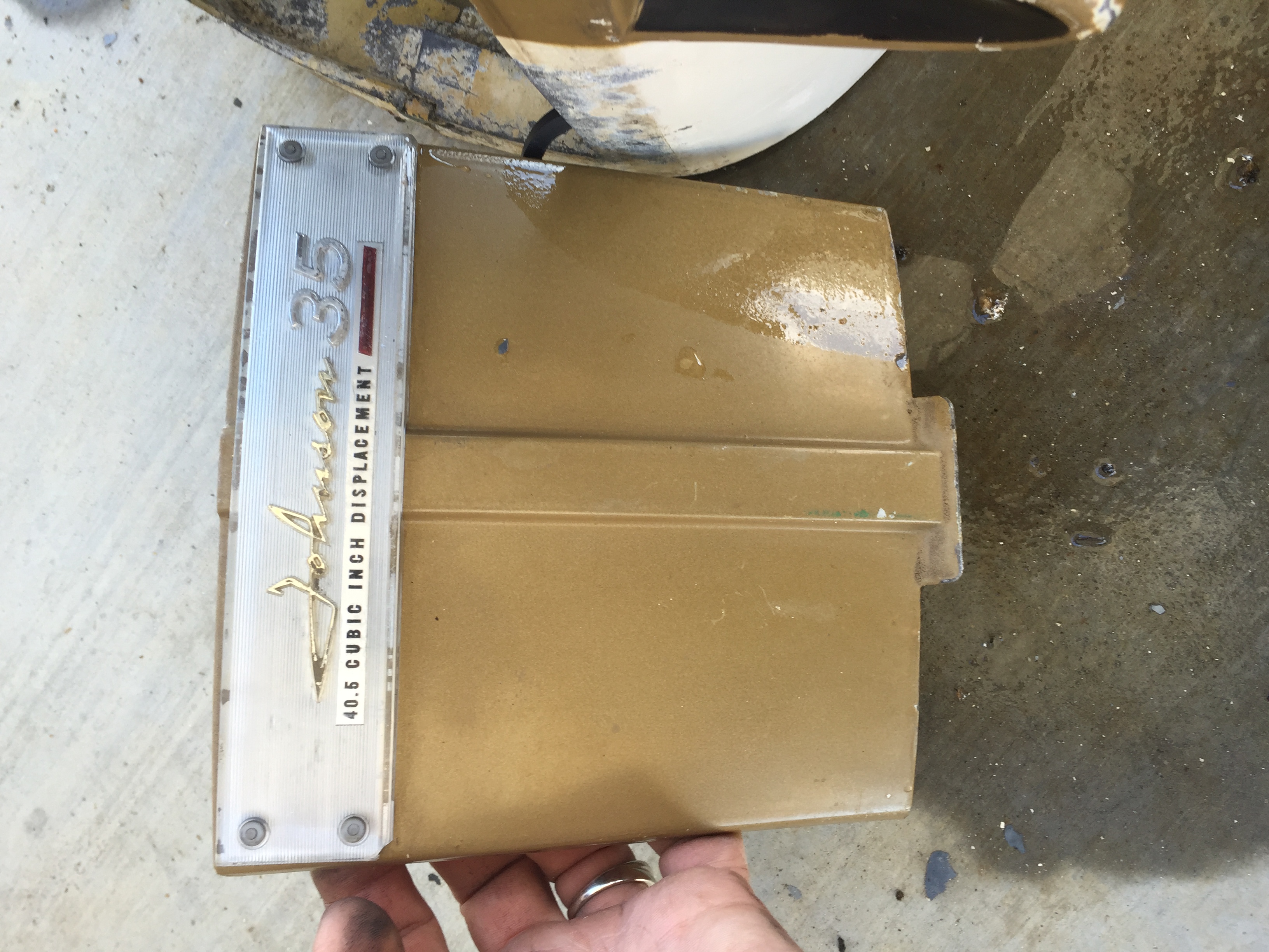

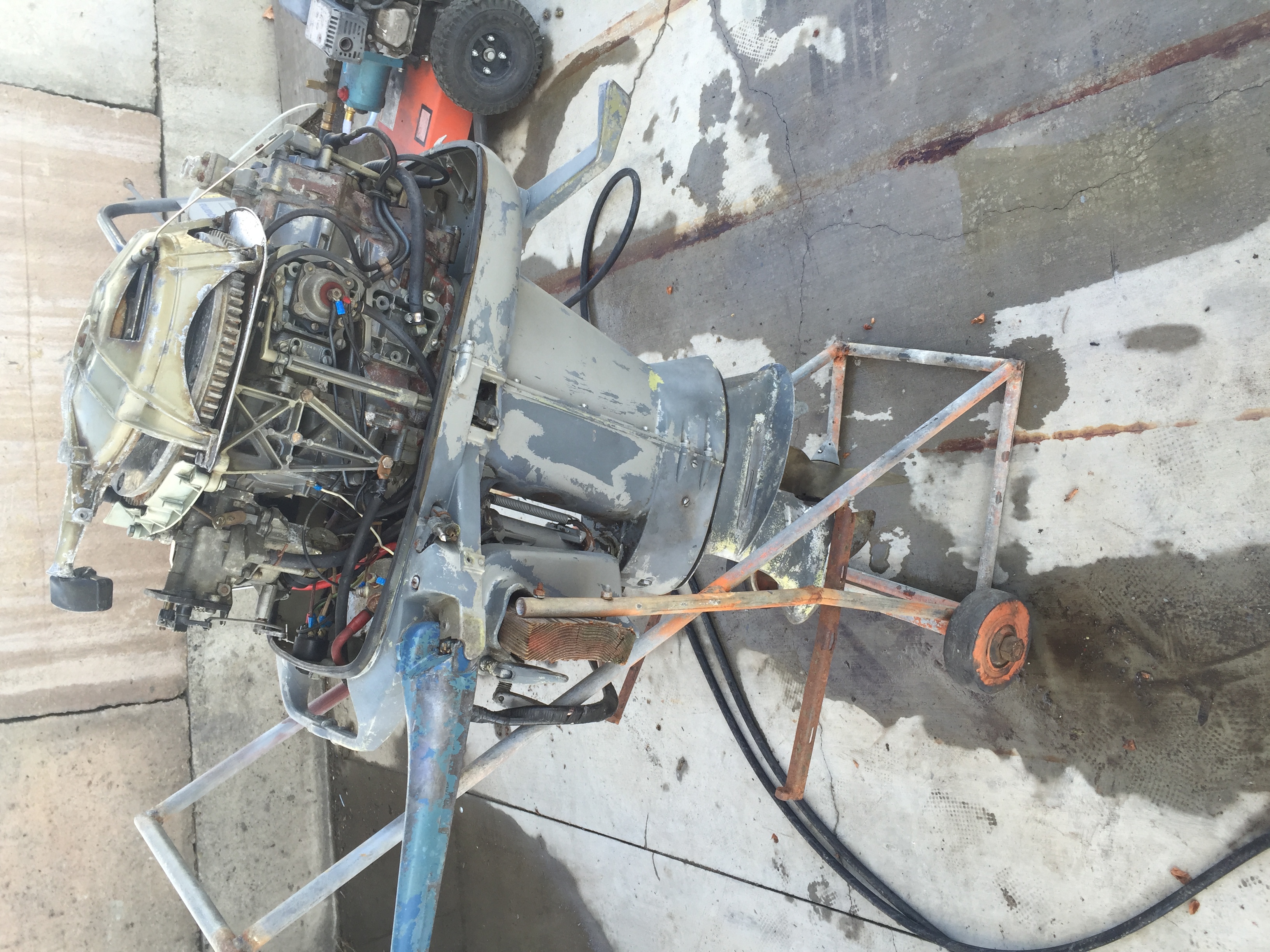

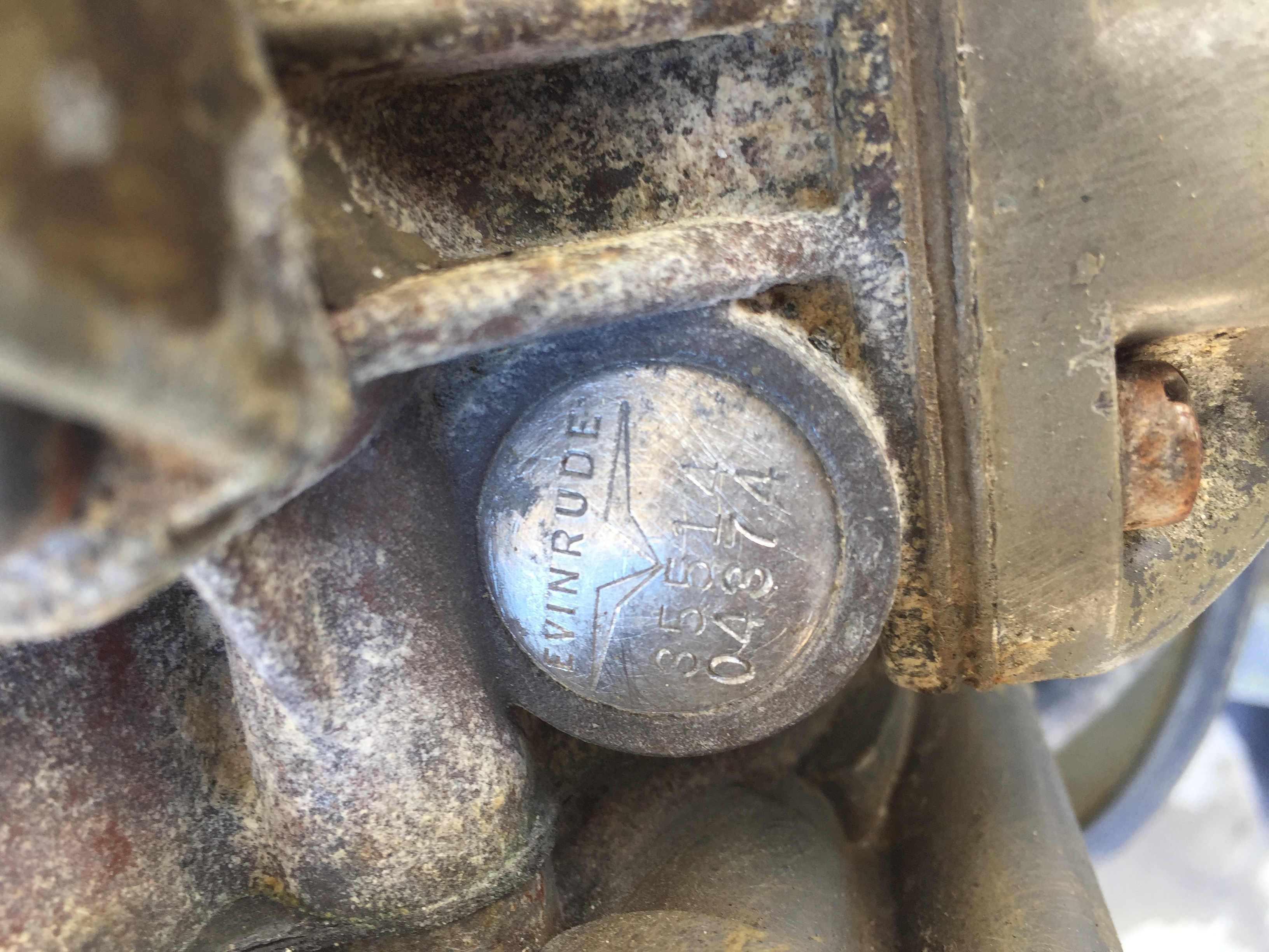

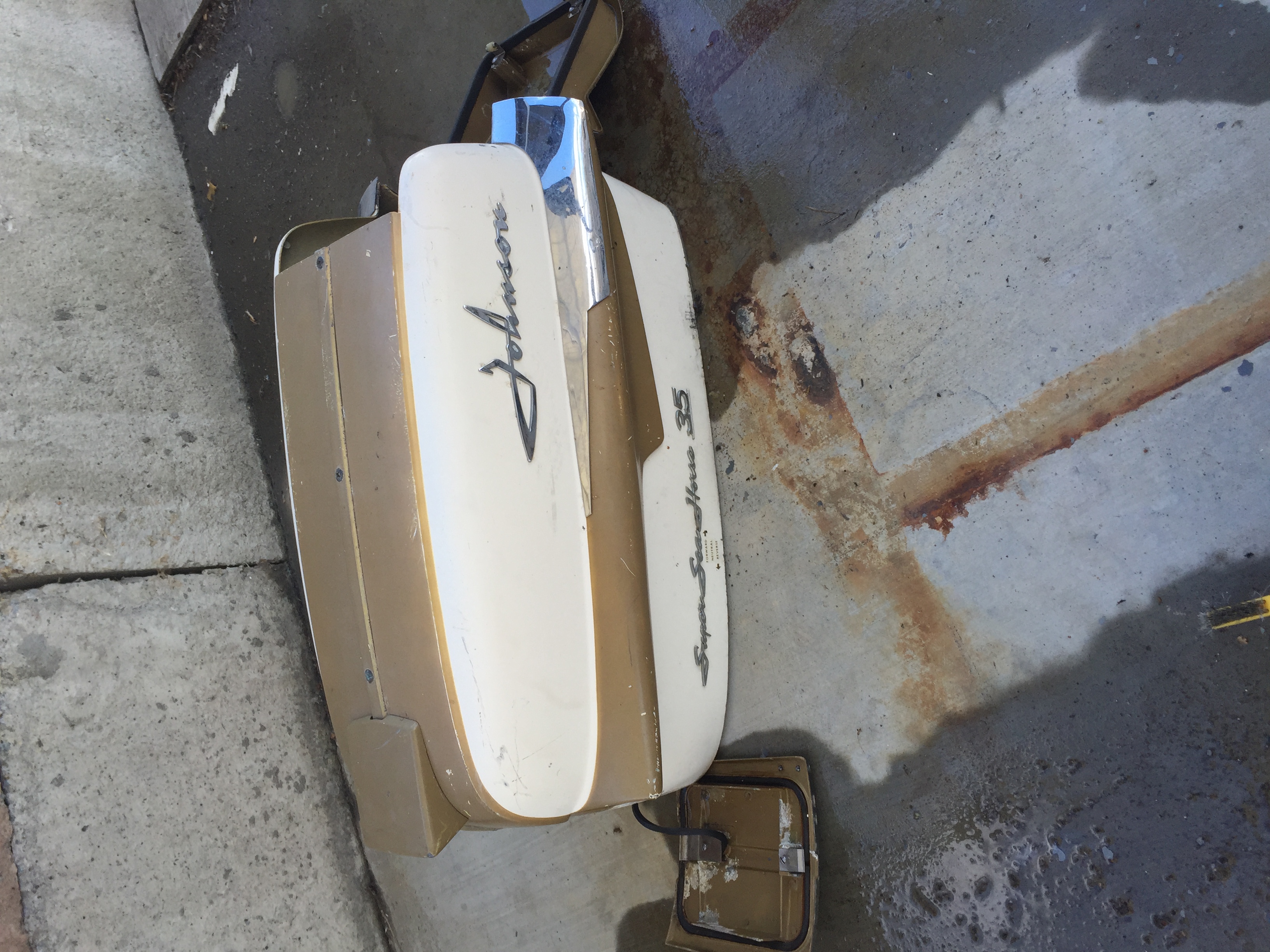

      I bought this motor last night, washed it today and need help getting more info. So the hood says Super Seahorse and is aluminum which makes me think its a ’58. But I cant find a model anywhere here are the plates/tags I found.
      #44335
      chris-p
        What you have there is a 1958 Evinrude Lark 35hp with a 1958 35hp Johnson Super Seahorse Cowl.

          #44345
            Same exact motor, different hoods.
            #44348
            Casey Lynn
              RDS-20 and a great engine to have and run.
              Correction! Chris is absolutely correct. ‘Tis an Evinrude with an RDS-20 hood.
