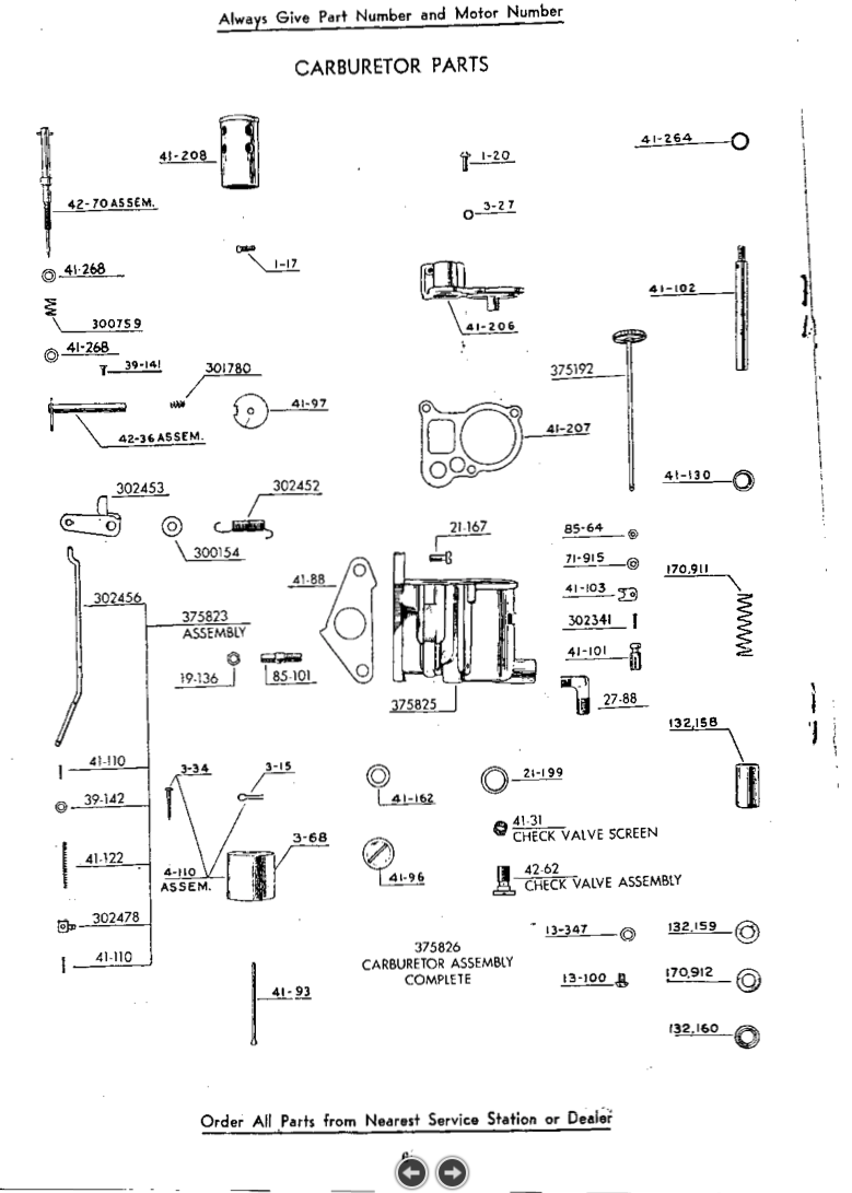

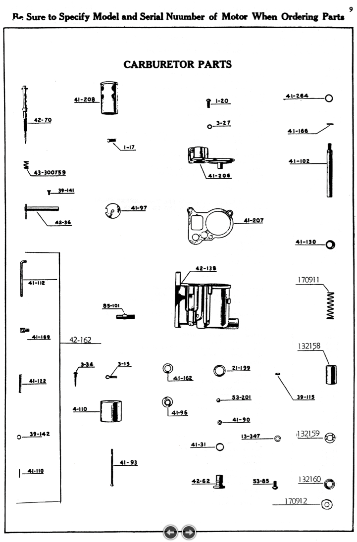

      The carbs from the TN 26 and 28 look identical to me. Can anybody verify that they are in fact exactly the same?

        From there Johnson parts books on my DropBox site . . . 😀

          As far as I know, that same Carburetor was used by Johnson from the 1941/1942 TS/TD-15 model (possibly earlier), through the TS/TD-20 model, and through the TN series.

            Thanks guys, that appears to be dead simple. The TN carb is on the TN series motor, and the TD carb is on the TD motors.
