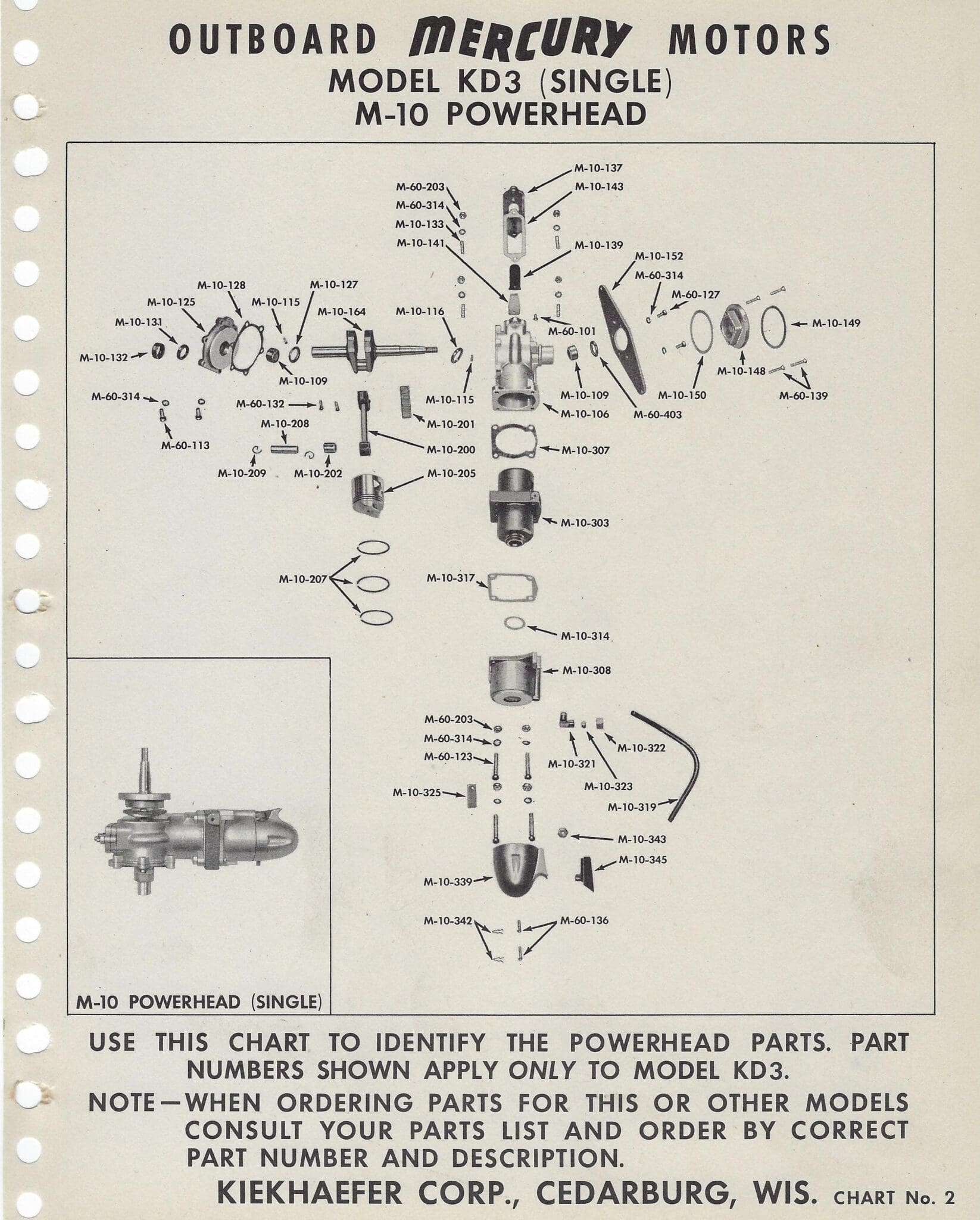

              #292516
              fifty20ne
                1941 Comet is pre – War
                1946 KD-3 Post War
                comet6
                comet7
                Chart2
