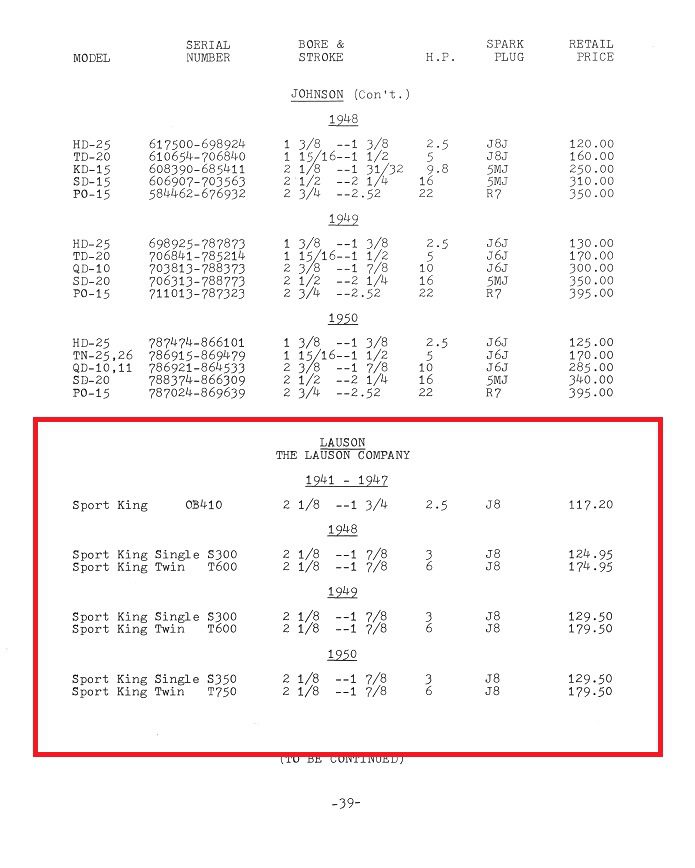

          Click on link
          https://www.aomci.org/forums/topic/lauson-motor/
          #287773
            Lauson-Models
