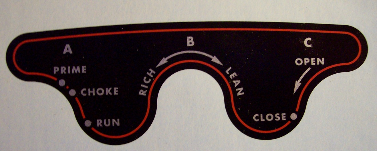

Be careful with that decal…it’s the worst most difficult one to apply. Because it has a compound curve, you have to do several things to prepare it. Lay it flat and mist-coat it with several ultra-thin coats of lacquer. When it’s dry warm the water slightly above room temperature as well as the cowl….you want the decal to bend accordingly and stretch so there are few wrinkles. If you use a razor blade on the edges you can eliminate small wrinkles but it’s difficult…good luck, take your time.
