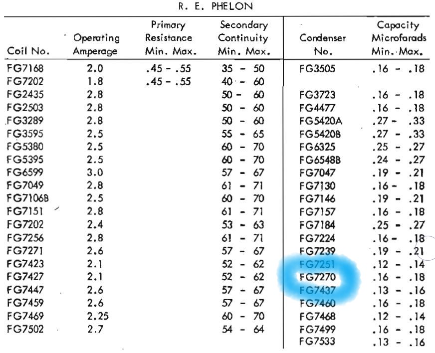

        http://johnsoldmercurysite.com/whitepapers/mercotronic/files/assets/downloads/page0157.pdf
        I found this site that gives the ranges for each condenser. I couldn’t find the 7270 but the 7157 was the same range and looks the same

          Lower right.

            Gotcha
