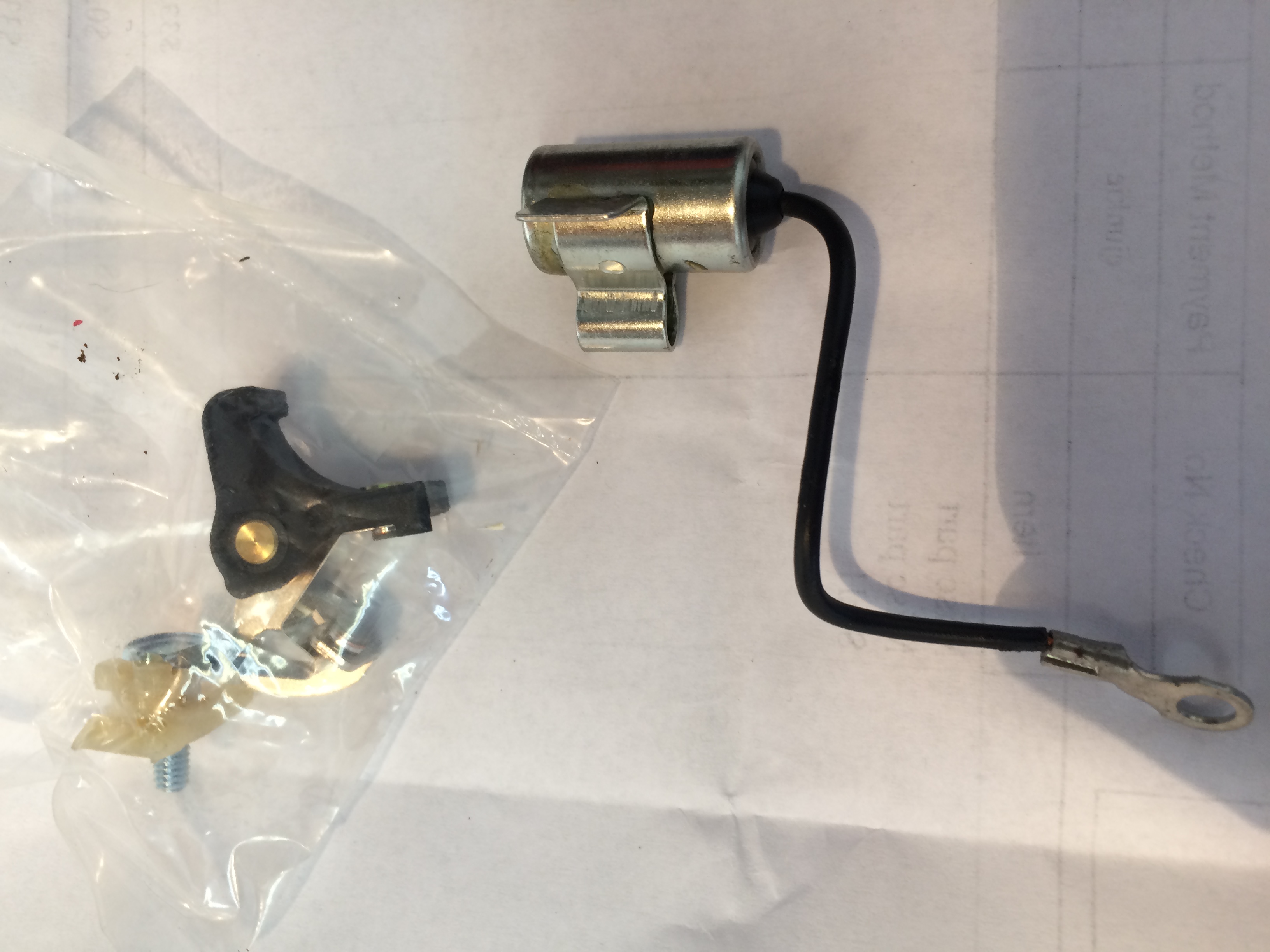

      I get the new condensor and points in. The points contact area are much larger than original which I guess is a good thing.

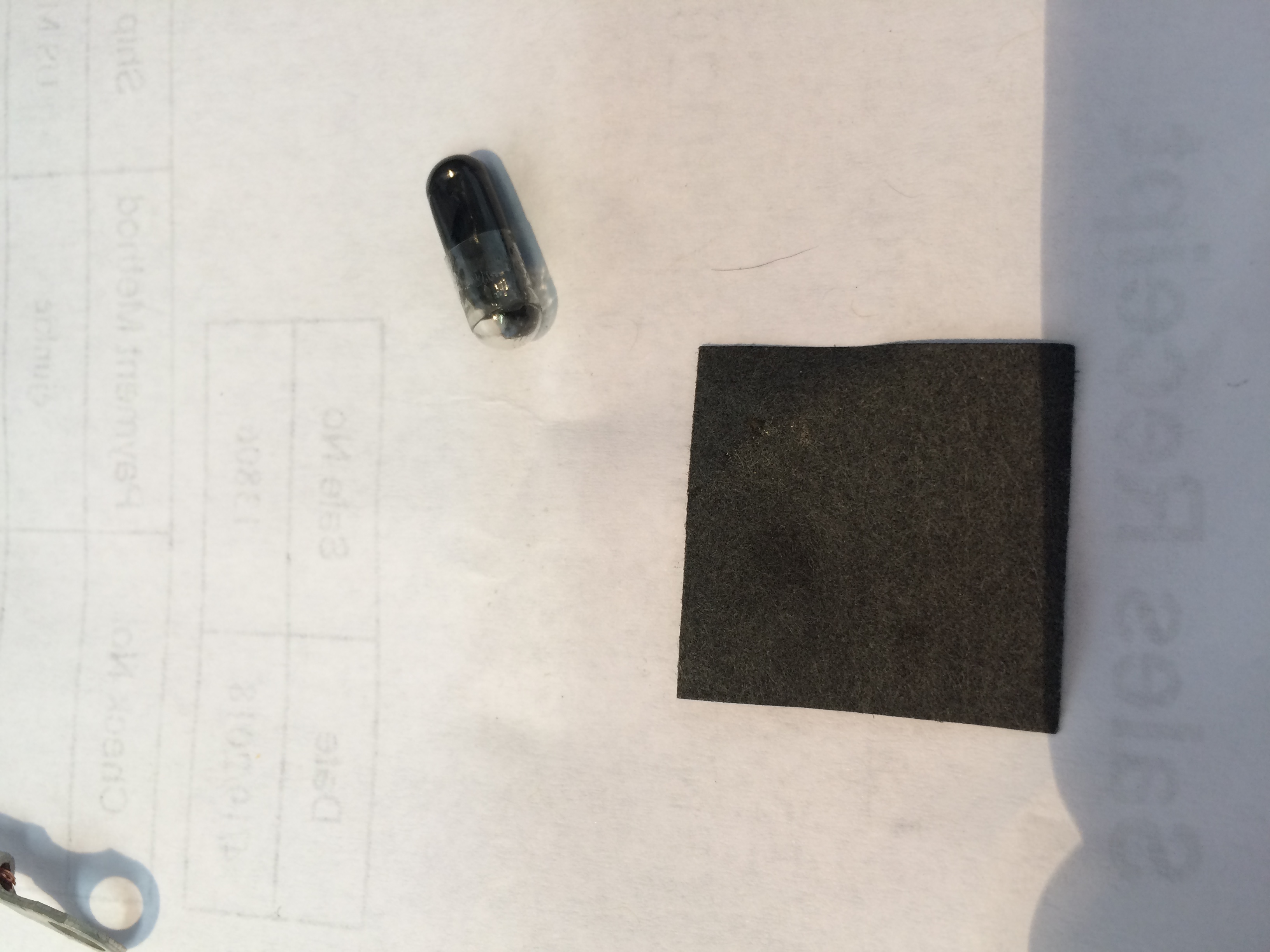

      My question is why was I sent a capsule with what looks like grease and a piece of polishing paper?
      #74541
        The grease would be to put a little bit on the points cam.
        Not sure about the paper……. maybe to polish the points?

          I figured it out once I posted that and then found out the new spark plug I bought is crap compared to the 30 yr plug that came with it. Going to clean up threads and install here shortly and let er rip.
