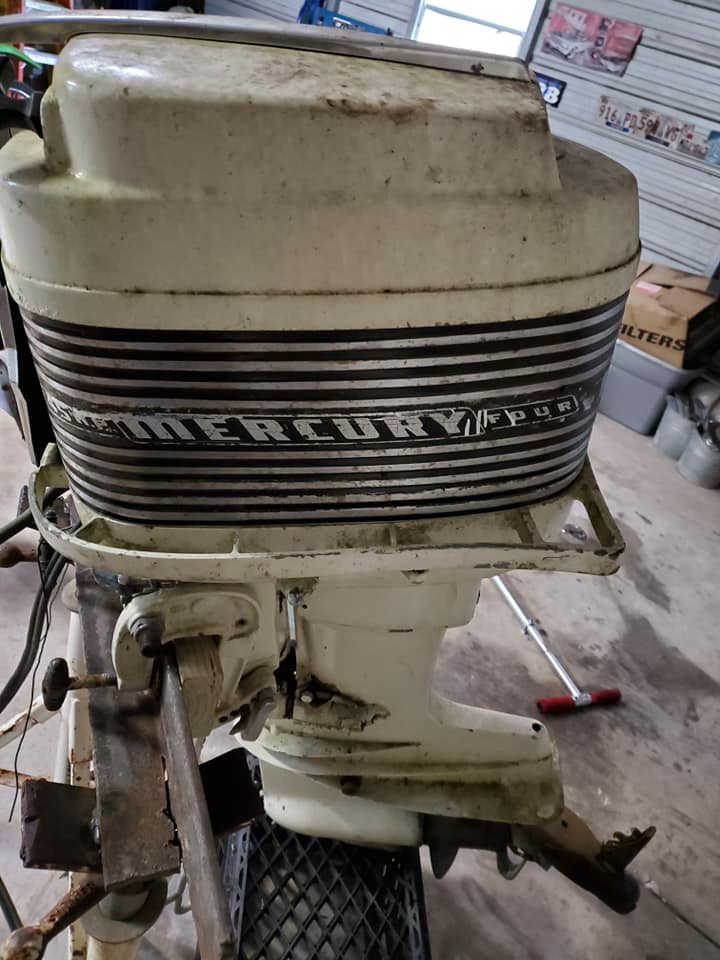

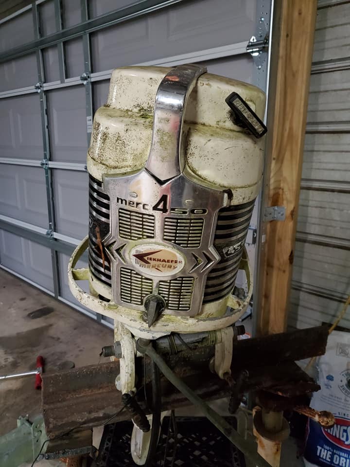

      Does anyone know by looking at the pics what year this might be ? And any info in general about it .
      Think I may go check it out .. What should compression be ? Thanks …

          Here’s a photo of it.

            I may have found it 1962? https://endlessboating.com/forums/media/1962-mercury-outboard-brochure-page-12.1176/
            Wow that’s a really clean scan of a 1962 Mercury Brochure.

              Is there any reason to steer clear of these old Mercs ?
              Are parts still available ?
              #189649
                They are a great motor.
                #189668
                David Stanton
                  I think their 4 cylinder models back then were arguably the best in their lineup. the main downside I know of is that you need earplugs to run them – OMCs back then were much quieter.
                  #189672
                    I would check the compression….I would like to see 115 or better in each hole. If one or more cylinders is found to be noticeably less than the others, it will need a tear down. Anything is possible but you may find it frustrating if you’re used to OMCs.
                    #189674
                    Samuel Phelps
                      What if it was run in salt ?
                      Idk if it was but it is in Florida …
                      #189682
                        Yeah, if it was run in salt, it is an anchor.
