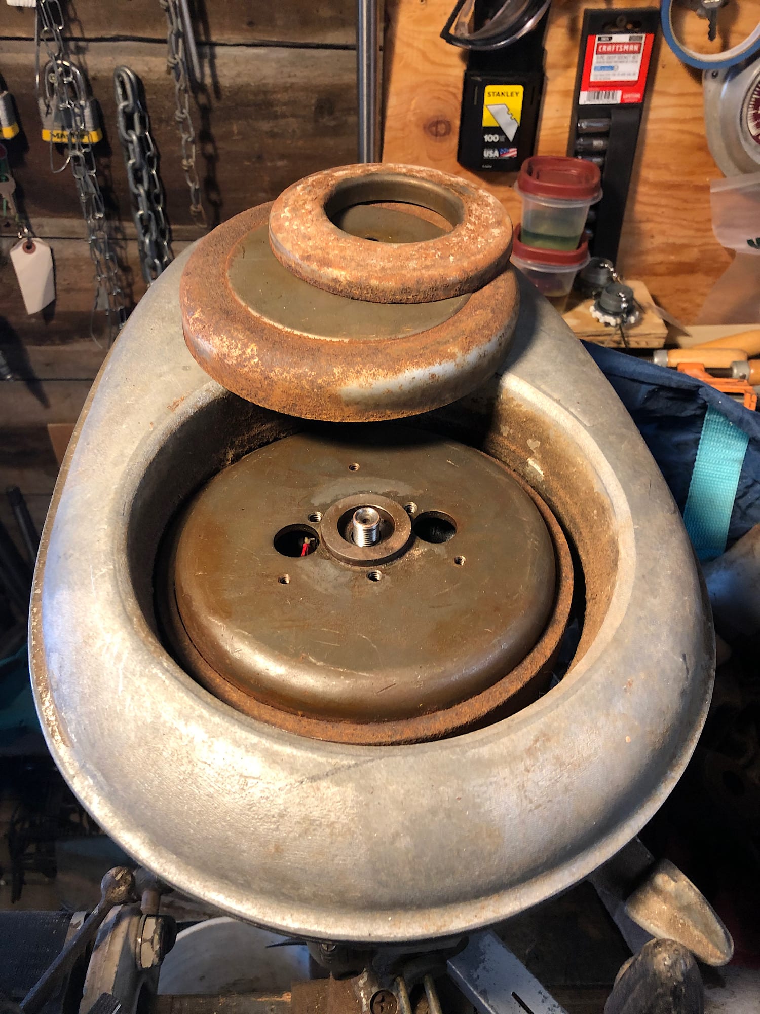

          Another question. When I torque down the nut on the rope pull it still has play . What am I missing? And what are the six holes for?

            Boonie
              Is there back and forth play when you put the rope on?
              #233321
              Timothy McDonald
                three inside screw threaded holes are for the bearing puller or the three sided plate puller.
                #233322
                opposedtwin
                  No sir. Tight. But I don’t know for sure if you’re missing parts or not. You hsve the raised letter rope sheave. Mine is smooth on top and bottom.
                  Others will know how to explain the difference.

                  #233334
                  Boonie
                    Maybe someone can show me a picture of the parts. This is what I have.

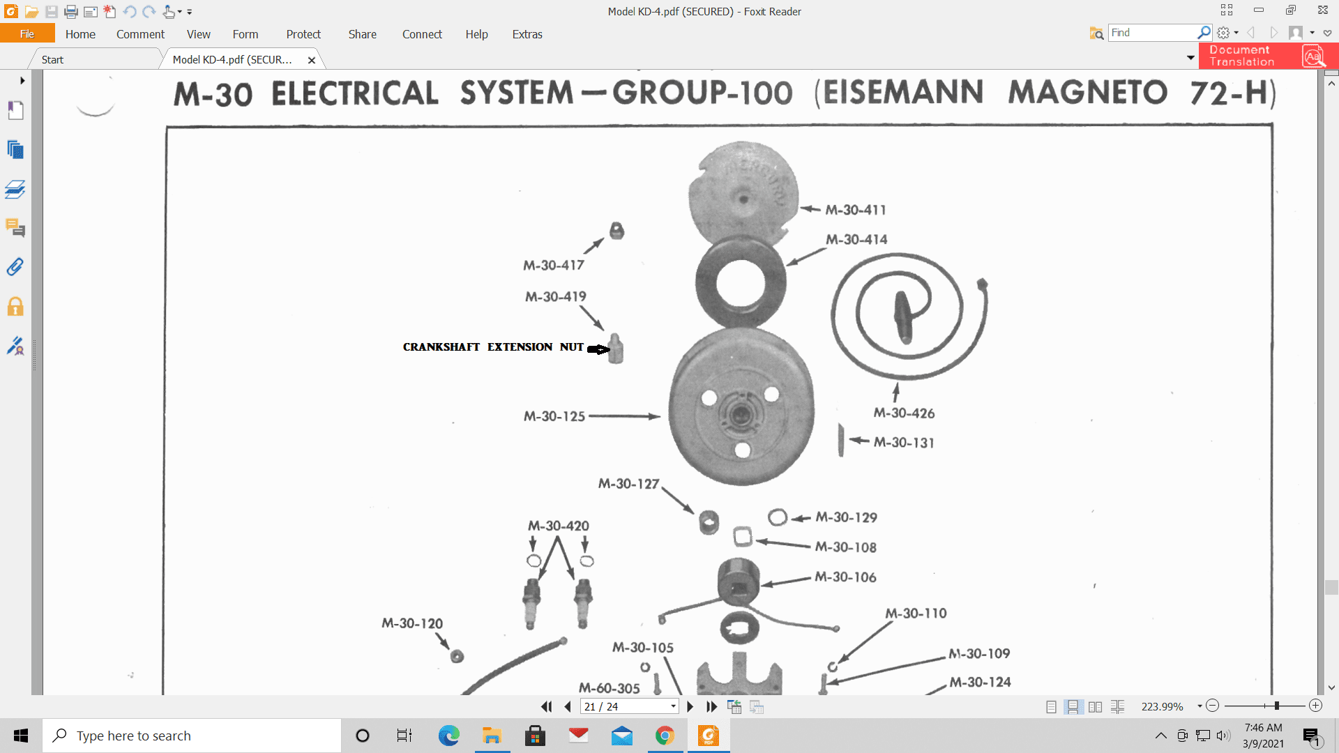

                      The Eismann version shows a crankshaft extension nut.
                      kd4-flywheel

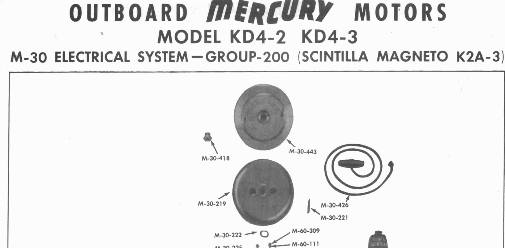

                        Looks like you have the Scintilla version……
                        kd4-scintilla-flywheel
