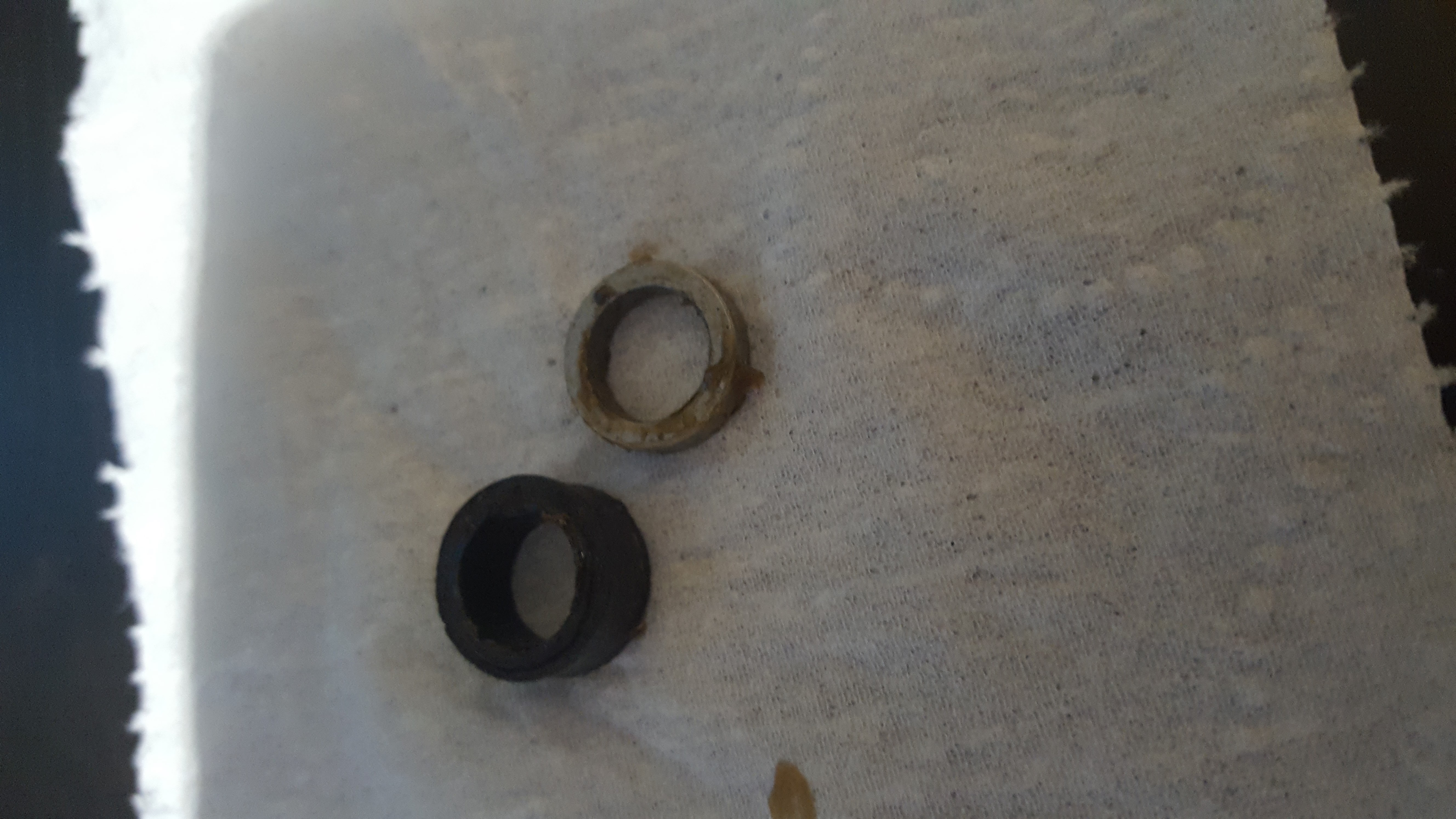

        yes it is a rubber tube and a special washer not a seal as you know it also check down in the hole for a welsh plug if it is damaged replace it for it wont pump water to the power head.

        cheetahgod
          Okay I found theese two still on the water pipe. Not sure what a welsh plug looks like.
          Thanks

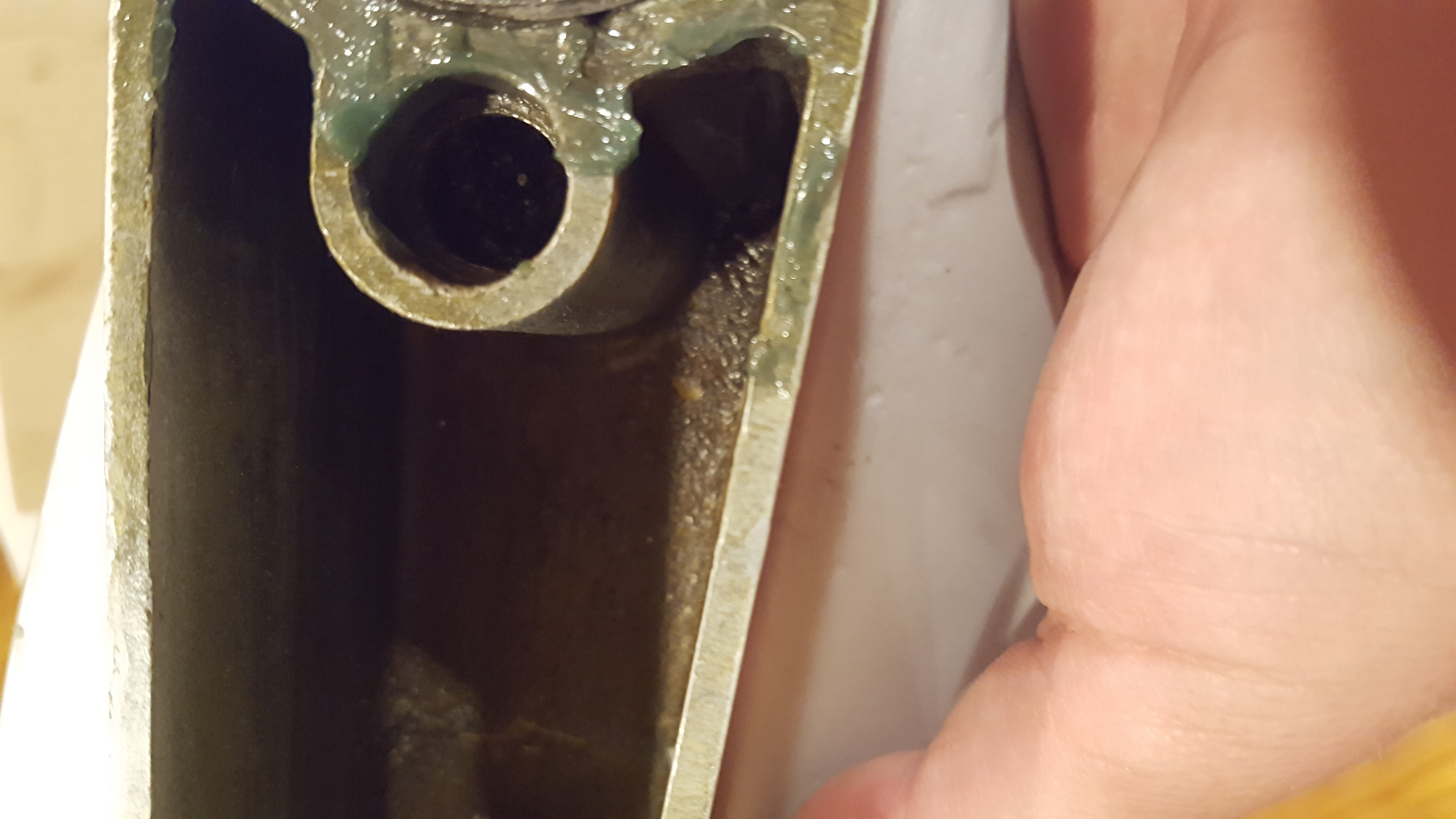

          cheetahgod
            I think I’m missing the welch plug
