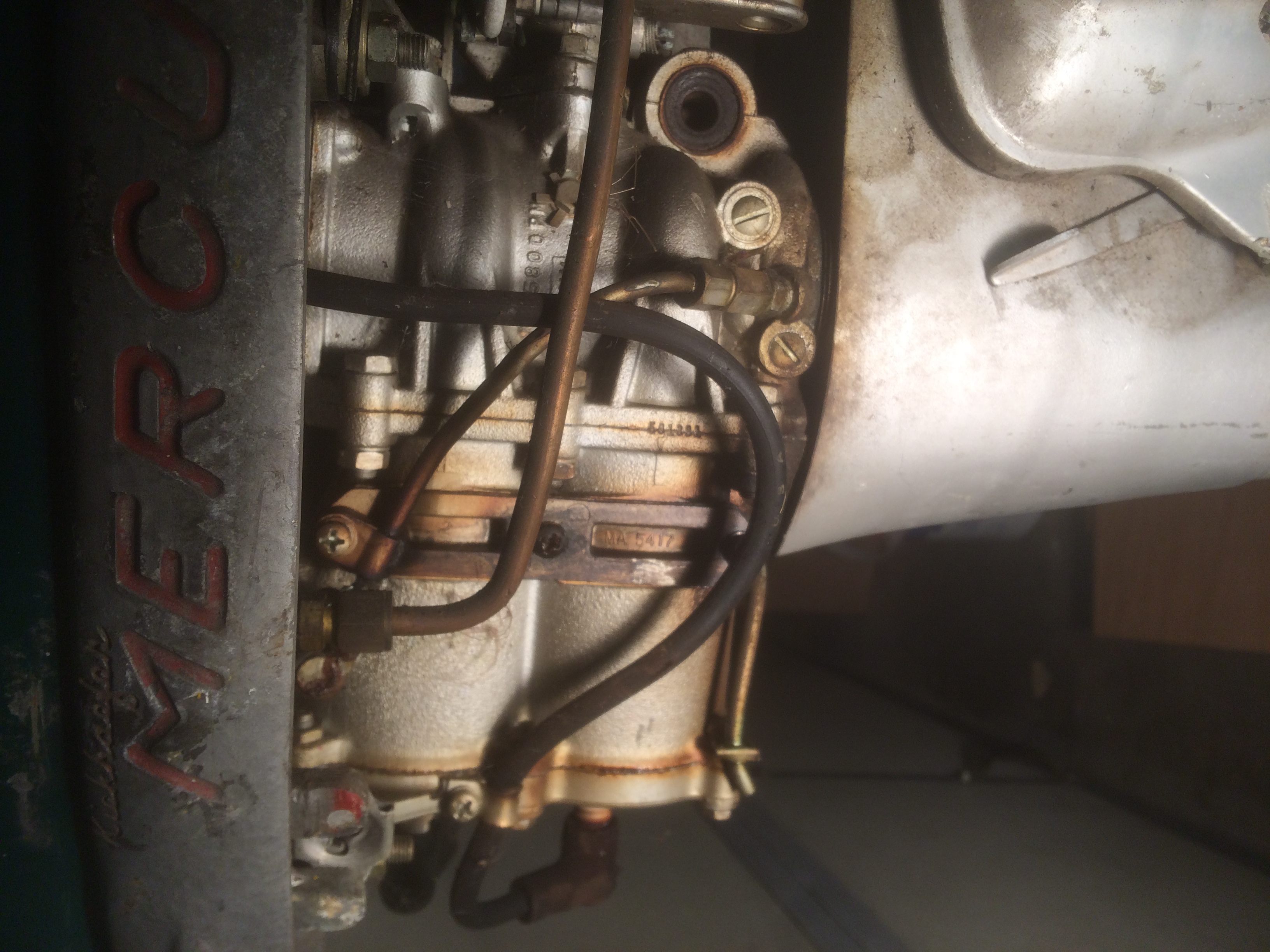

                #51773
                cheetahgod
                  Power head
