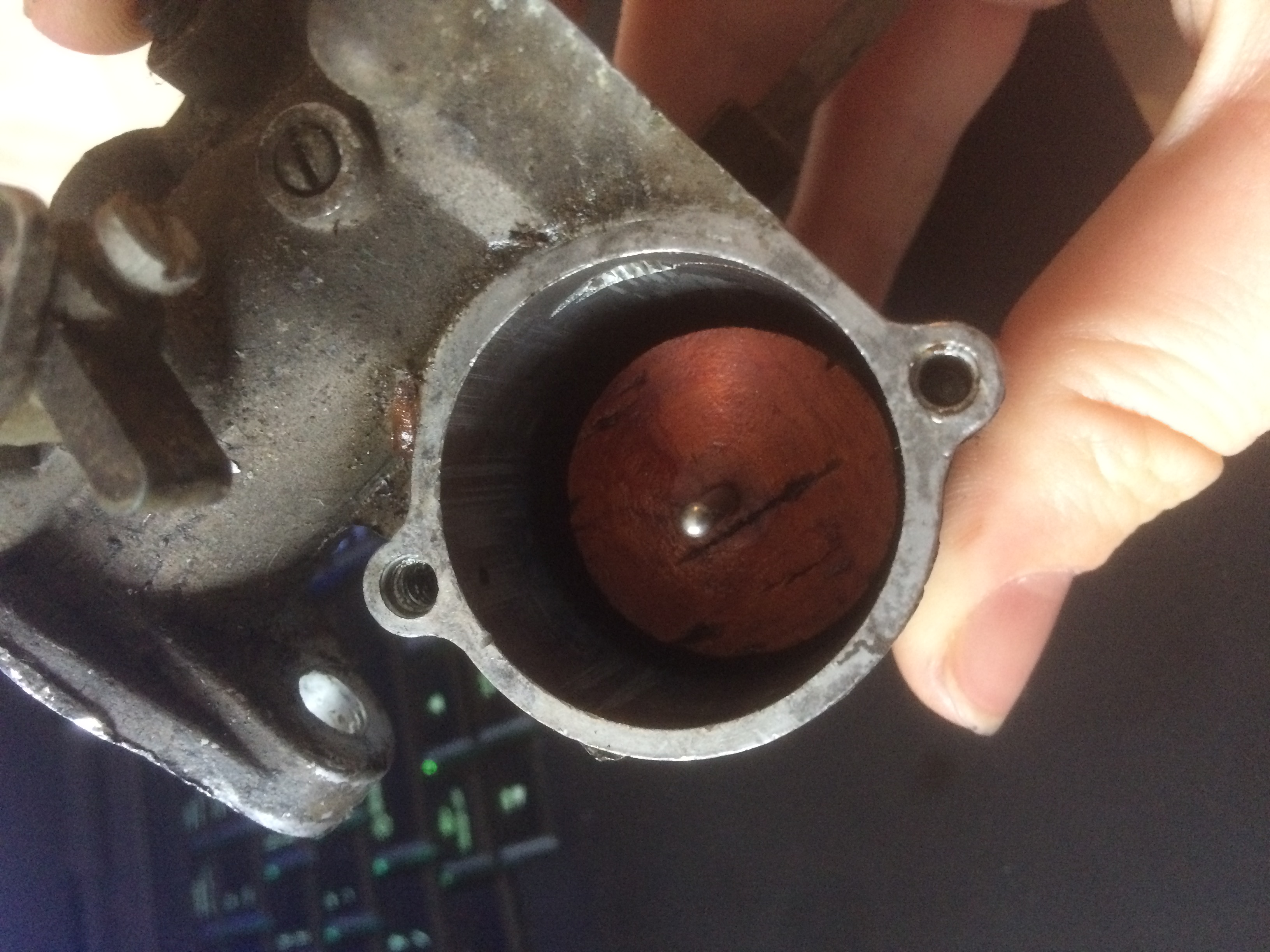

February 7, 2017 at 7:28 pm #52602February 7, 2017 at 9:05 pm #52610There is a screw in plug or sediment bowl at the bottom of the float bowl. Remove it and you can push the float pin down to the level of the float. This will give you room, when turned up side down, to grasp the float and pull it out. . . 😉
February 7, 2017 at 9:19 pm #52611Thanks I got it out. Does anyone know where I can get the service manual for a good price ?
