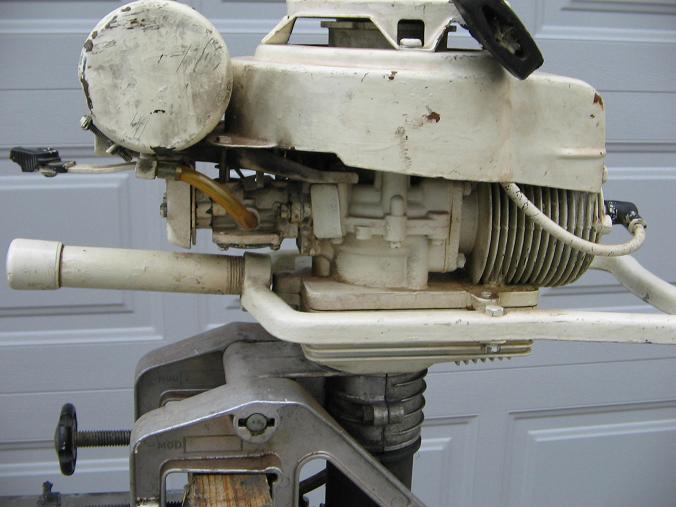

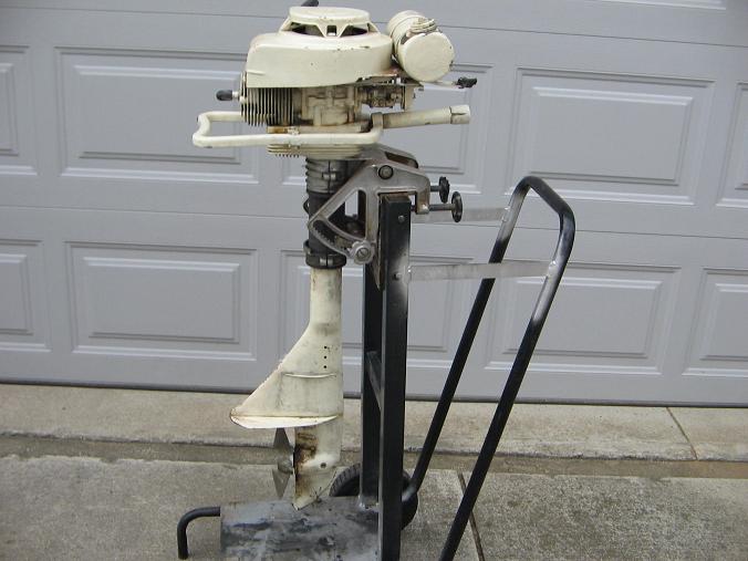

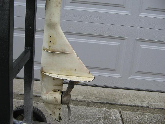

      Got this little motor the other day but I am unable to ID it.Motor itself says Tecumseh but there is no model or serial number.I have found a flywheel casting number 31332. Also there is a tag on the intake that reads 4417500.Just wondering if anyone may know the make or model or hp.Thanks you for looking. I am sending a few photos for you to look at. Thanks again Russ…

        I’m gonna say an Eska, perhaps a Golden Jet. ?
        #43745
        wedgie
          I’m gonna say an Eska, perhaps a Golden Jet. ? Looks like the transom clamp has been changed.
          #43746
            I don’t think it is an Eska. But I don’t know what it is either.
            #43748
            retiredoz
              It’s an Arrow, a minor Canadian aberration. Looks like the small one, 3-hp Tecumseh ph.
