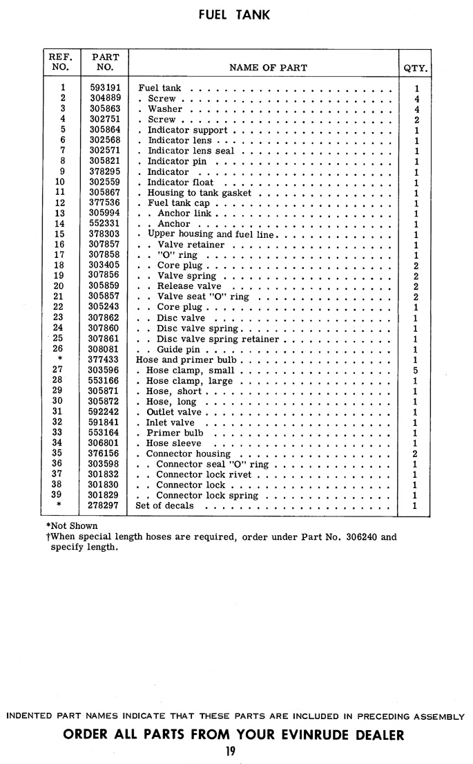

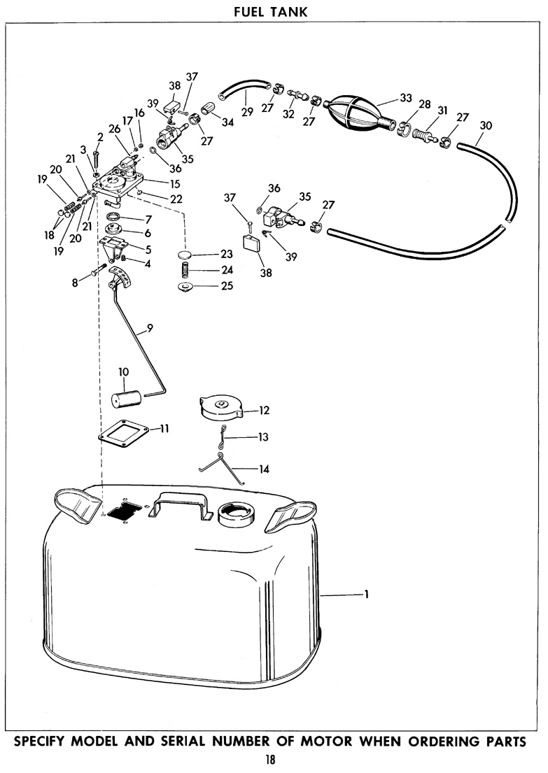

            #62568
              Here is the parts book . . . πŸ˜€

                  does anybody want O rings’ for dual connectors … guess i did not specify enough in my request
                  does anybody have the specs for the single line fuel connector O’ring # 303 598 ??
